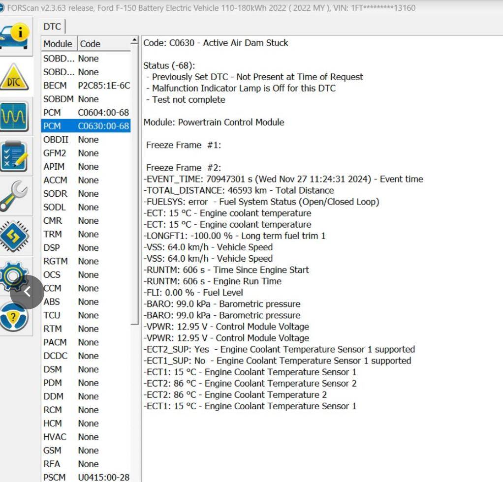

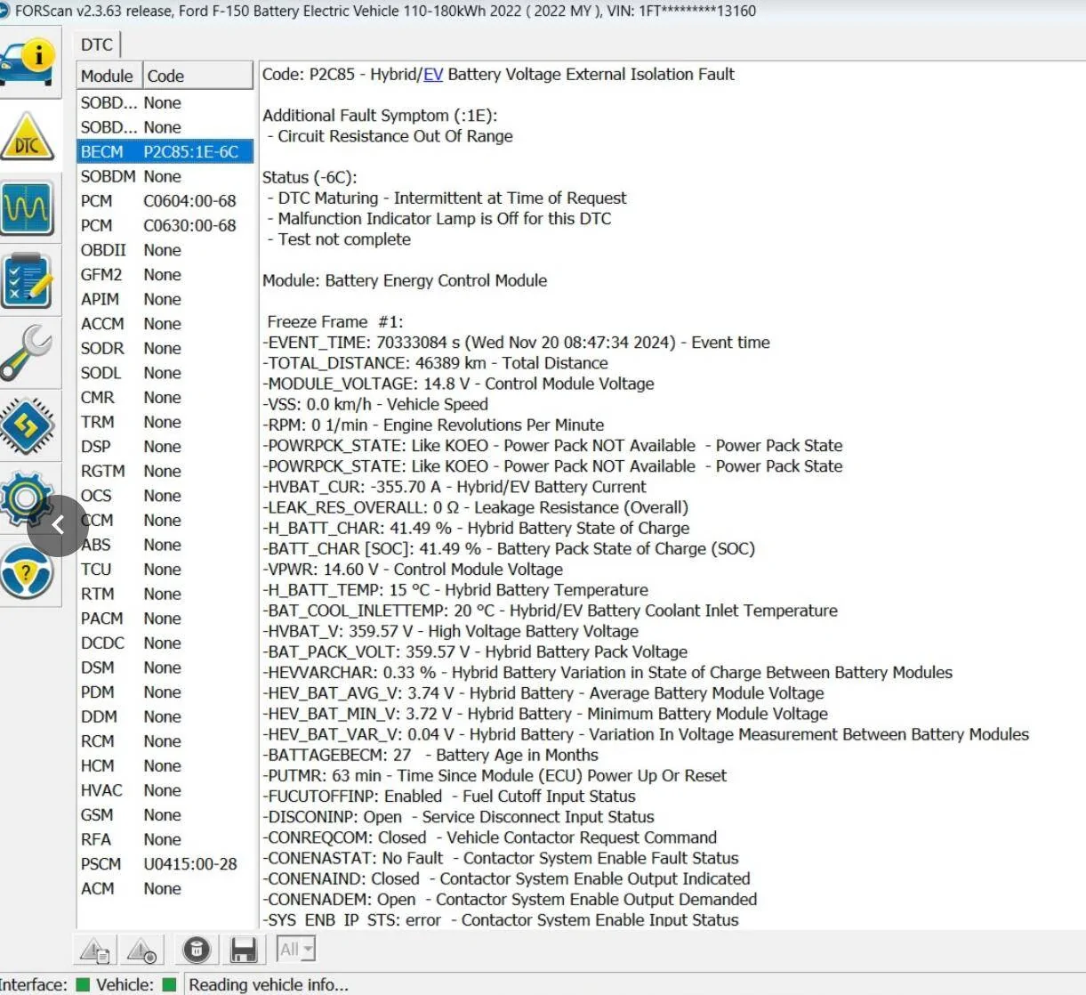

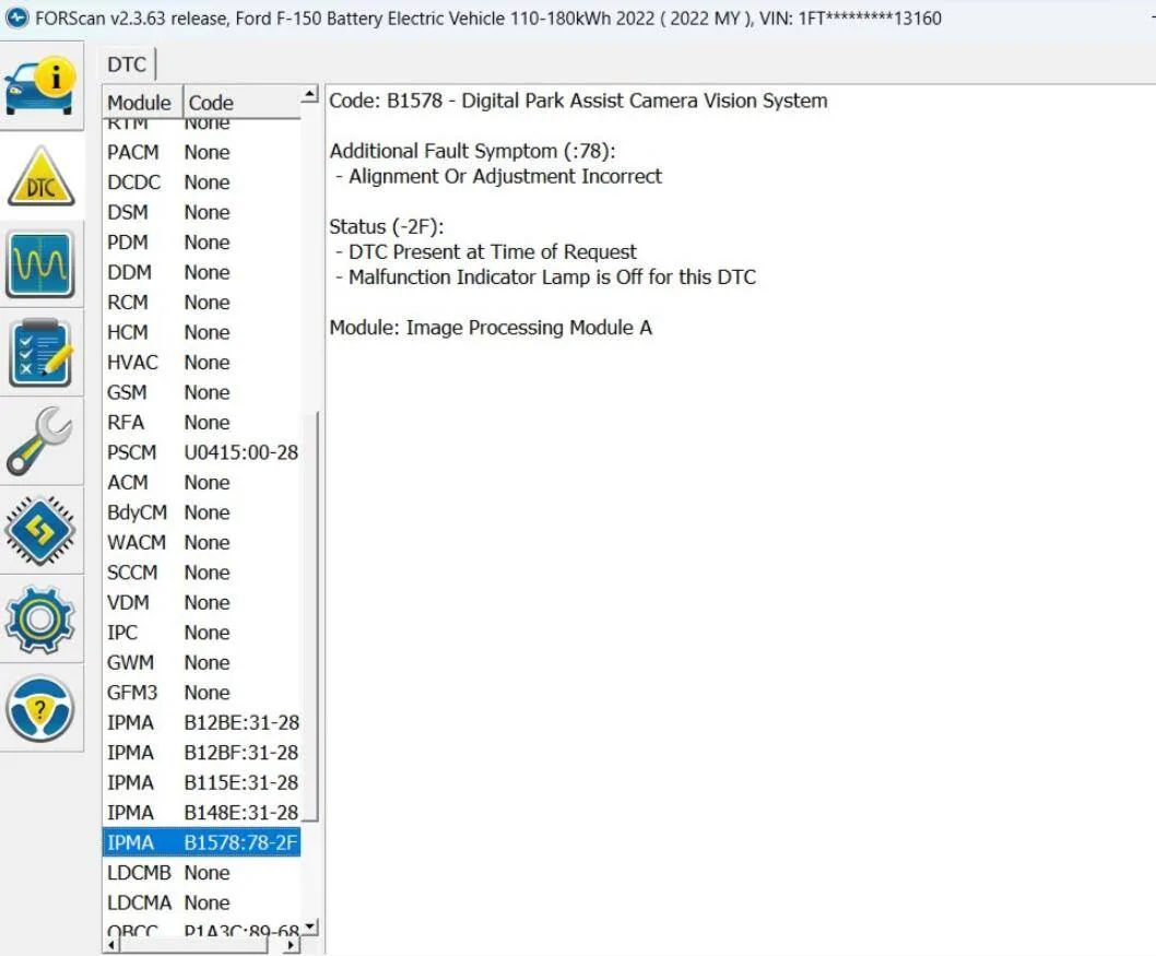

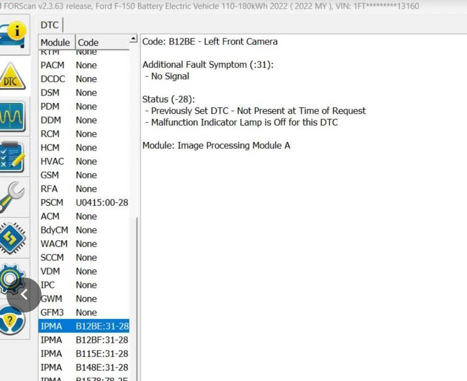

Last night poking around forscan and found this. Is this a huge concern? I know on other EVs an isolation fault is a huge deal. I also have issuse for ABS , air dam and other things.. Ill just drop them in here and see what you guys have to say. Thanks!
Main issue:
Ford F-150 Lightning P2c85 - Hybrid EV Battery Voltage External Isolation Fault Snag_540ebf31

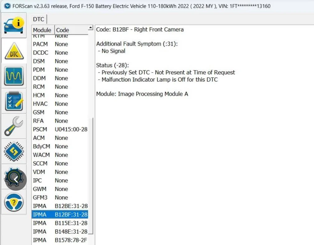

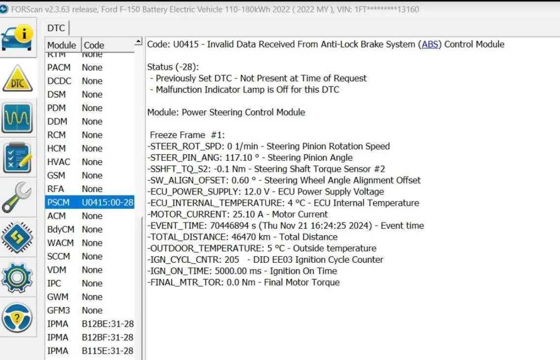

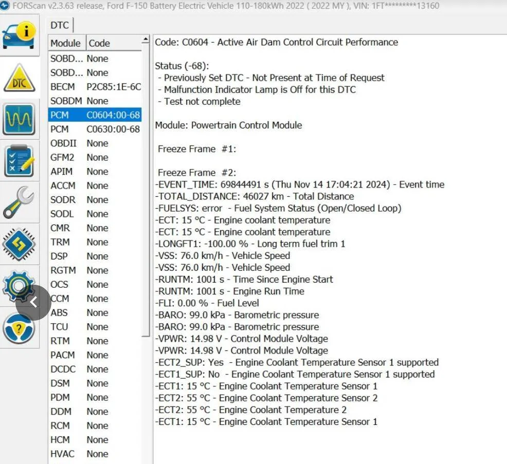

No warning lights are on the truck just found in Forscan..
Ford F-150 Lightning P2c85 - Hybrid EV Battery Voltage External Isolation Fault Snag_5410abee

There are others more experienced here, but for the ones that say "Previously Set DTC - Not Present at time of Request", I generally ignore, especially the ones that start with U (communication error).
The camera ones could also be a temp glitch in the IPMA. The air dam one is also somewhat common. I would clear them and see if they come back.
The first one is interesting and intermittant. Did you do a Google search for that specific code?

Yea not much came back from that one, a few folks had a battery fail but that was it. Looked like it was paired with other codes as well in those situations.
