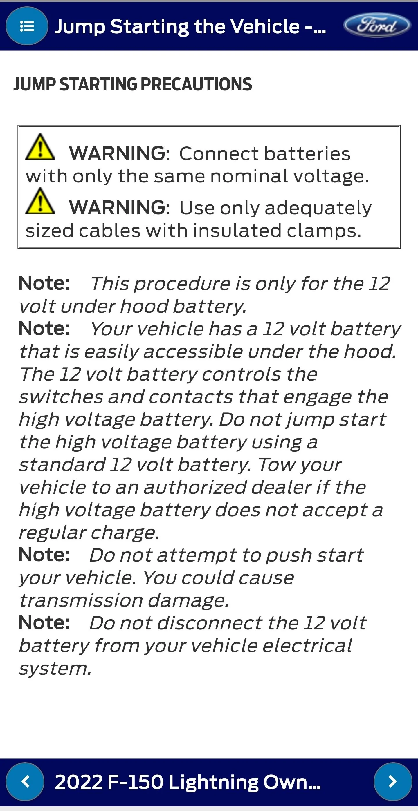

FYI, you don't need to remove anything from the frunk to jump your truck. They placed a positive terminal under the shroud on the passenger side between the frunk opening and the fender that is easily removable.

This may seem/sound stupid but why might I need to jump start an EV? (Please be kind; I really don’t understand.)

If you have issues with your small battery the truck may not turn on, drive, or even be able to put into the neutral/tow mode.

There could also be issues with charging. If the 12 v battery goes dead the HV battery won't charge. Everything in the EV runs off of the 12v battery other than the drive motors themselves. So it is still a critical part of the equation.

No spinning devices like an alternator. It is all done through electronics from the HV battery. The computer tells the truck it needs to charge. Contactors close and electronics step the voltage down and charge the LV battery. This can happen whether the truck is being driven or if it is sitting parked.
