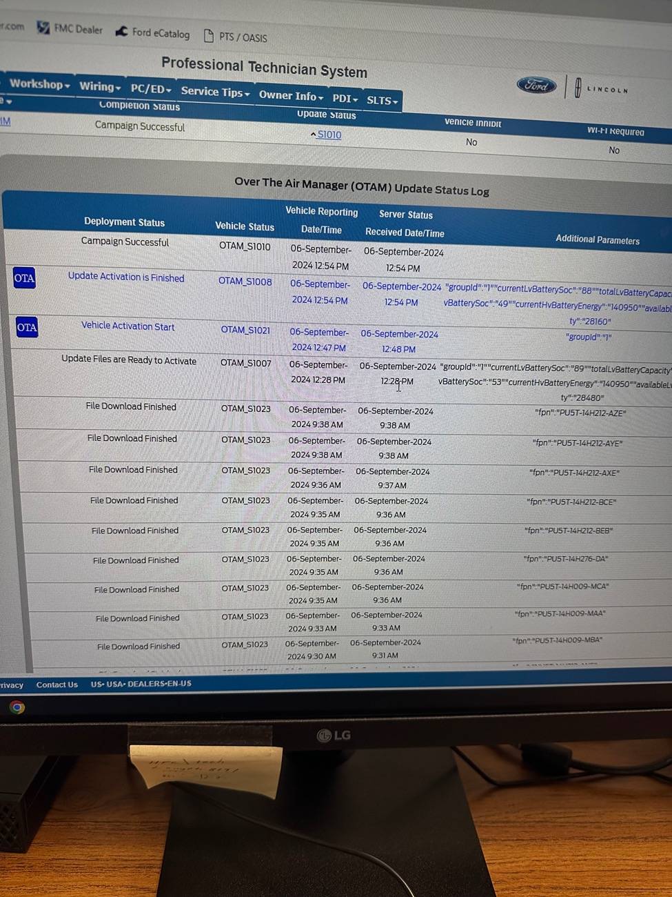

Looks like it might have been because of an OTA. Did not show up as completed in the truck until the following day. About 3 hours before it happened it finished a apim update

Interesting that it did the update while charging and outside the set time for updates. You can see in the log that both the lvb and the hvb increased in charge from the start and finish. Fun stuff
