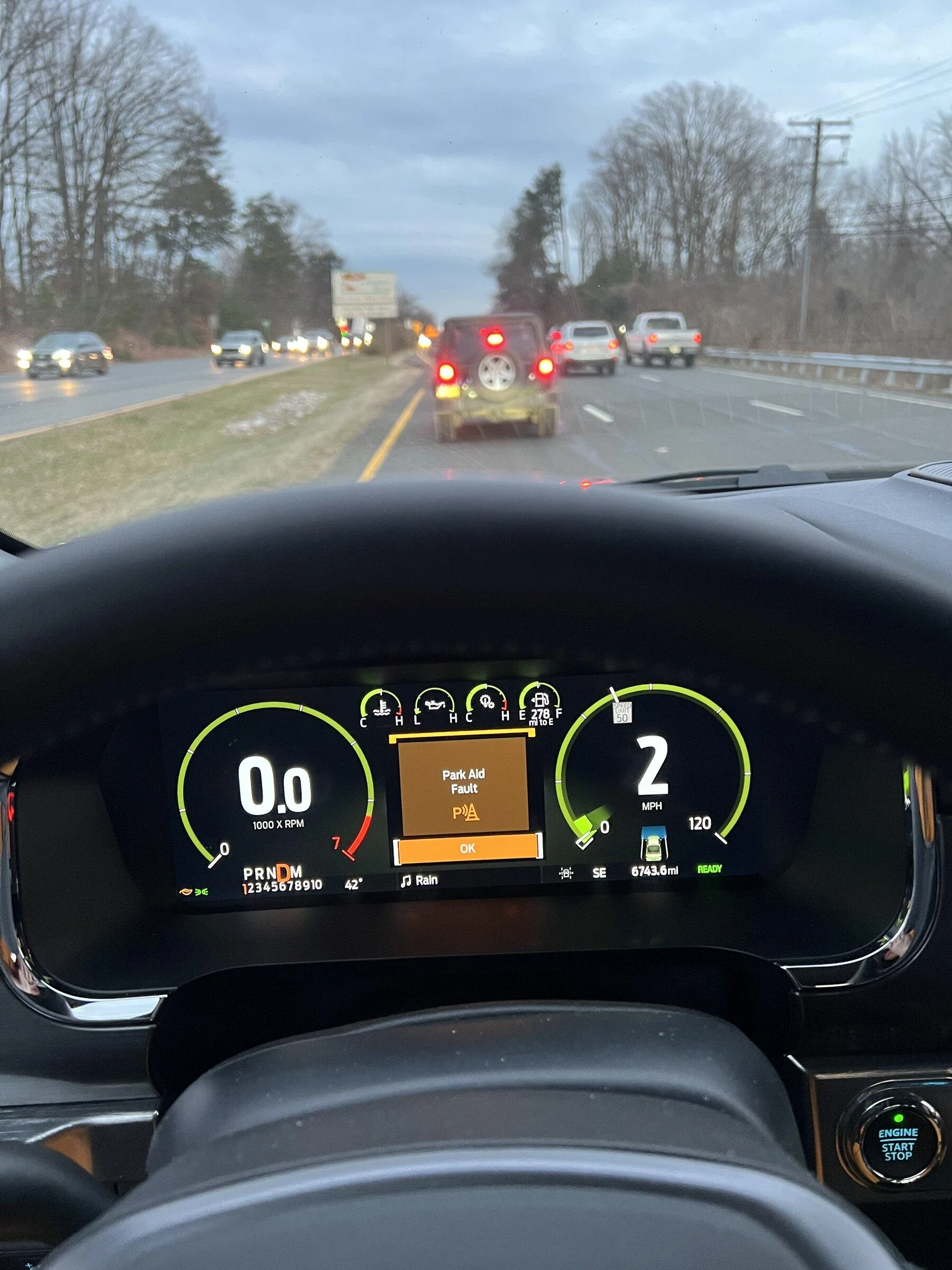

Got this just a few minutes ago while driving in some mild traffic.
Ford F-150 Lightning Power-Up 2.3.0 OTA rolling out 7F256E97-DB2A-4E93-826C-49430F26995C
