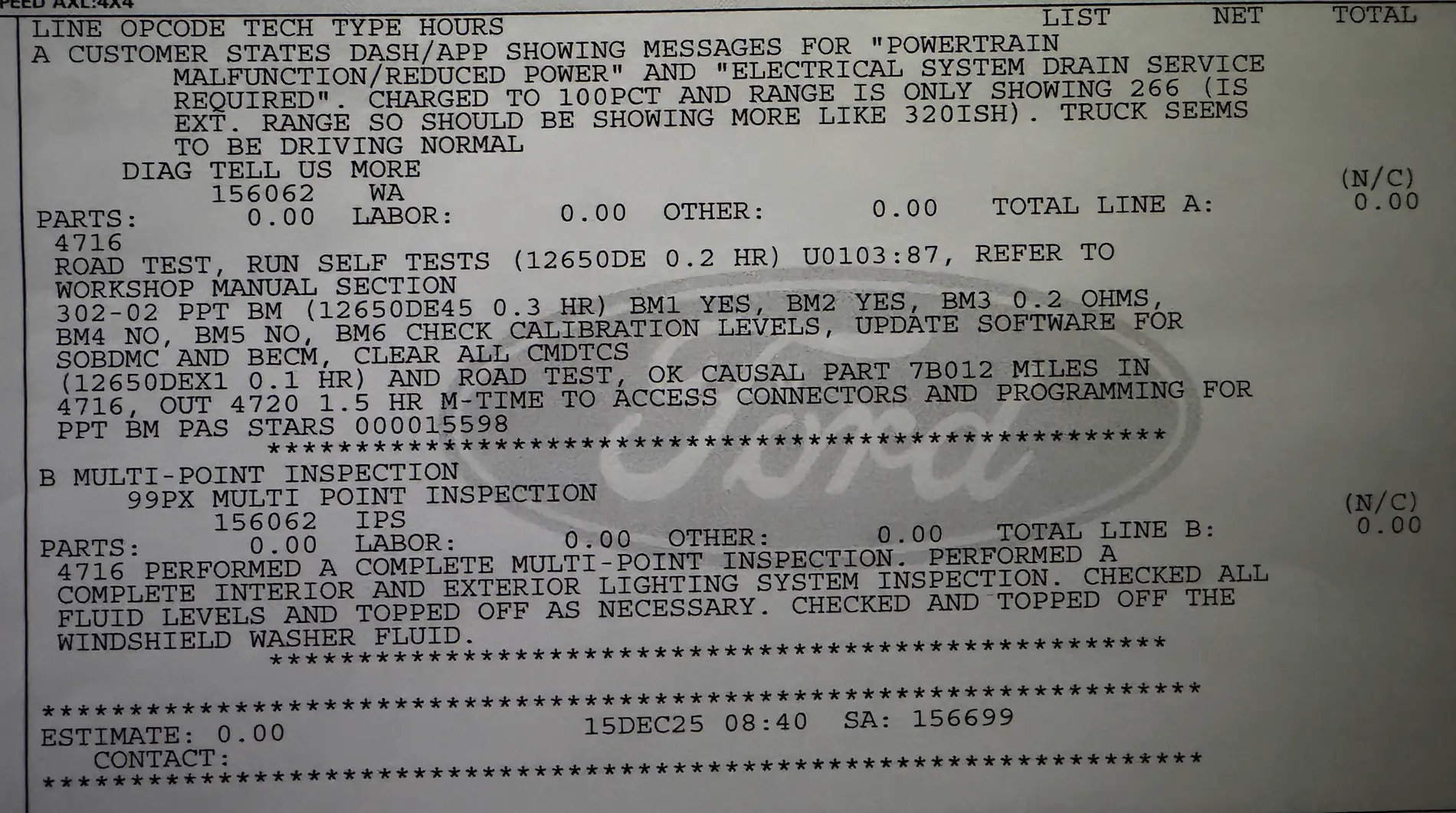

Got my truck back from the dealership this afternoon. Service tech told me they "recalibrated some modules" and everything should be good.
Here's a picture of the service sheet, maybe someone with more info/knowledge can translate it.
Ford F-150 Lightning Powertrain Malfunction / Shift System Fault / Service Vehicle Soon 1765841776042-js
220
16,057
18,032
The software updates to the SOBDMC & BECM must of did the trick!!
BTW, glad it didn't involve the thermal management system(s)
Yeah, fingers crossed this resolves the issue. I'm going to wait a while before I decide whether to swap the rotary shifter back in. Worse case I just keep it in case I get the dreaded GSM issue.
