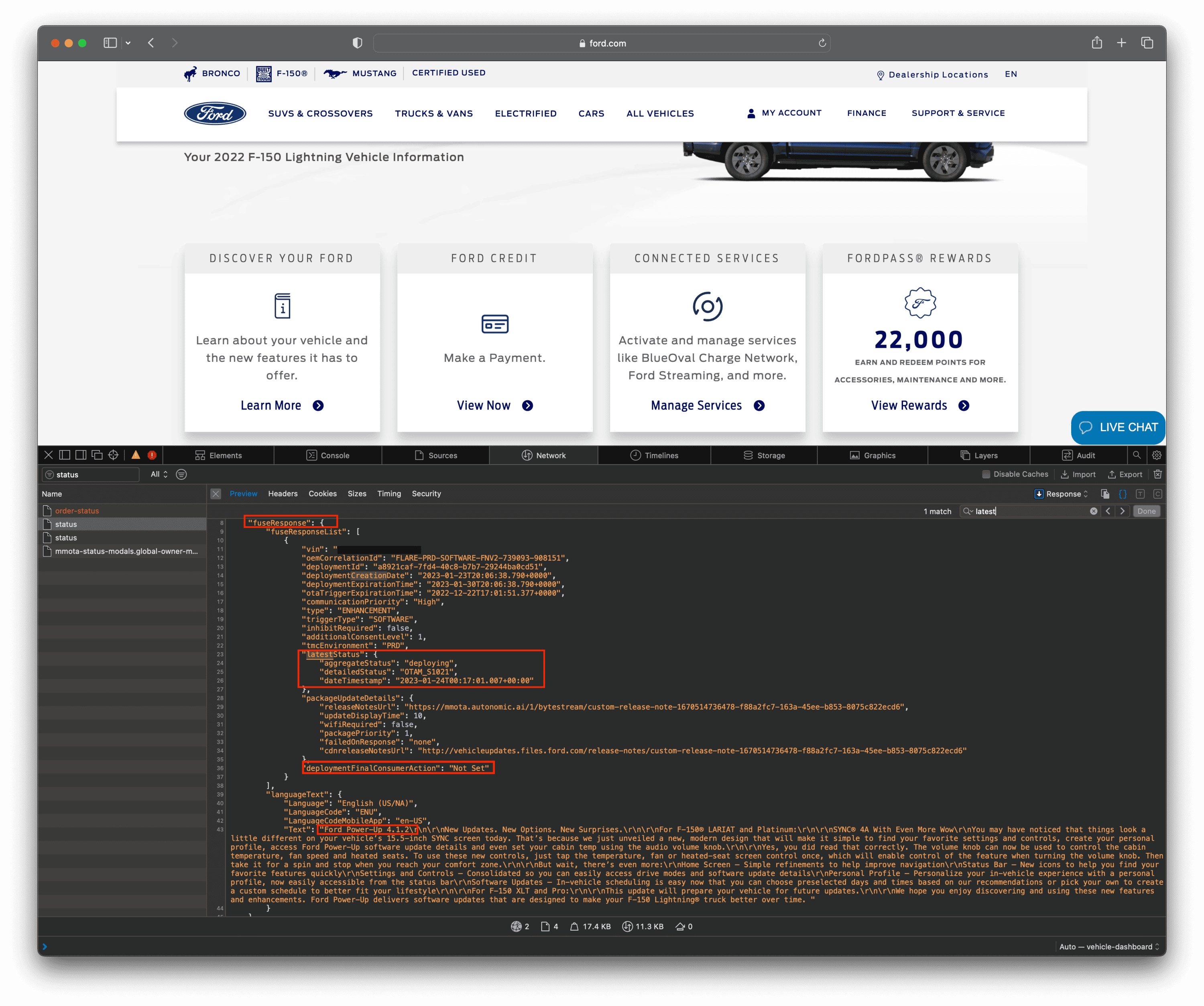

First of all, I did not find this myself. All credit goes to u/tatems and his/her post here:
I searched the forum if this has been pointed out before but didn't find any posts about it. Apparently, you can see your vehicle's software update status on ford.com
  1. Login to ford.com
  2. Open the developer tools for your browser - depending on your browser, it can be found in different menus.
  3. Select the Network tab and put in a search for status
  4. Navigate to your vehicle dashboard
  5. Look through the responses until you find one with a field called fuseResponse
  6. Expand that and look for creation date and time, as well as latest status. You can also see the changelog for the update.
I'm currently on 4.1.1 and already have the new interface. My truck hasn't alerted me to any new available updates. My guess is, deploymentFinalConsumerAction will change once I get the alert. Here's what I see:
Ford F-150 Lightning PowerUp status -- how to check if an update has been pushed to your Lightning (via Ford.com) Screenshot 2023-01-31 at 9.03.56 PM

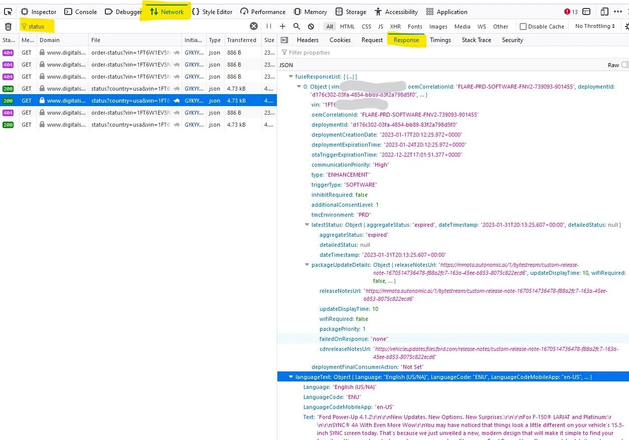

I get a bunch of these too, but i don't see a fuseresponse anywhere
Sorry, I'm not an expert - but here is a screenshot. I used Firefox this time and you can see the tabs. Make sure you refresh the browser so it pulls in the data. All three browsers I used opened vehicle dashboard in a new tab. I highlighted what I clicked or typed in.
Ford F-150 Lightning PowerUp status -- how to check if an update has been pushed to your Lightning (via Ford.com) Screenshot 2023-02-02 185117

I must be missing a step. I tried on chrome and Firefox. I cant find anything that says fuseresponse

When looking at dev-tools on the 'network' tab, when you click on something it should open a pane on the right side. Make sure you've selected 'response' there, and not 'Headers'.
