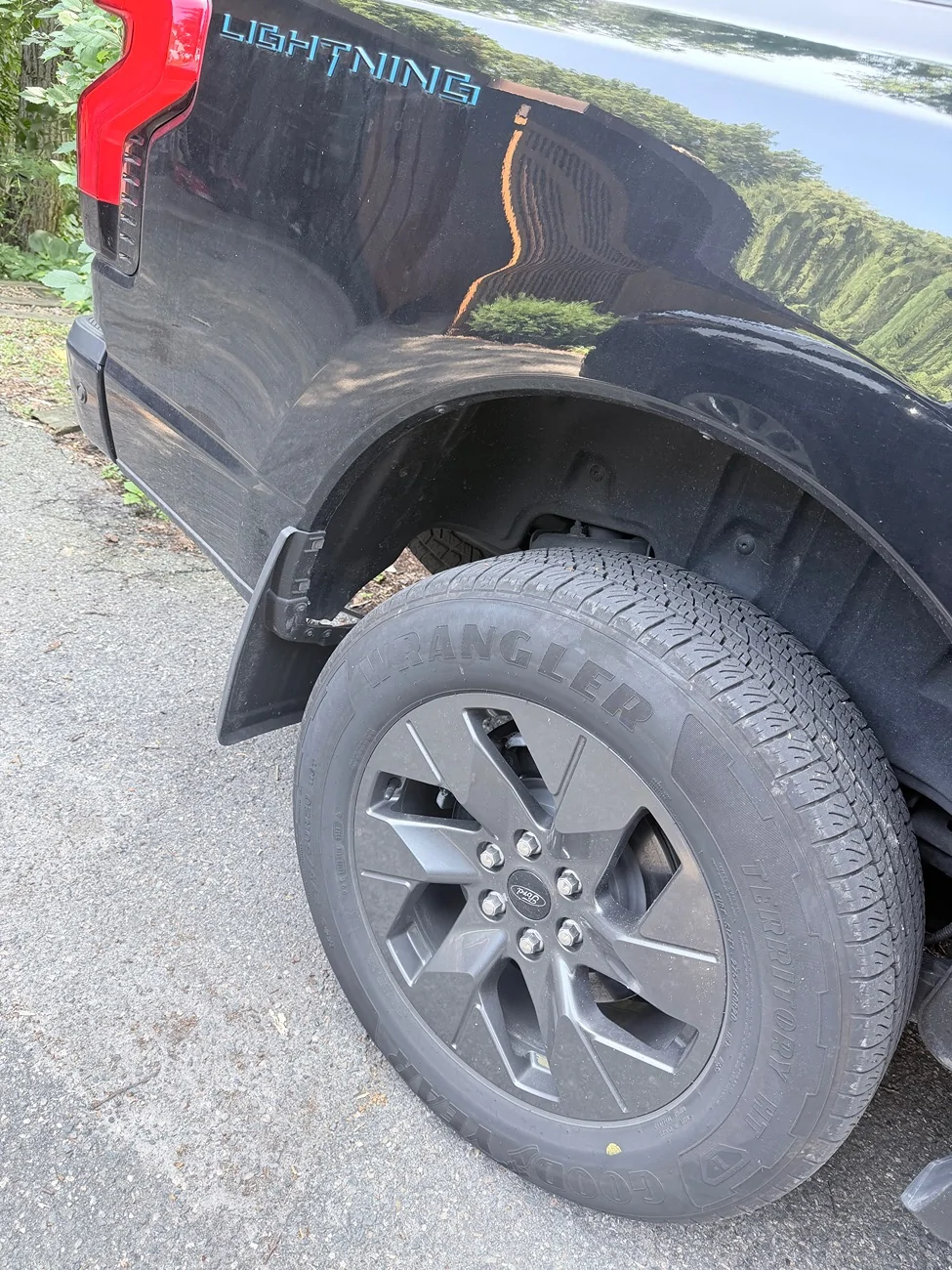

The OEM Goodyear Wrangler’s mine came with have been pretty good in my opinion. EV rated and I’m almost at 30k miles on them.
Ford F-150 Lightning Pretty bad blow out with a lot of damage IMG_6270
