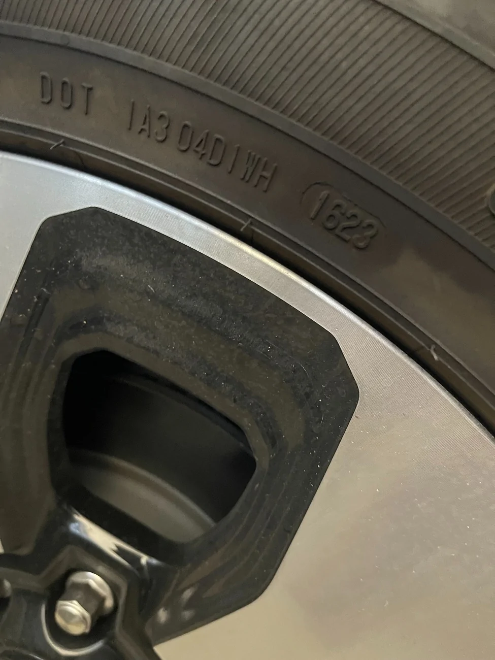

I would report this to the NHTSA. It's unfortunate that you bought it on Ebay, because you can't vouch for what happened to it prior to your ownership. Had it been original to you, then you could make a claim under the tire warranty.

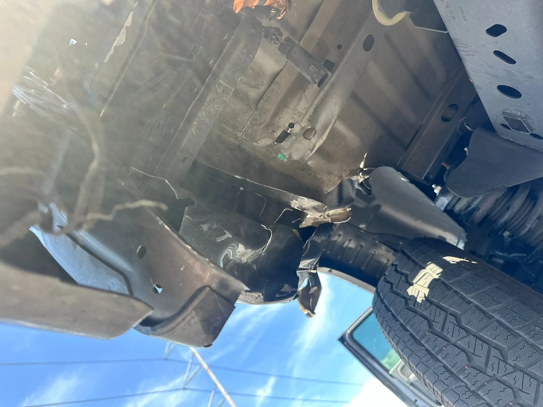

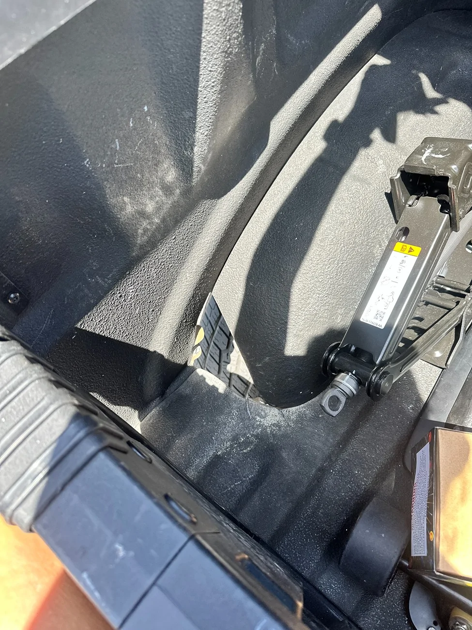

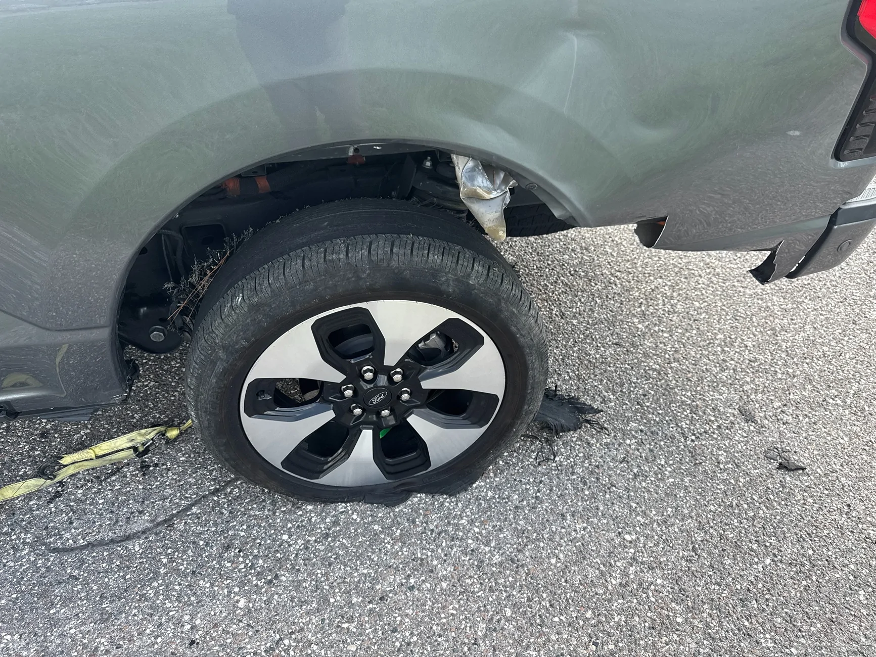

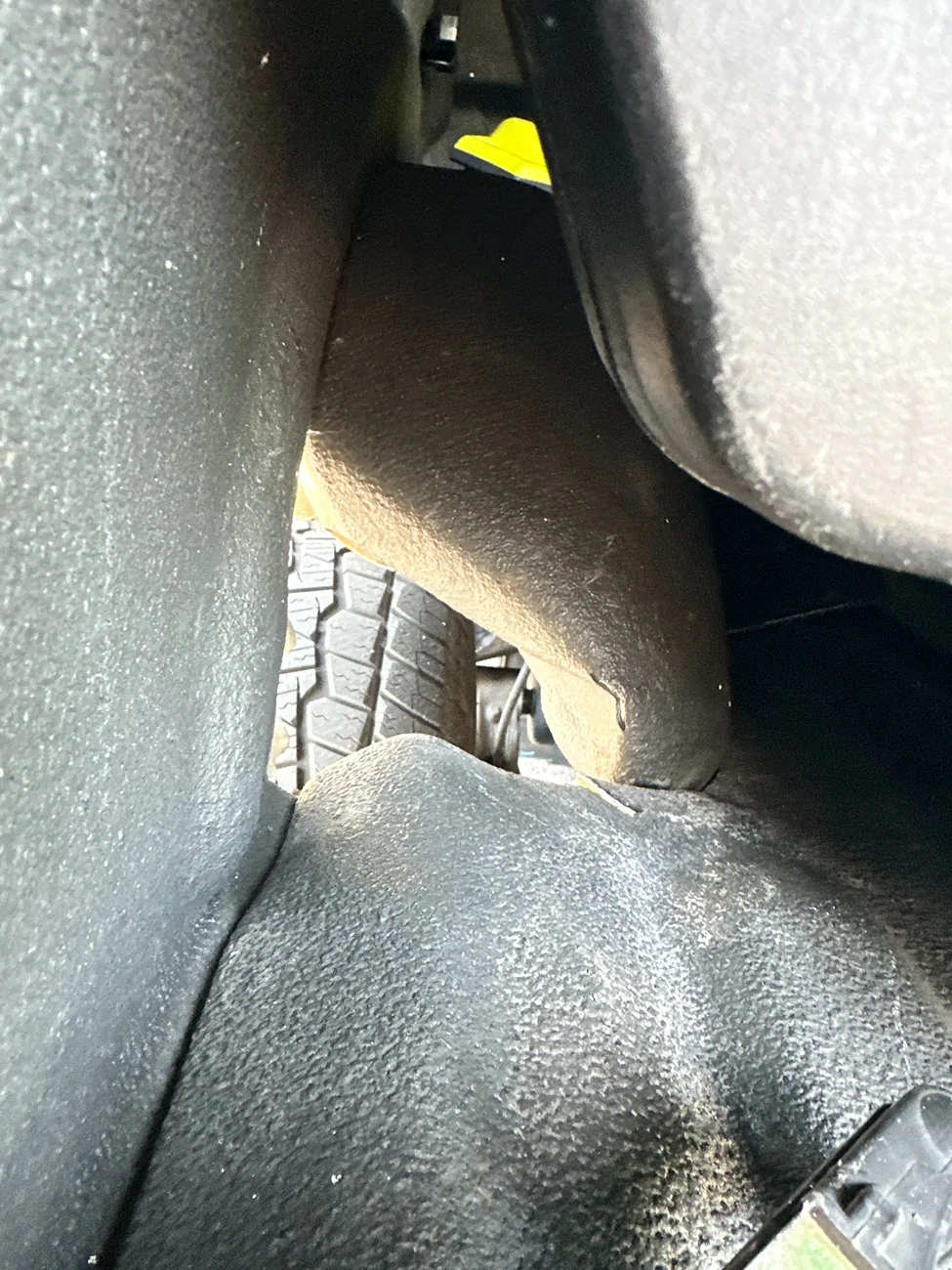

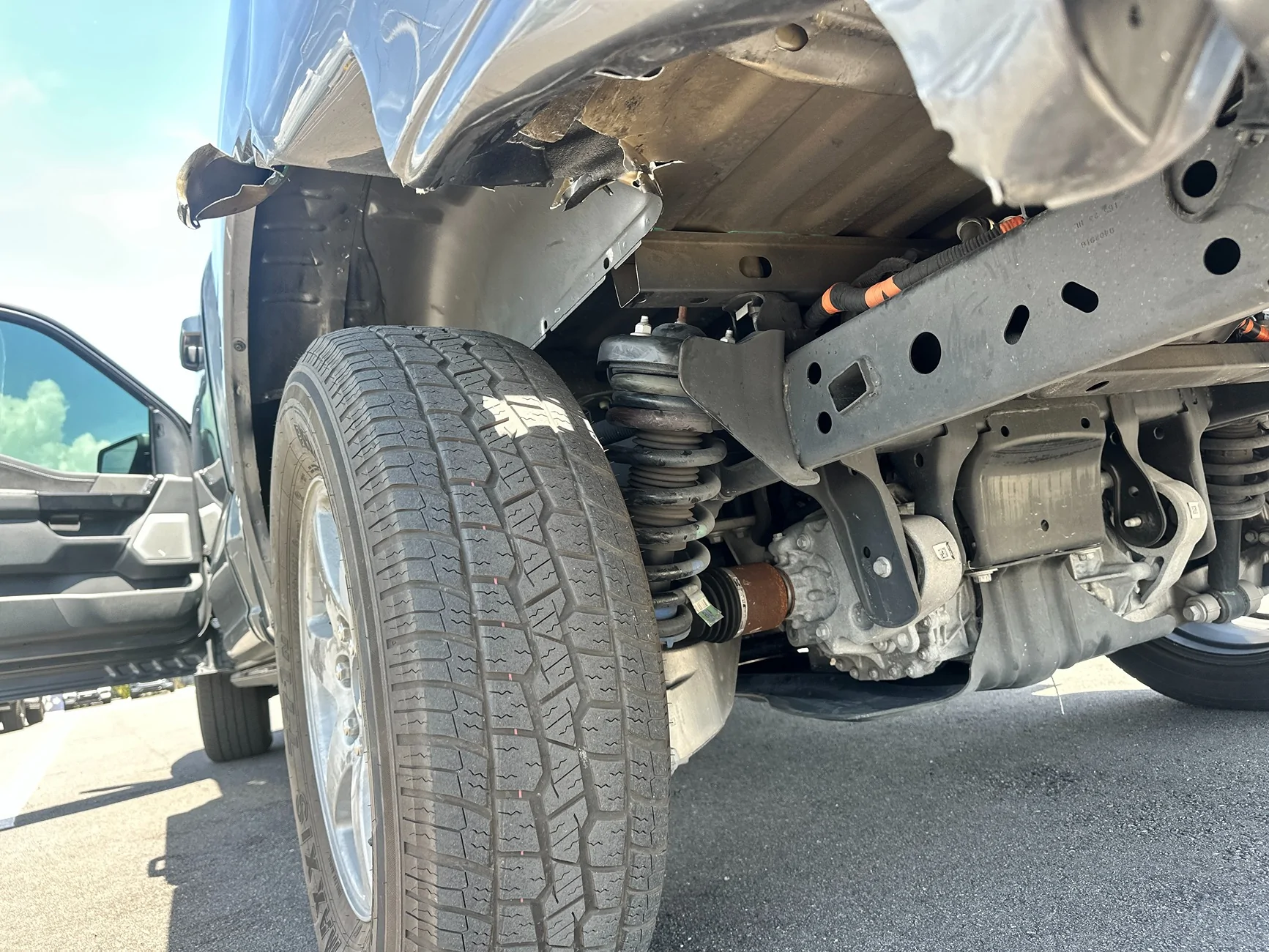

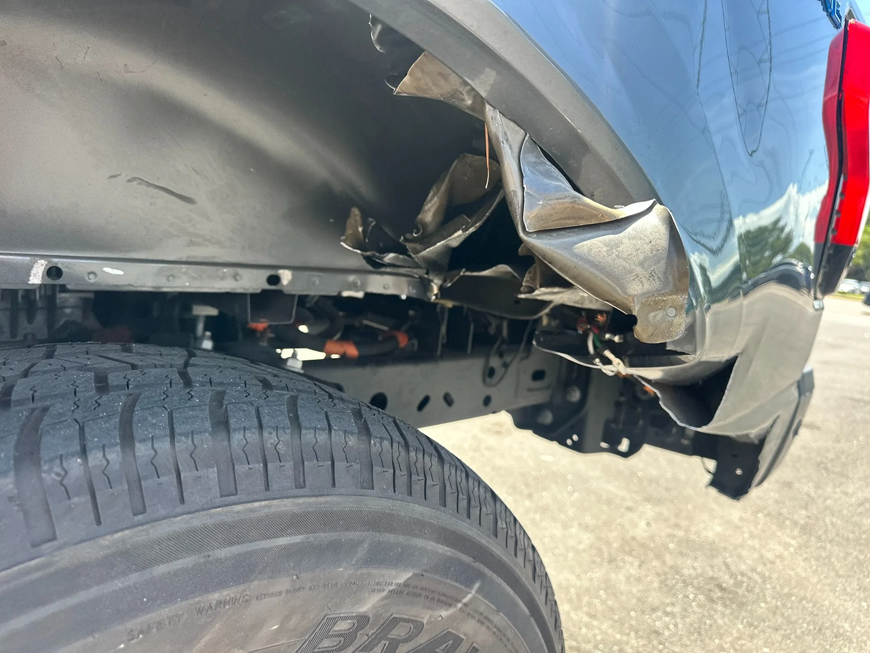

We have all read or seen the scattered reports of the factory 22" General Grabbers blowing out....mostly with little to no damage, however I was not so fortunate.
Pertinent info:
Speed 70-75 MPH cruise was set and going with the flow of traffic
Tread depth 6-7/32
PSI cold 41
Ambient outside temp 90-92F
Age of tire 04/23
No road hazard
No warning
Tire was bought as a replacement on EBAY 6 months ago with 8.5/32 tread as a take off replacement due to nail to close to the sidewall
No patches or plugs
Mounted and balanced perfectly
General Grabber 22" 115H load/speed index (the proper tire)

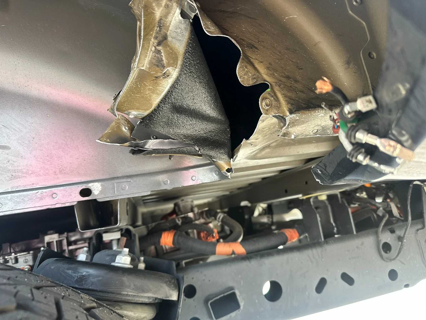

About $7k in damage. took out the bedside, blew hole into the bed space, busted up the power folding step, fender liner gone, yanked out the wires to the pro-power, my ratchet straps in the bed came out of the hole and wrapped around the axle and rubbed a wire loom raw.
When it blew, it was loud and violent, but Me thinks the majority of the damage was from the tread separating from the tire and spinning around at 70MPH flailing around and such.
I will try to logon periodically to answer questions but ill be hit or miss, so please don't be upset if it s a few days, just a busy guy.
I have a Ford rep pushing my case to up the ladder (not at my behest but in response to my FB post), but being no-one was hurt, this is clearly a TIRE issue and not a truck issue, the worst is my deductible and increased insurance rates.
FWIW I LOVE my truck. This is the 2nd one I have owned and when buying wife a new car last month we considered buying another one, but couldn't find what we wanted so we got her a loaded Mach-E Premium ER.
PS "F" Volvo and Ford For The Win!
