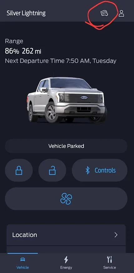

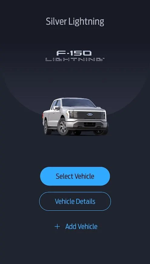

I don't have the Mach-E anymore as it was a trade-in. I deleted the Mach-E from my FordPass app on day 1 of Lightning ownership, as well as removing the Mach-E from my online Ford account in case it was interfering with the connection to Lightning, but no it didn't help.
Good to know, though this tip is not relevant to your situation, just wanted to remind folks of the vehicle selector at the top of the home screen on Fordpass if one has multiple Ford vehicles profiled to a specific account. Hopefully the dealer figures out the problem, might be that TCU.
