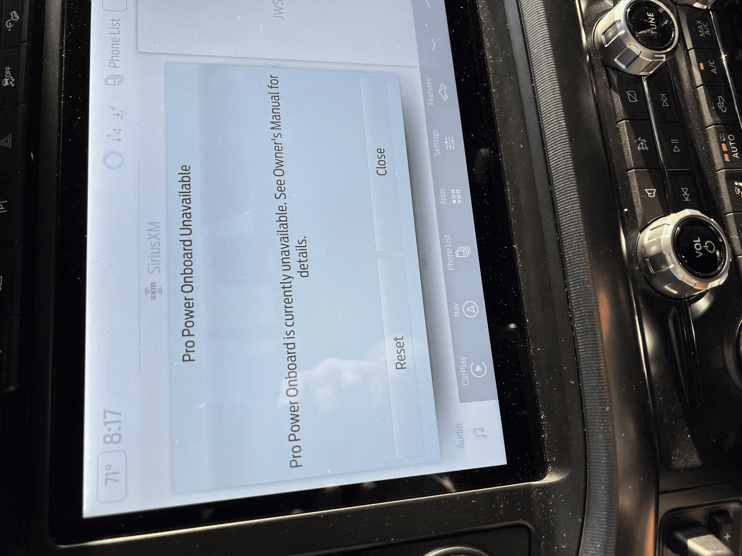

I keep getting this message (photo). It won't reset and when I close it, it will go away, then randomly pop up later. Stopped by the Ford dealership, but they said they needed to reset it with the computer and that it was not a 2 second fix. My appointment is later this week.
Have others had this issue? Why is it happening? What is the fix?

Looks like I might be the only person with this issue...going to the Ford dealer April 4...Will let the folks on this thread know what I learn.

Nope, there is a long and twisted history of this problem if you search around. I don't have first-hand knowledge of this problem since I'm still a "waiter," but have followed the trials of others. Some of these appear to be weather or moisture-related, creating a ground fault disable. There is supposed to be a software "fix" for this issue (or a related issue) coming out in April but my sense is that it's more of a threshold reset to leakage current versus a true correction of the root cause issue.
