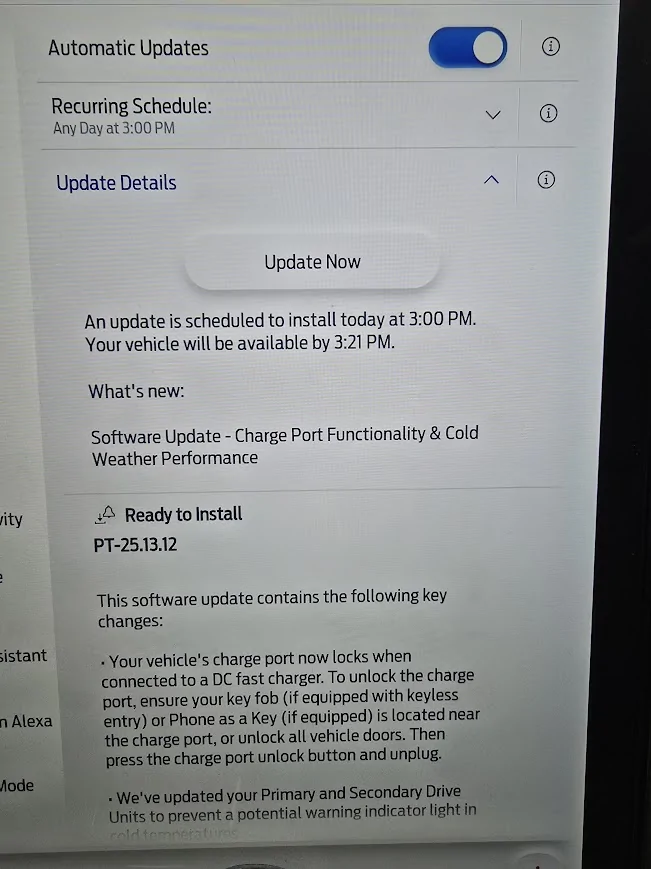

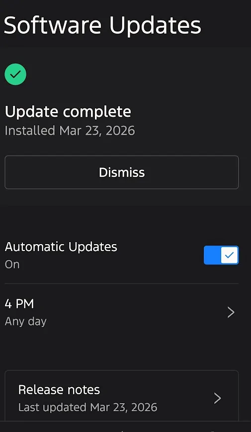

Alerted about this update this afternoon while I was at the car wash, vacuuming out all the winter sand.
After getting home, I adjusted the install time for 4pm instead of 3pm to allow for an afternoon recharge to finish 81 to 90% done, unplugged around 3:40 and that was enough time for the truck to sleep the systems, I force stopped Ford App and didn't touch it until a few minutes ago.
Successful install!
