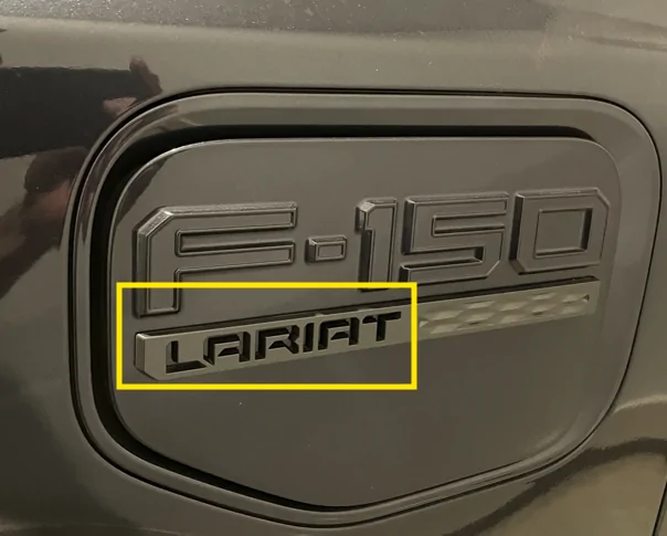

Your charge port door will tell you exactly what model you have. I've noticed a few dealers that list every Lightning in their inventory as a Pro; dealers are dumb that way.
My cover is the exact same as yours. The reason I thought mine was a pro is because that’s what Chat GPT told me lol.

Never trust AI. Please update your Vehicles as @TaxmanHog shows in post 15. Sounds like you have a "2023 F150 Lightning Lariat ER".
