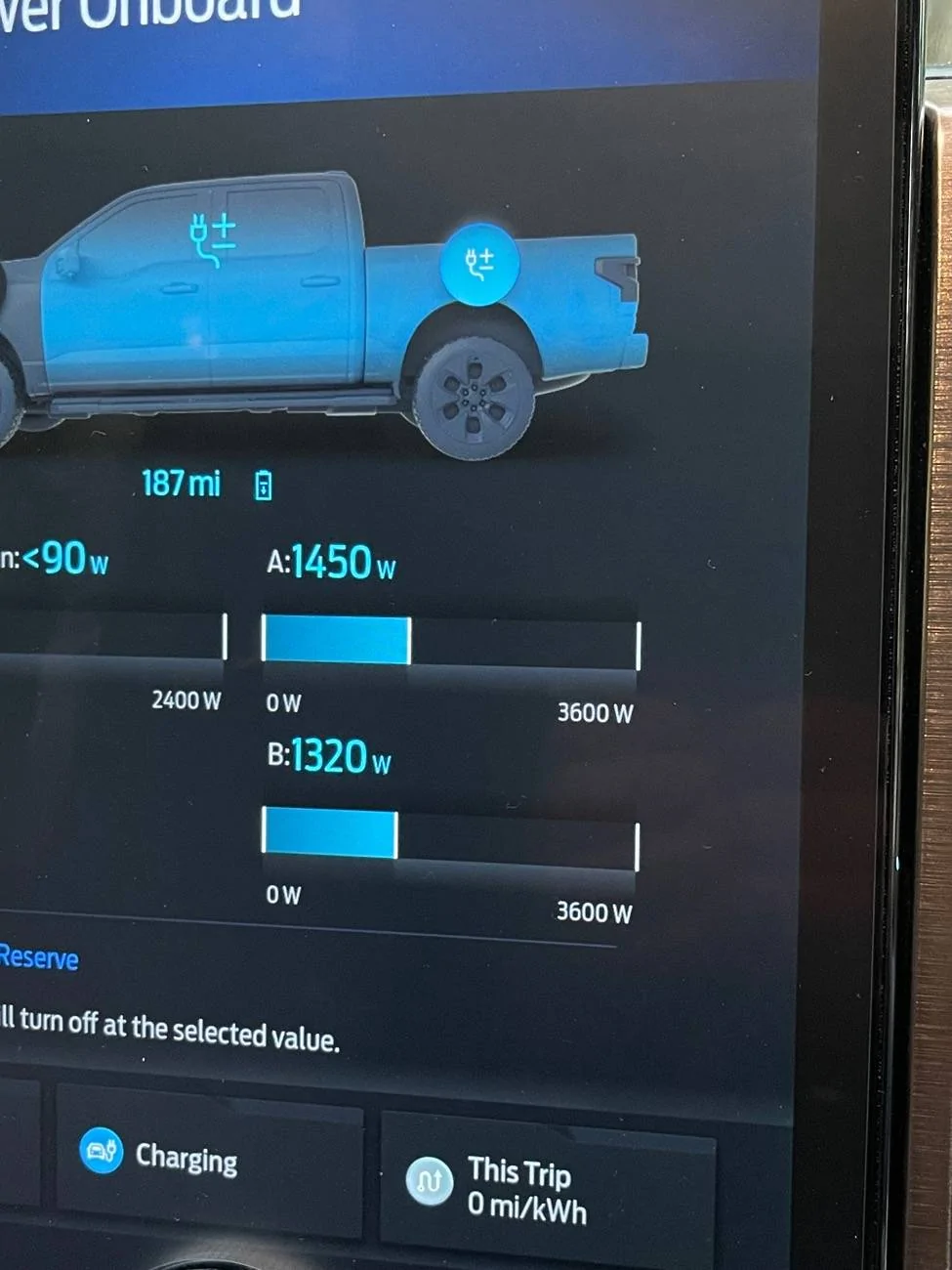

Got my house up and running! Was able to run all 120 appliances together and one 240 appliance. The soft start that I installed on my HVAC really helped, even though I had to make it learn a second time. The inrush current for the compressor is down to 18 amps! When the HVAC isnt running the truck can do either the dryer, water heater or range/oven with some room to spare. Shout out to interlockkit for providing a custom interlock needed for my main breaker

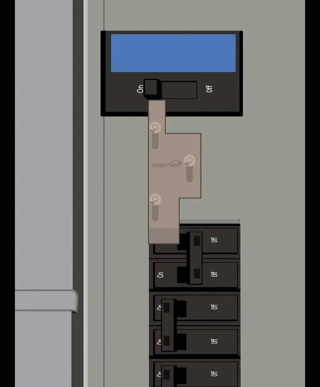

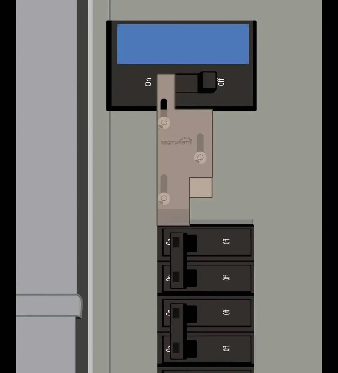

The interlock is just a piece of sheetmetal that creates a physical barrier. Ive attached pics for your reference. It basically does not allow you to backfeed your panel with the main breaker on. You can either have the breaker for your generator inlet on or the main breaker, but not both. This prevents the Lightning backfeeding the grid as well which can injure a linemen.
What I have installed on my AC is referred to as a soft start. The breaker trips because the initial current required to start the compressor is higher than the truck is willing to provide. The soft start lowers that inrush current by 75%. On my particular compressor, the inrush current was 77 amps (more than double what the truck can put out). The soft start reduced it down to 19, which the Lightning is perfectly capable of.
The biggest hurdle is getting the compressor running. After that, it only draws 8 amps which gives me another 20 or so to play with. All my home lighting is LED which, when added up, makes a BIG difference over incandescent bulbs. Overwall, this is a project I have been wanting to complete for a very long time and I finally got the time to do it. Well worth the time and energy spent!

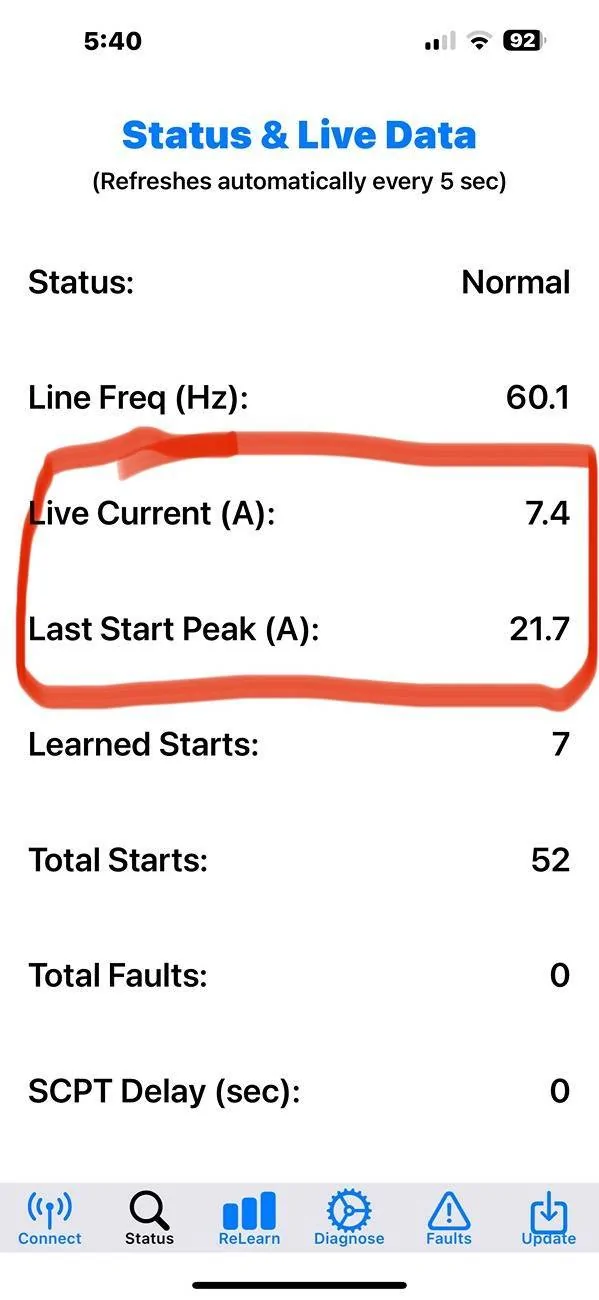

A few weeks ago I also installed a MicroAir EZ Start that I got on Amazon with next day delivery. Easy installation if you look at YouTube videos. It dropped my inrush current from 107 amps to an amazing 21 amps on my 8 year old Rheem Straight cool 16 SEER central AC systems compressor. I agree that start up and run sounds are much smoother and I believe quieter.
I haven't tried to run it with my truck yet but it would not run with the truck before the installation.
Here is the link to my posting. https://www.f150lightningforum.com/...me-during-storm-25-kwh-day.27321/#post-512787
And here is what MicroAir reports as the amperage after installation.
Ford F-150 Lightning Real-World Home Power Backup Options Using F-150 Lightning IMG_0577 (1)

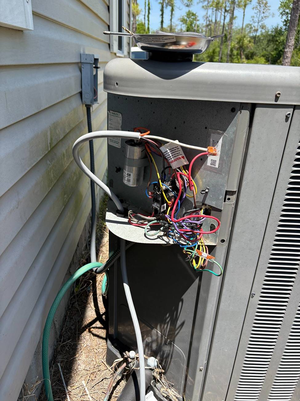

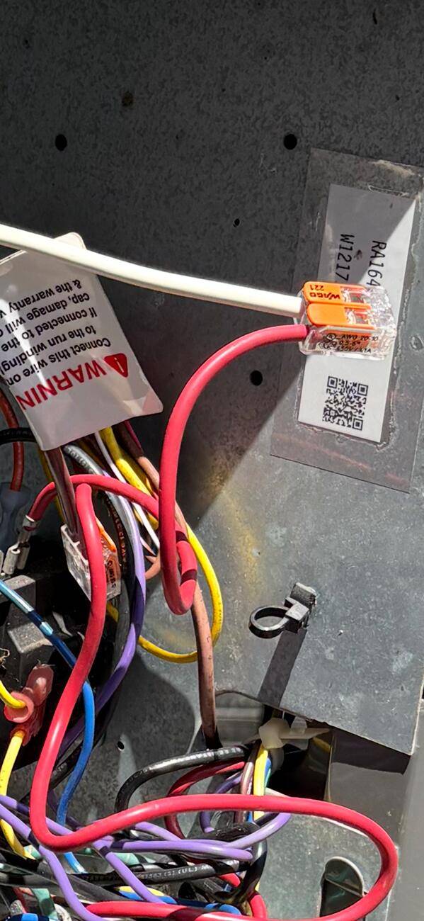

I bought the MicroAir EasyStart Flex with the installation kit from Amazon for $399. The installation kit included preinstalled spade connectors on 2 wires and a few WAGOs for splicing the wire from the compressor that goes to the contactor.
While I was doing the installation I measured the capacitor and it was readimg 10% low, out of range, so I replaced it at the same time. I also ordered a spare contractor. I figured if I had a spare it would never fail. ?
I mounted my MicroAir Flex outside and under the covered wire box. I used a 3/4” waterproof cable Gland to run the wire into the wire box. I had to drill a hole for the 3/4" Gland wire entrance with a step drill.
https://www.amazon.com/dp/B0DKQN4XRJ MicroAir with installation kit
https://www.amazon.com/dp/B094ZFP22C ¾” waterproof Gland
This picture was taken prior to mounting the Microair unit to the condenser, but it shows WAGOs splicing the Brown and White MicroAir wire to the Compressor run wire at the contactor BEFORE I cleaned the wire mess up with Tie Wraps .
Ford F-150 Lightning Real-World Home Power Backup Options Using F-150 Lightning IMG_0562
