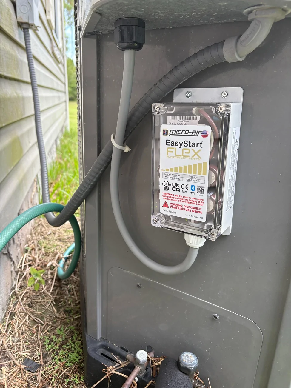

I'm very impressed.
I bought the MicroAir EasyStart Flex with the installation kit from Amazon for $399. The installation kit included preinstalled spade connectors on 2 wires and a few WAGOs for splicing the wire from the compressor that goes to the contactor.
While I was doing the installation I measured the capacitor and it was readimg 10% low, out of range, so I replaced it at the same time. I also ordered a spare contractor. I figured if I had a spare it would never fail. ?
I mounted my MicroAir Flex outside and under the covered wire box. I used a 3/4” waterproof cable Gland to run the wire into the wire box. I had to drill a hole for the 3/4" Gland wire entrance with a step drill.
https://www.amazon.com/dp/B0DKQN4XRJ MicroAir with installation kit
https://www.amazon.com/dp/B094ZFP22C ¾” waterproof Gland
This picture was taken prior to mounting the Microair unit to the condenser, but it shows WAGOs splicing the Brown and White MicroAir wire to the Compressor run wire at the contactor BEFORE I cleaned the wire mess up with Tie Wraps .
I am responding to my original post where I detailed the Micro Air installation. Here is a picture of the final placement of the unit. It works extremely well and allows me to use my truck to power the central AC at my cabin when power is out.

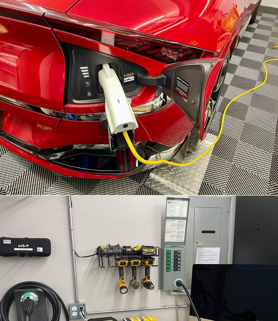

Just bought a '25 Flash with 9.6kW Pro Power and planning to use it to power (part of) our home during outages.
Previously we had a KIA EV6 GT that featured a dedicated V2L via the CCS port which we connected to a 6 circuit transfer switch that we had professionally installed. The EV6's V2L maxed out at 1.9kW/16 amps which was plenty to run the following circuits: Refrigerator, kitchen lights/outlets, furnace, two offices (computers, broadband, WiFi, etc.), family room (TV lights, etc.), primary bed and bath, bonus room, instant hot water.
After some research and feedback elsewhere it looks like our setup will work with some mods/differences such as using the Lightning's power outlet in the bed and addressing the Lightning's GFCI.
I've received numerous "try this or try that" suggestions by folks but not from anyone that actually has a similar setup. Understandably it's difficult as they can't "see" ours in person so I've attached a few photos.
Asking the experts here - especially if you've had success with something like ours - for the best option, ideally something that I can pass along to our electrician so that he can make any needed modifications. Happy to provide any additional info of course.
