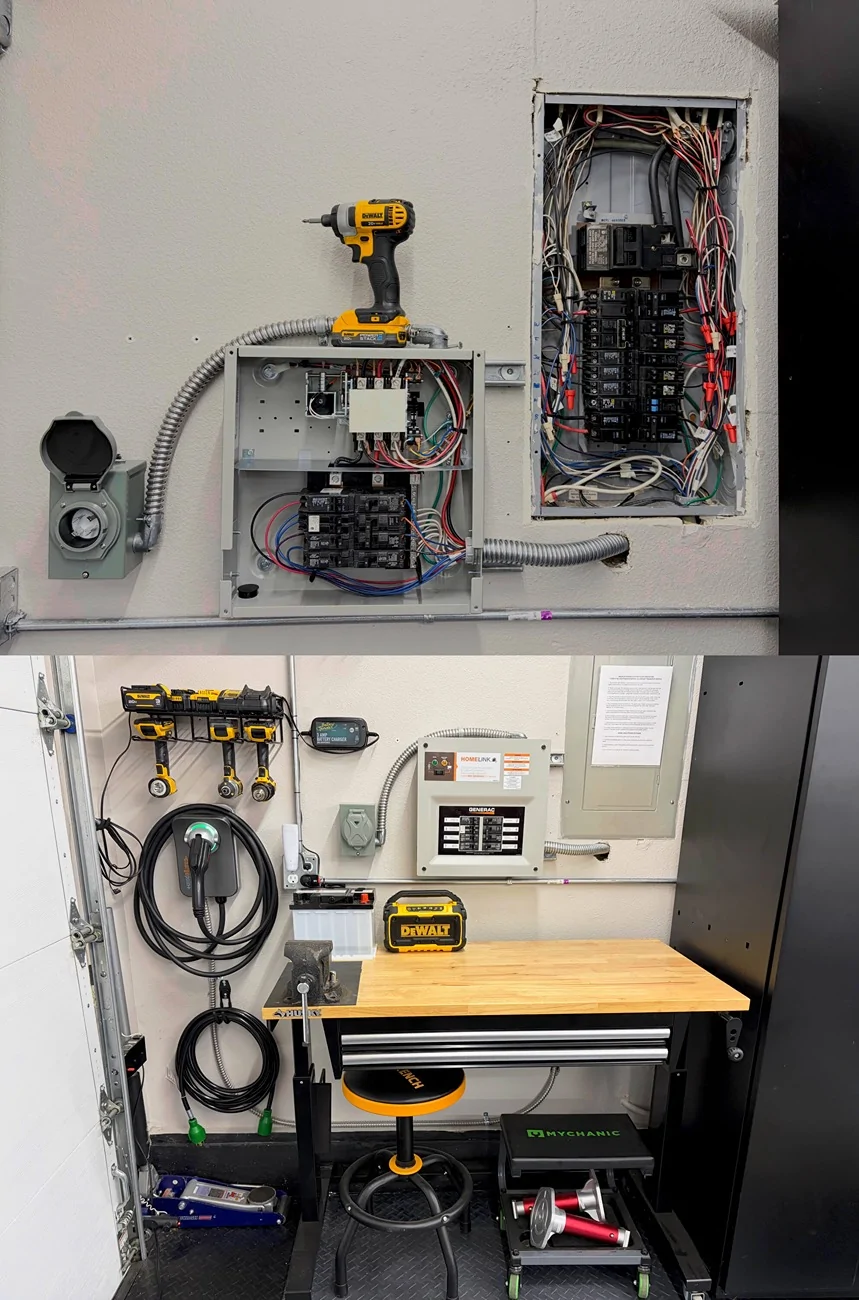

Quick question: has anyone tried using a neutral-ground bonding plug on one of the regular 120v bed outlets to address the Lightning's "floating neutral"/GFCI issue to use the 240v 30a outlet with a manual transfer switch/sub-panel? Would a bonding plug (that manually connects the neutral and ground pins together) on a separate outlet, satisfy the truck's safety logic and the transfer switch requirements?

Welcome any feedback from the experts. TIA!

No the Lightning has a bonded neutral ground and your house has a bonded neutral ground. You want to lift (clip) the ground on the plug going into your 240V 30a outlet so it will work. This would not help you.

Makes sense. Our previous EV had a V2L feature so we already had a transfer switch and it worked great for outages. However it was limited to 120v/15a @1.9 kW and we wanted to take advantage of Ford's PPOB 240v/30a 7.2kW outlet to power some additional circuits so we had to start over. Still working through this with our electrician. He's installed a Generac 6852 manual transfer switch and wired the 10 circuits we settled on as a sub-panel with an inlet box.
When we connected it to the Lightning we experienced the GFCI fault. I had already ordered the recommended Generlink Ford Vehicle Connector (non-conductive ground) rather than having the him spend more time ($$) to try and resolve things. He said that he thought that using the adapter would work and didn't see a safety issue. Adapter will be here Wednesday so hopefully that'll be it. 🤞
EDIT: Wanted to clarify that it appears the Lightning's GFCI issue in our case is apparently due to there being a shared neutral somewhere in our home that's part of one of the circuits being used in the transfer switch. Otherwise it's wired correctly and should work fine without the adapter (per @carys98's post where he has the same setup).
