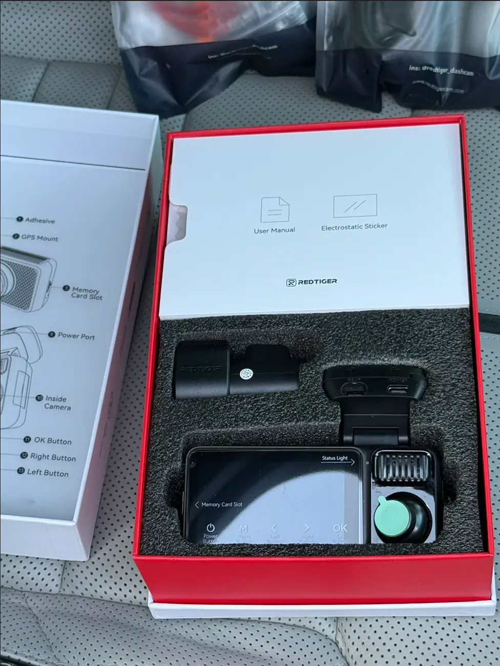

I was sent the REDTIGER F17 Elite in exchange for my honest review, and they had no editorial oversight over the contents of the review. The first time they are reading the review is when it's posted publicly. They only asked that I had the review done sometime in the first week of February. I’ve seen other feedback from reviews here and people appreciate a short summary, so I’ve made a TLDR for each section.

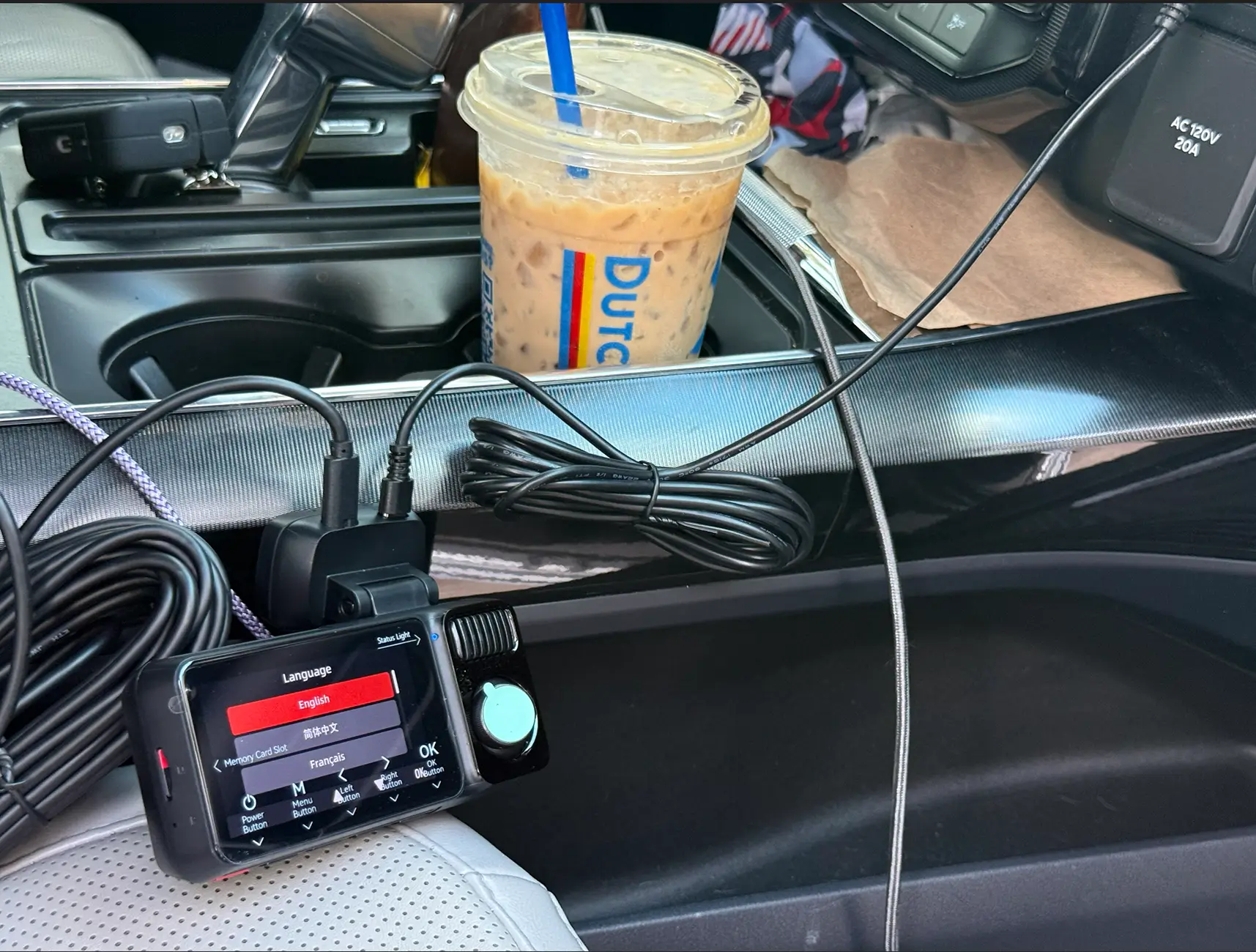

I love projects like this, so I decided to make an evening out of it and enjoy the cool weather with a nice beverage in my driveway while listening to a podcast. I always appreciate the effort put into the box opening experience, to me it just makes a product feel more premium and I was happy to see a nice presentation when I opened the box.
They sent along the 12v lighter adapter as well as an extra long cable for the rear camera which I did end up using. I have a habit of doing a LOT of research about projects like these so I can have an idea of exactly what needs to be done when I go out to the truck, to cut down on having to look stuff up on the fly, and this is what I’d recommend to anyone installing this.

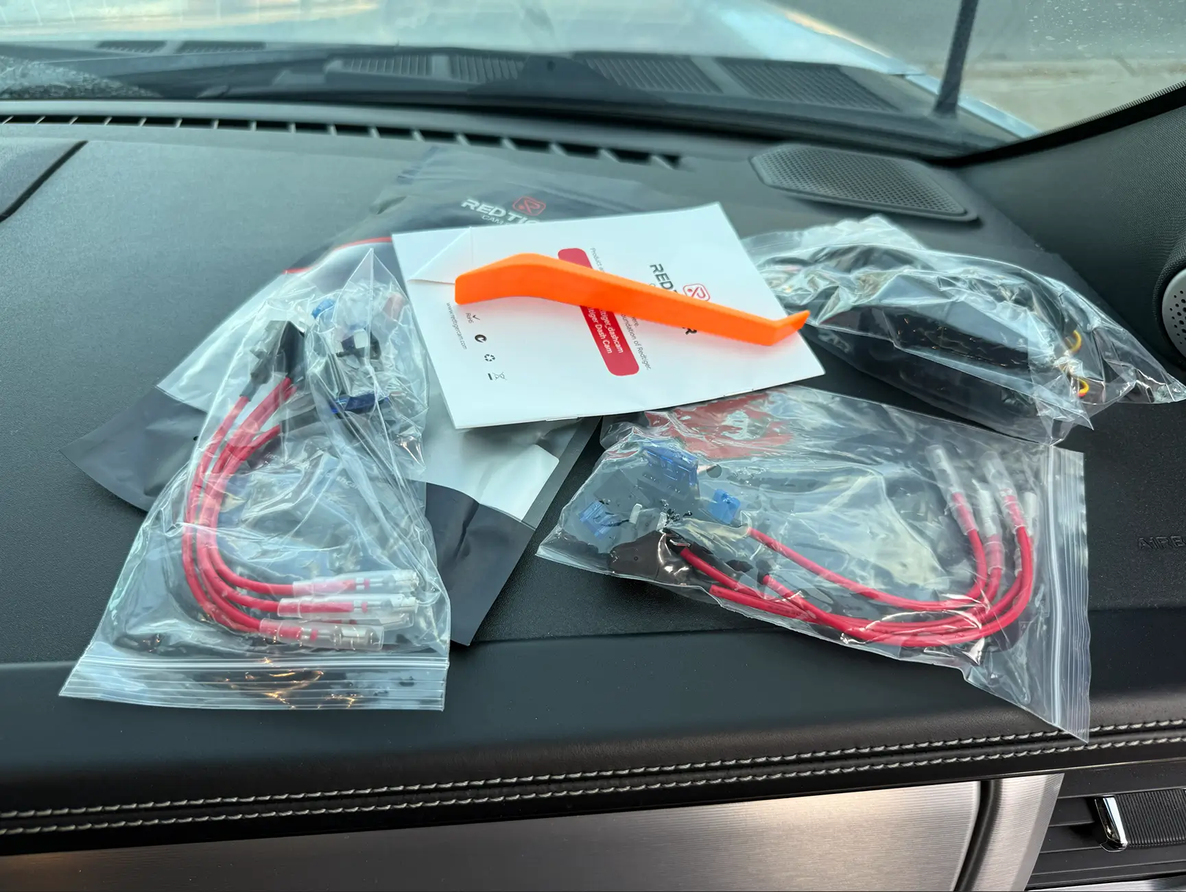

It comes with generic instructions about how to decide which fuses to use, and the installation package it came with includes several fuses of different sizes, but nothing specific to the truck. This is the nature of aftermarket accessories of course, but doing a quick Google search for installation of a device + your make and model vehicle will usually yield some specific results on various platforms that will be a great help.
For the installation I will be hardwiring this and not using the 12v lighter adapter, but before tearing apart the truck, I plugged everything including the rear facing came into the 12v outlet to make sure they were functional.

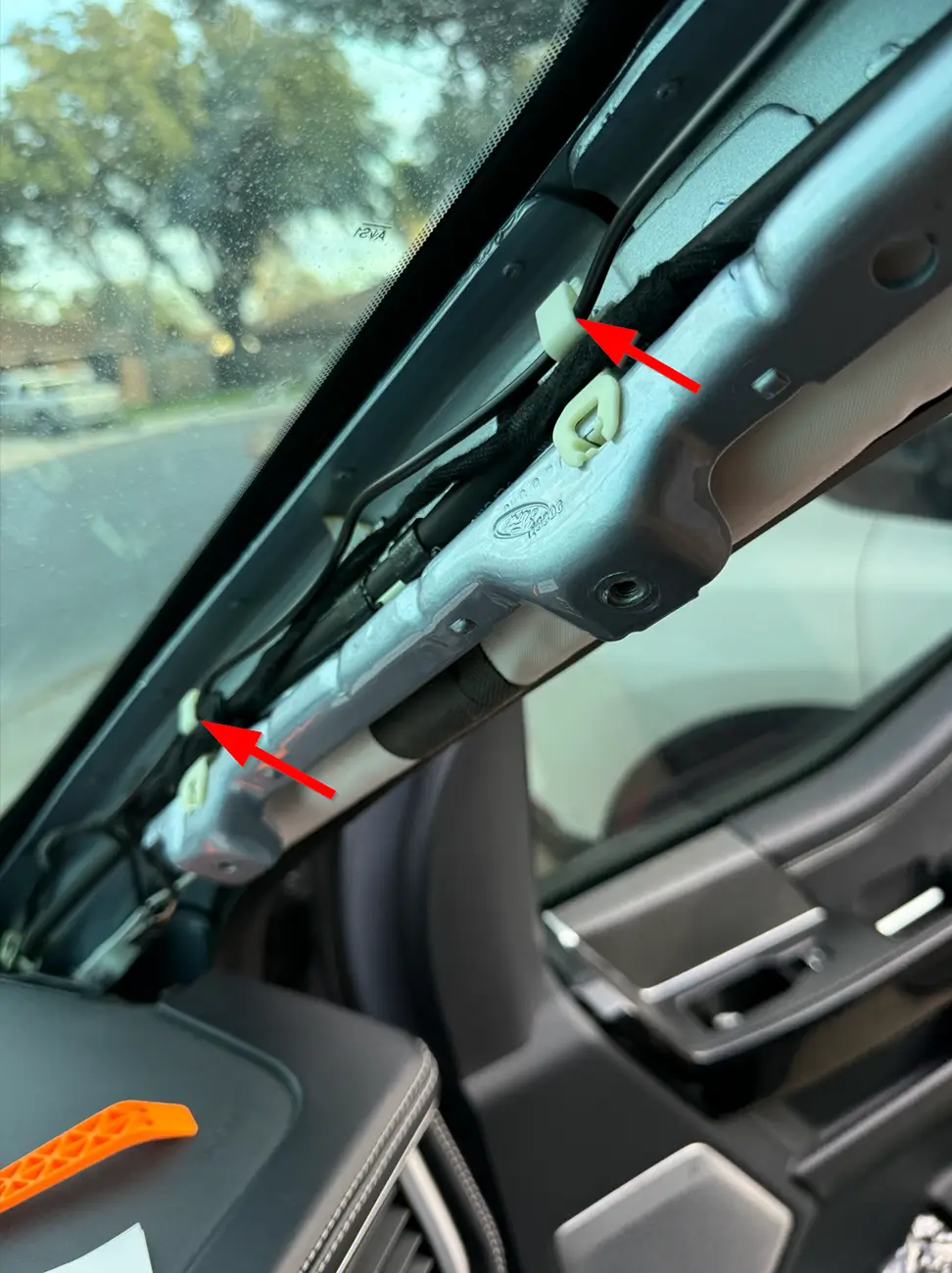

With that out of the way I got to work running the cables. I decided to work on the power first and then run the USB C for the rear camera after I got that working. I held the camera up where I’d wanted it, and then just started tucking the cable under the overhead panel and down the pillar. There are wire clips in the pillar already, and I used those for simplicity’s sake. Then I ran the wire behind the weather stripping alongside where the door closes, and down the where the fuse box is on the interior of the cabin near the floor of the front passenger seat.

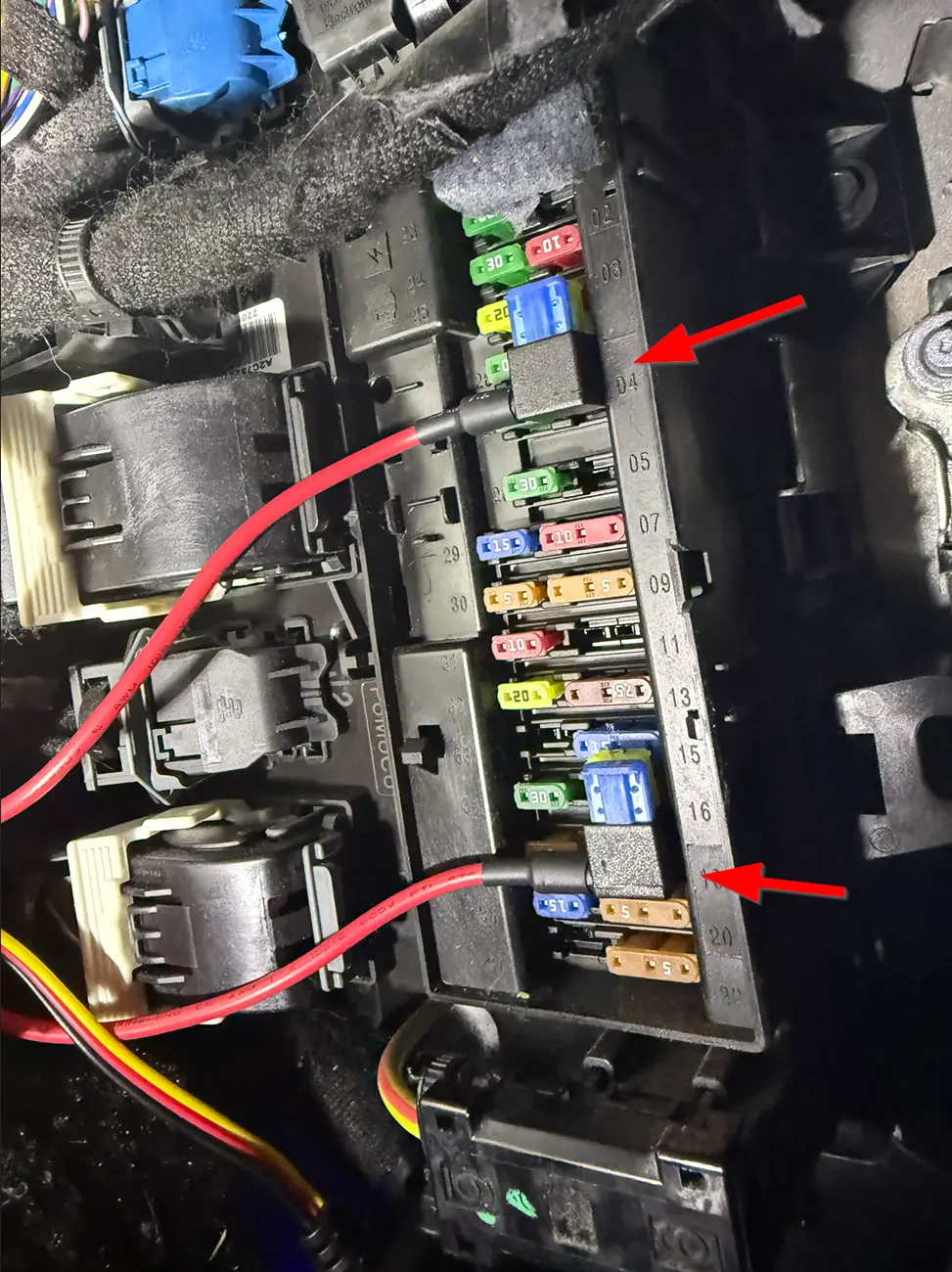

Once I got there, I popped the panels off and ran the wires back there and got started on figuring out the fuses. From reading other reviews, I was prepared to work awkwardly here due to the position of the box, and installation videos I had seen of ICE F150s showed that the box pops out and has a cover, but neither were the case with my Lightning.
Every review I had read for F150 Lightning installation used fuse position 4 for the constant 12v power and position 17-18 for the switching power. No sense in reinventing the wheel, so I trusted my Lightning brethren and decided to follow the beaten path. What was not clear to me was that this meant you are to remove the existing fuses in those positions and insert them into the fuse tap (which has its own fuse), and then insert the tap into the position where the first fuse was removed. It's the first time I've used these types of fuse taps, so just wanted to include that for any other first timers.
For position 4 this was easy but 17-18 is a different size fuse than the included tap. However, you can use one of the micro2 switches instead, without issue. The only problem is the fuse removed from this position does not fit, so you have to pull one of the many spares in the box to take its place. Believe it or not, I used the Ford AI assistant (shout out to Brian @Ford Motor Company ) and it was able to tell me instantly which fuses were labeled as spare in the manual without me having to look it up myself. Nice work Brian and Ford team that was definitely easier than digging through the manual.
After that, I grounded the wire to the nearest bolt, hooked each up to the appropriate input on the voltage detector, and it lit up instantly showing a voltage of 12.6v, and I knew we were in business. I wanted to use the security and parking features of the product without worrying about 12v battery drainage, I set this to 12.4v and, so far, it has worked well although I have seen others report that this needed to be set to 12.0 to work reliably, which has not been my experience so far. There is a lot of space behind the plastic trim and beneath the fuse box so I decided this is where I would hide my excess wire.

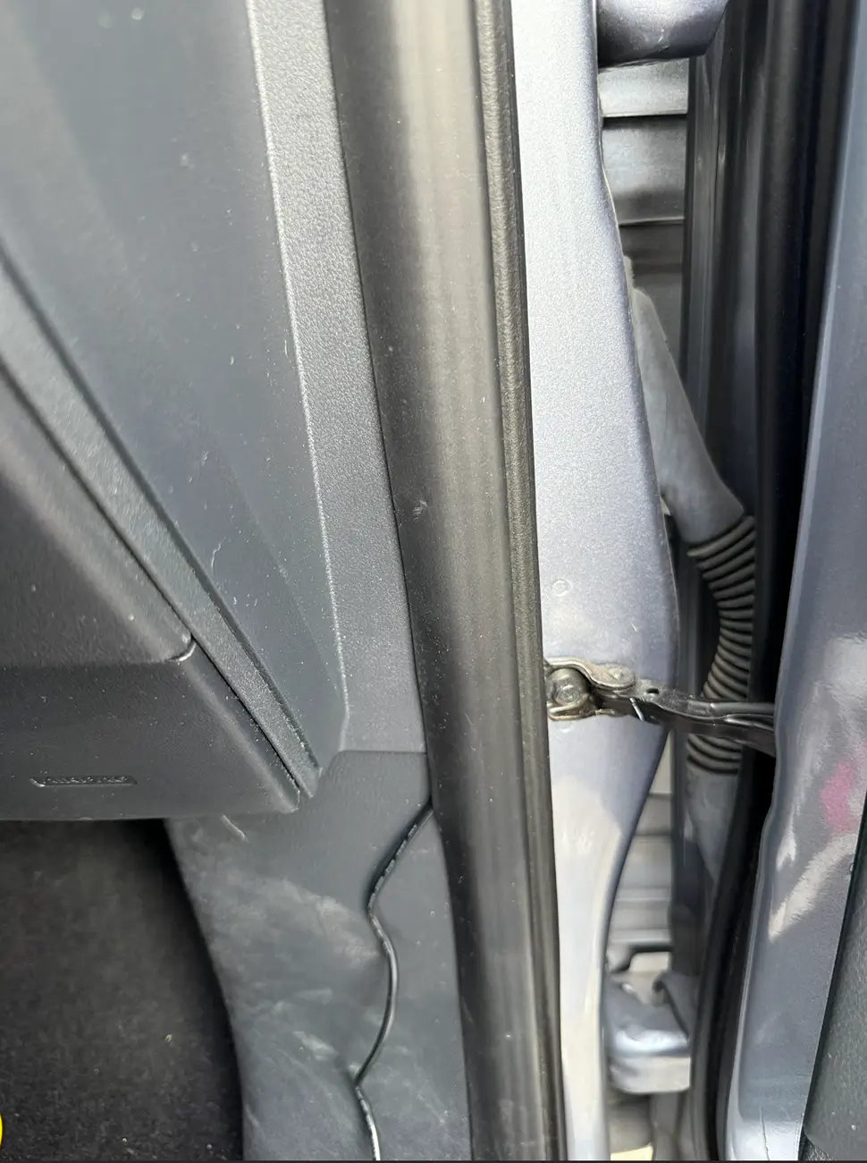

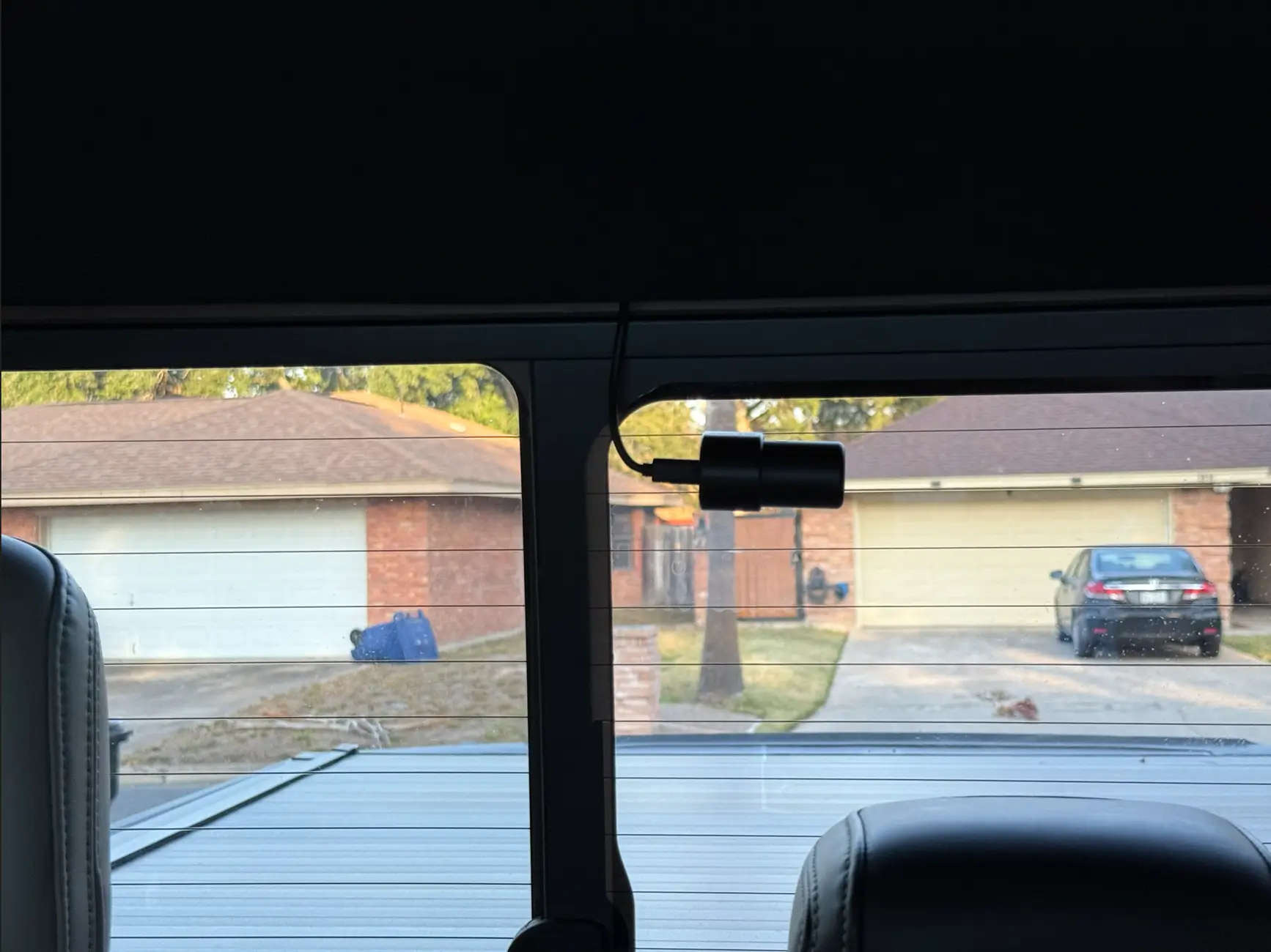

I went back to start on the rear camera. I read a couple of reviews warning that running it along the headboard could impede airbags, but I didn’t like the idea of wire coming up from the floor to the rear window, which is sliding, so I decided to go down the pillar, under plastic trim in the door frame where the rest of the wires run to the back seat, and then all the way to the corner behind the rear passenger seat, up the trim and then over to the rear window through the headliner, and then a short run down to the window itself. At first, I tried this with the shorter cable, but it was about 6” too short of being perfect, so I swapped it out for the extra long cable, rolled the excess and tucked it away with the voltage tester, and was ready to mount the cameras and wrap up the installation.
In my years of installing dash cams, I saw time and time again huge chunks of glass breaking off of the windshield when adhesive is used to mount these things and they need to be moved or removed. The adhesive is just that strong, so I was a bit apprehensive about this until I saw that they included some electrostatic clings to apply to the windshield first to prevent damage. Nice touch!
The clings however, are not without problems themselves. The material is VERY prone to creases, fingerprints, and general imperfections just by removing the plastic covering the adhesive, so if you’re the type to obsess about getting every last bubble and piece of lint out from under the screen protector on your phone, you’re gonna have a bad time here. It’s not so bad that it sticks out, but if you know to look for it, you’ll have no trouble spotting it.
The other problem is that they are huge and are large enough to potentially block the camera’s view of the road and impair the image quality, especially with scratches and bubbles present. My first inkling was to trim them, but in case they work like drywall anchors by using the entire surface area of the cling to hold the weight of the camera up, I decided to just make sure to position the cling high enough that it would not obstruct the view, which was more challenging on the rear camera, where I positioned it to the left of the lens since there was just not enough space to do it any other way.
Once they were up, I plugged everything in, and powered on the truck. The camera powered up instantly and I began cleaning up so I could take it for a spin.
Final installation looks like this:
Very happy with the final product as its mostly unnoticeable.

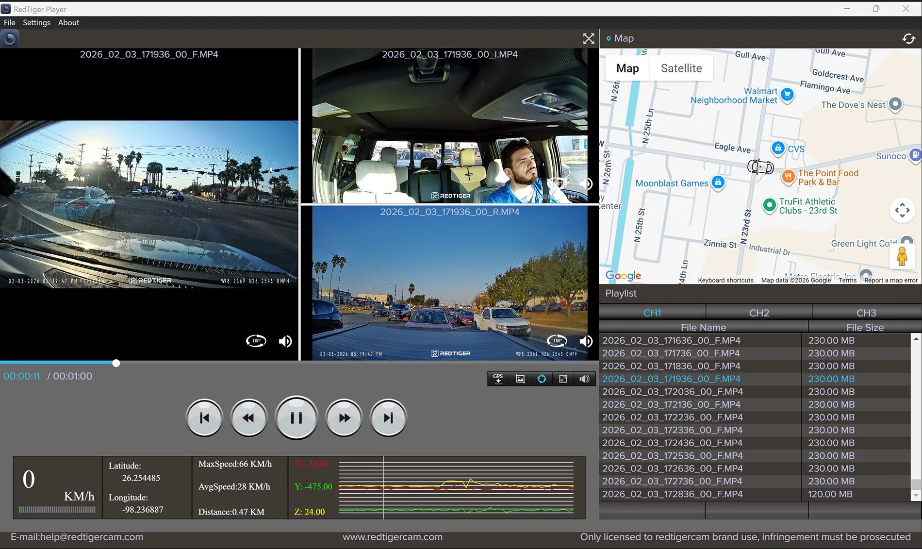

The PC software does make it easier to sort through lots of videos, and once you open the exported folders it gives you the ability to see all 3 cameras at once and automatically syncs them, along with a map just as shown in the app, which is pretty cool! Like the app though, this appears to be an off the shelf software, and seeing some questionable English and menu names in the app sorta made me wish I hadn’t installed it, but nothing overtly wrong with the app and I didn’t experience any bugs while using it.
Despite the drawbacks, there were no crashes at all, and I was able to find everything I was looking for. it works well enough and unless something crazy happens on the road, I would seldom use the software, so the drawbacks are not even close to dealbreaker territory for me.

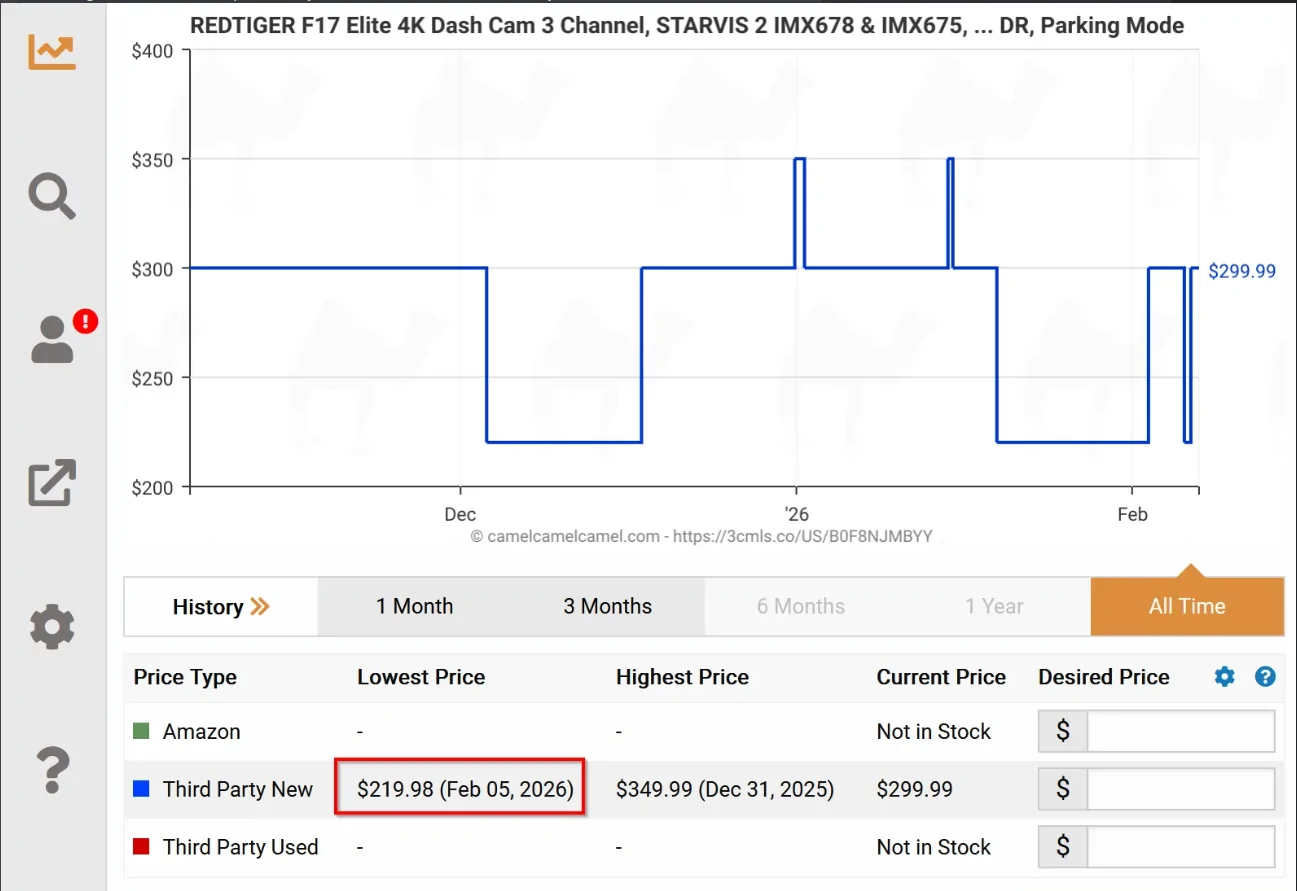

Looking at Camelizer for the price history on Amazon shows that it’s routinely available for around $219:
