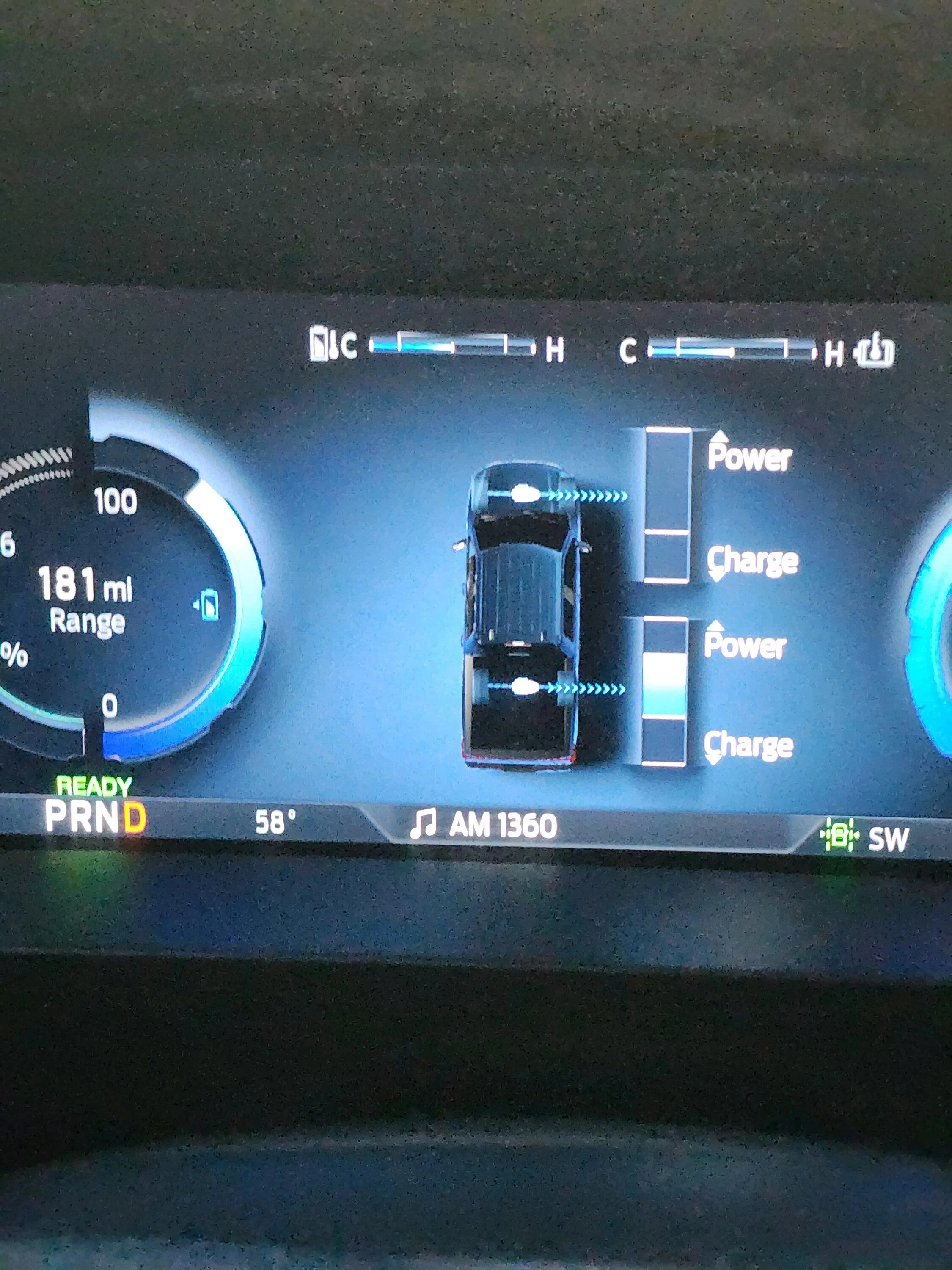

The next time that anyone encounters this, ideally while it still shows you have reduced power, please go into the sync menu and submit voice feedback. Please state as clearly as possible what has happened and what you were doing. This sends a short data log along with the voice recording and that data may be the key to getting this figured out
My truck reduced power to 56% on one trip. I shut down and restarted and it went back to 100%.
One interesting thing I noticed. I had a hunch to check the energy usage display and it showed that the front axle motor was not moving the truck nor was it recharging the battery, also the front axle seems to contribute 44% of the total drive power.
I had come home to work on the yard and left after charging for 2 or so hours during the day with 32amp mobile charger.
I'm in San Diego so the cold had nothing to do with it.
Has this happened to anyone else?

Mine did the same thing yesterday morning, as soon as I turned off truck and started again it was normal and hasn't happened again..I don't think anyone has got an official answer why this happens

Strange thing is the front motor not working. It's like a solenoid got stuck... of that's even possible.

This happened to me this weekend. I had the truck on the portable charger for several hours. Headed out and the power was limited to 56%. Went to dinner for 90min or so, came out and full power was back. Yesterday, no issues and back to 100% available power. Weird.
