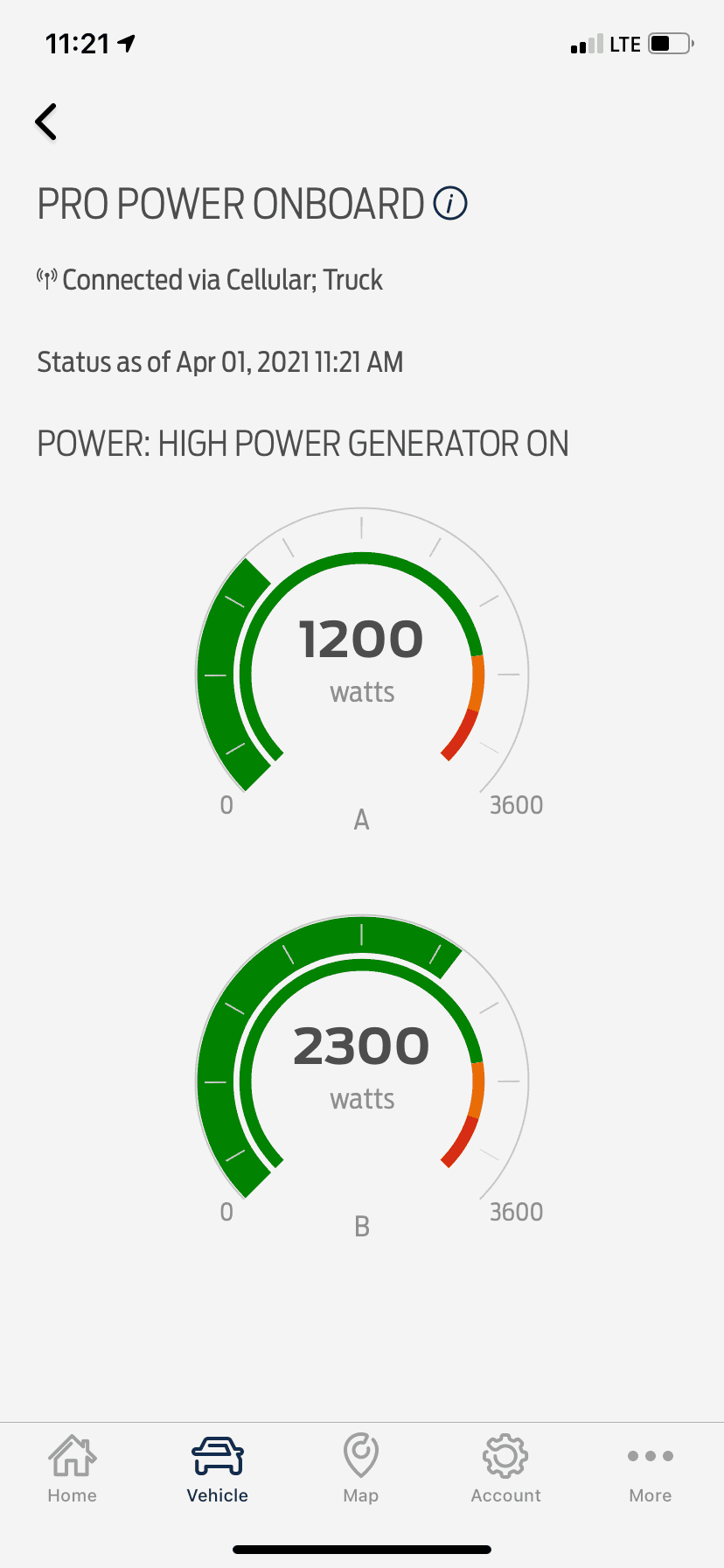

Without a link to dog bones you are using, it's hard to help.Ok, I did some more research, and think I answered my own question. I ordered one of these 30 to 50 amp dog bones. I think that’s what I need to run both AC units off the trucks 30 amp bed connection
Assume you are saying your 2nd A/C unit can be plugged/powered separately from the 1st A/C unit (i.e they are not both powered from the single power cord for the trailer/RV/toy hauler).
For RV usage, your are using 120V. From the 30A/240V 4 pin connector you can get 30A/120V (3.6KW) from each side (A and B).
So if you want to power the 2nd A/C unit you need to use the "other" 30A/120V side.
You do this by getting a connector (dog bone) that brings out both sides from the truck connector (i.e. the dog bone is a splitter that ends in two separate plugs).
