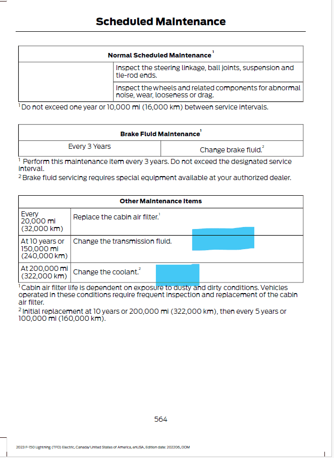

2023 Owners manual
Ford F-150 Lightning Required Dealer Service 1715563750976-p4

@Ford Motor Company - You need to make a correction to the MY2022 owners manual so that everyone knows to change the coolant at the 10 year or 200K mile mark and then every 5 years or 100 K miles there after. This important information was omitted from the MY2022 owners manual.
Thank you to @TaxmanHog for bringing this to our attention.

There is another difference between the 2022/2023 Owner's Manual PDF and everything you see on FordPass or your online Ford account. PDF shows changing brake fluid every 3 years. It's not mileage based like all the items on FordPass/Ford Account.
Ya, when I would take my 06 Taco In for service they would take a sample of my brake fluid, and occasionally recommend a flush
