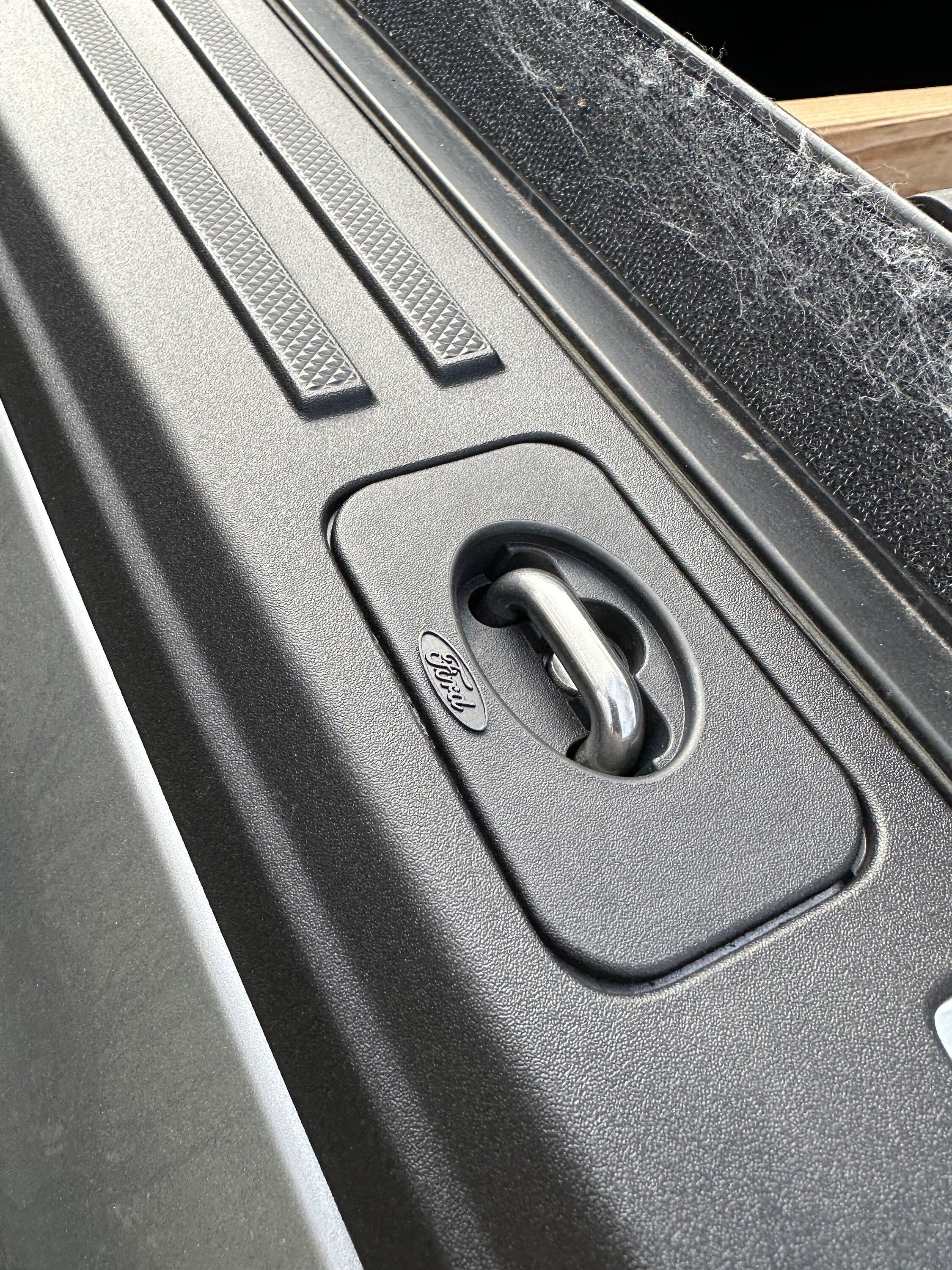

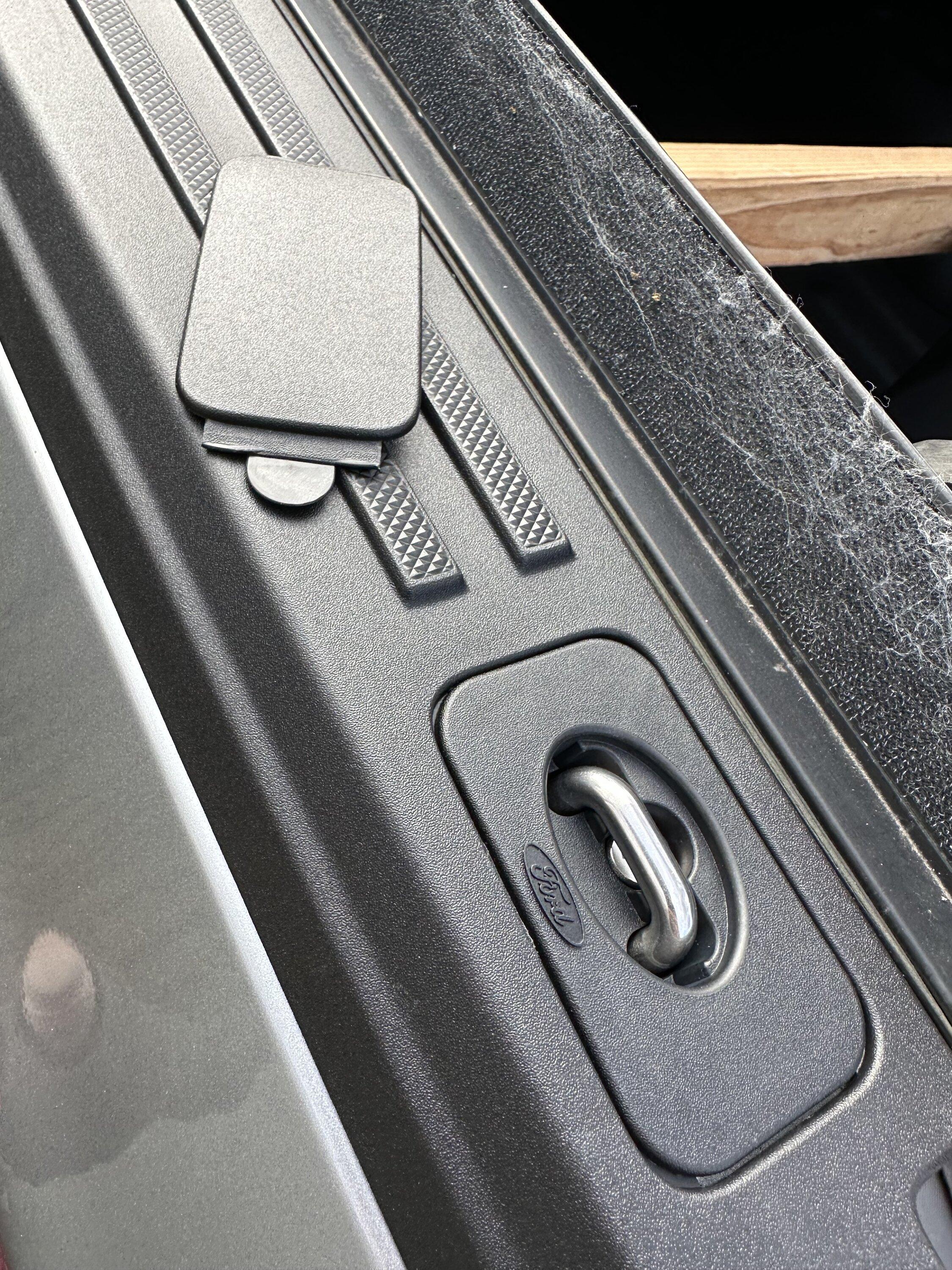

Hi,

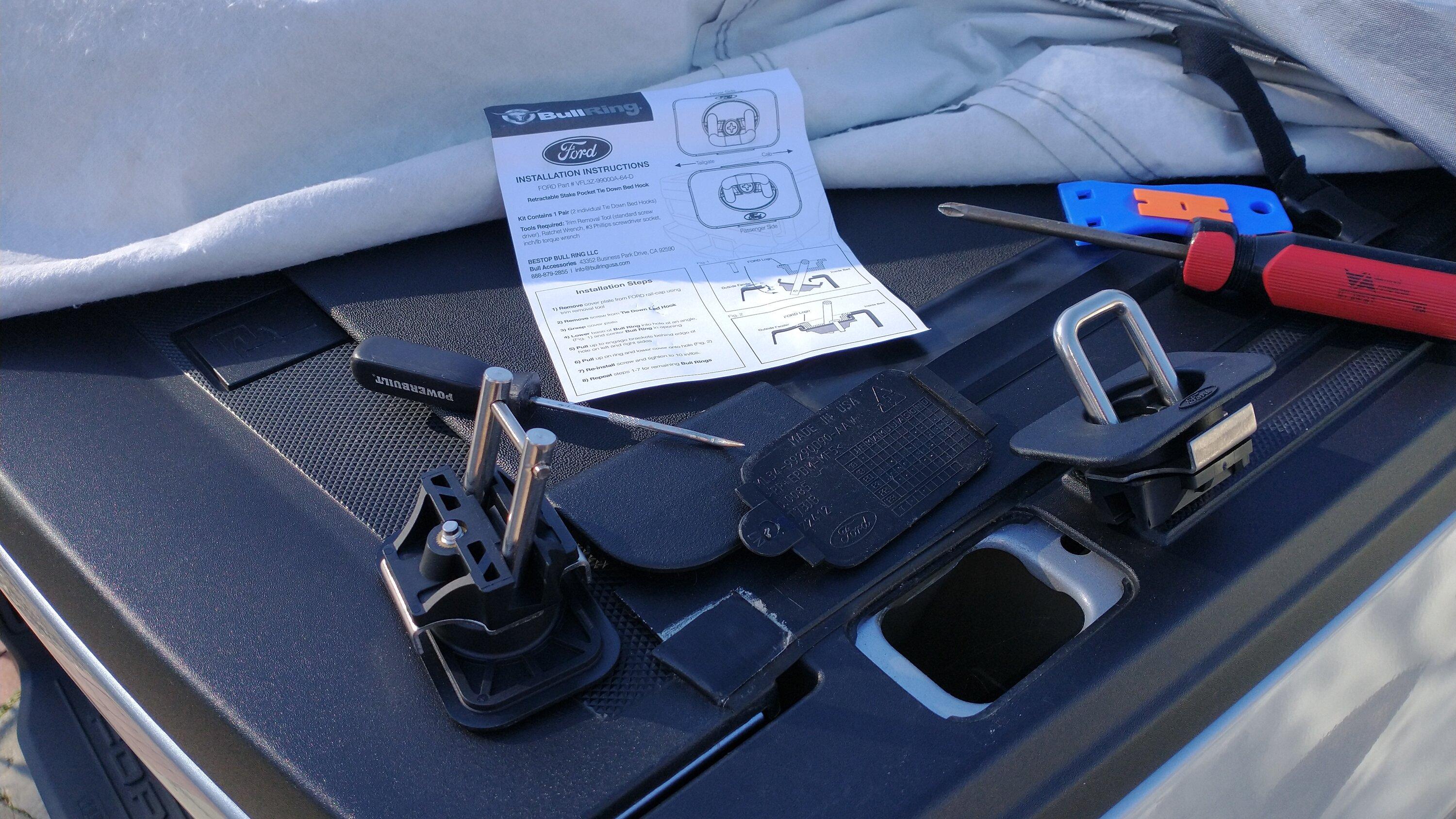

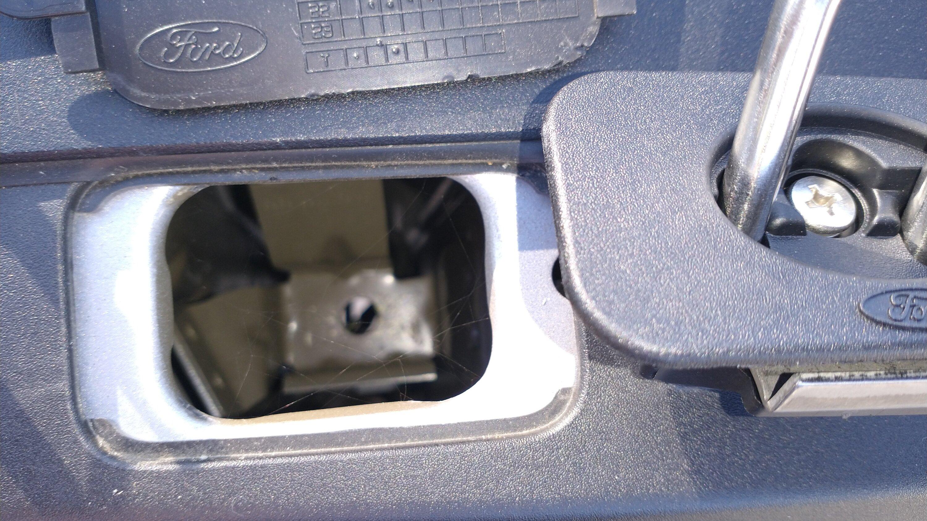

Super simple installation just like any other F-150. Pry the blank plastic plate out from the side using a trim removal tool or flat head screwdriver - (removed plate is shown in the second picture below). Then drop in the bullring assembly and tighten the screw to clamp in place. Takes like one min per side. Part number is VFL3Z-99000A64-D
I did the version with the Ford logo and Ford part number that I bought from a Ford parts dealer online. These were a little different than the ones I had bought previously directly from Bull Ring in that they seemed to be updated. Only had one screw to clamp down and have a hook that is angled towards the bed when extended, instead of straight vertical. Both are improvements.

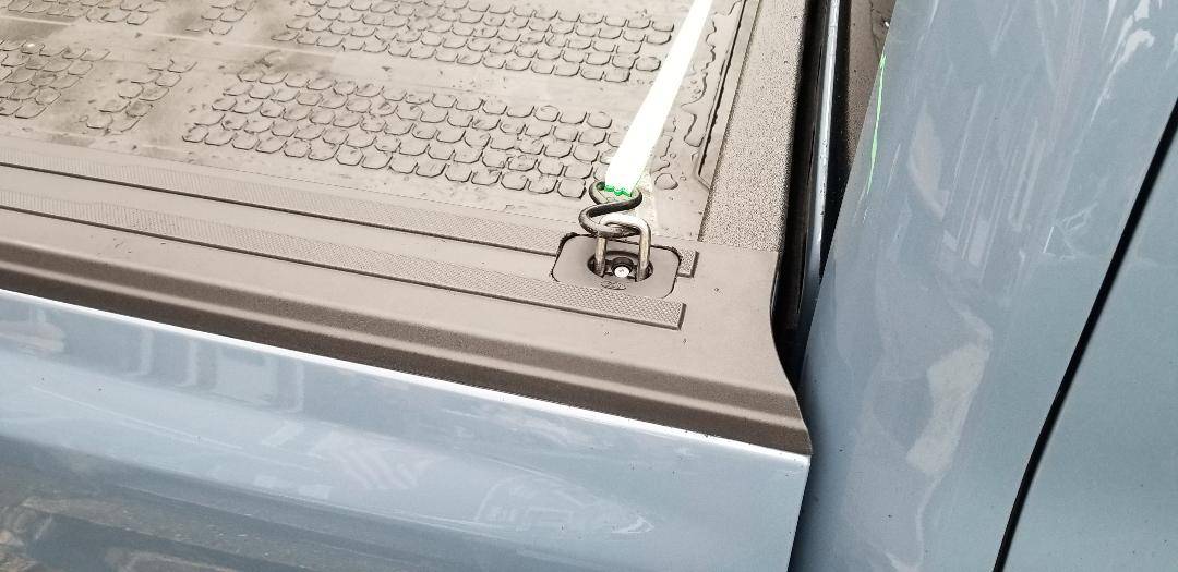

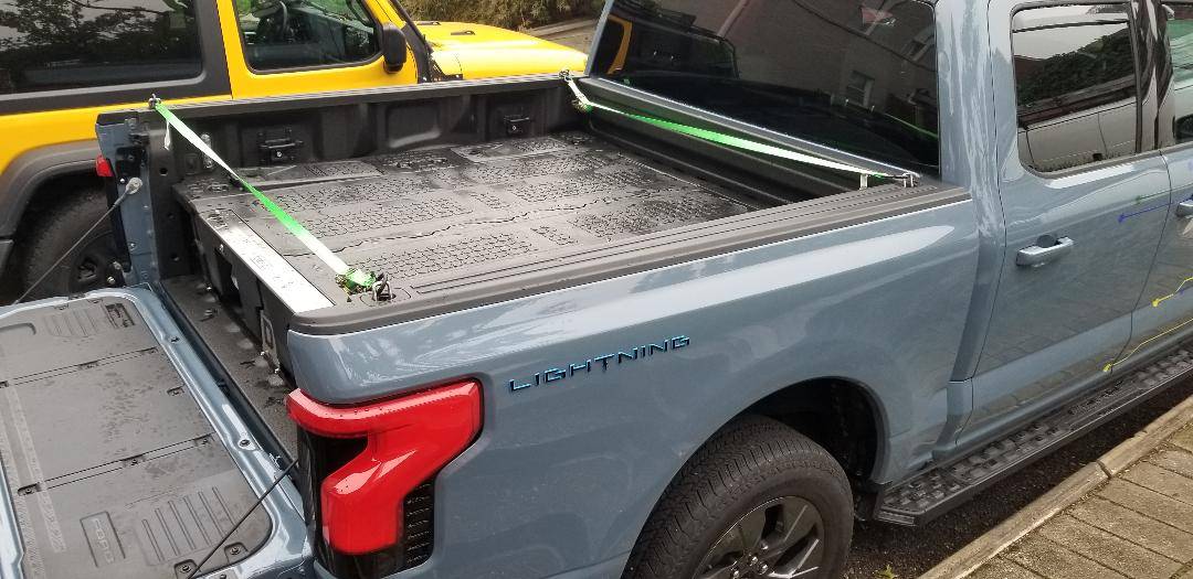

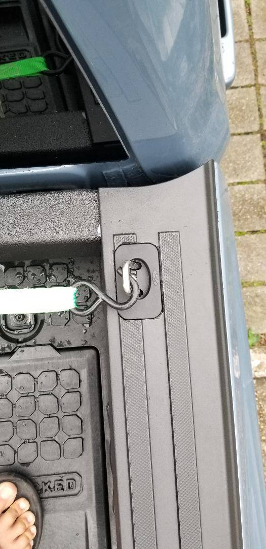

Purchased with FordPass points. Instructions seemed to be wrong showing tipping in the bed side before the fender side - easier to reverse that. There is also a little challenge getting the phillips tensioning screw into its threads.

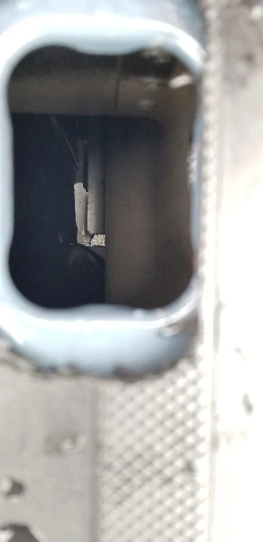

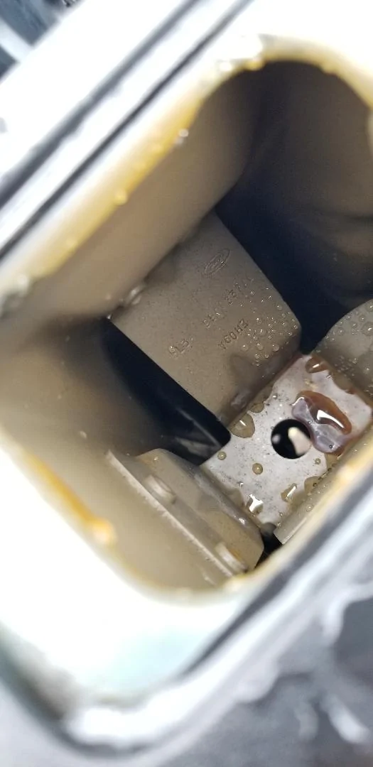

1. Inner guts of the rear stake pocket. You can clearly see the "pocket" for a wooden stake, etc.
2. Inner guts, or lack of any, for the front stake pocket. The opening goes straight down to the pavement, which can be seen. However, both rear and front pockets' lips have the curled-down flange edges appropriate for these Ford accessory angled bull rings to grab onto. Note: to lessen any galvanic reactions between differing metals, I inserted pieces of a vinyl V-Flex window seal strip I had laying around between the bull ring clamp flanges and these bed stake pocket flanges.

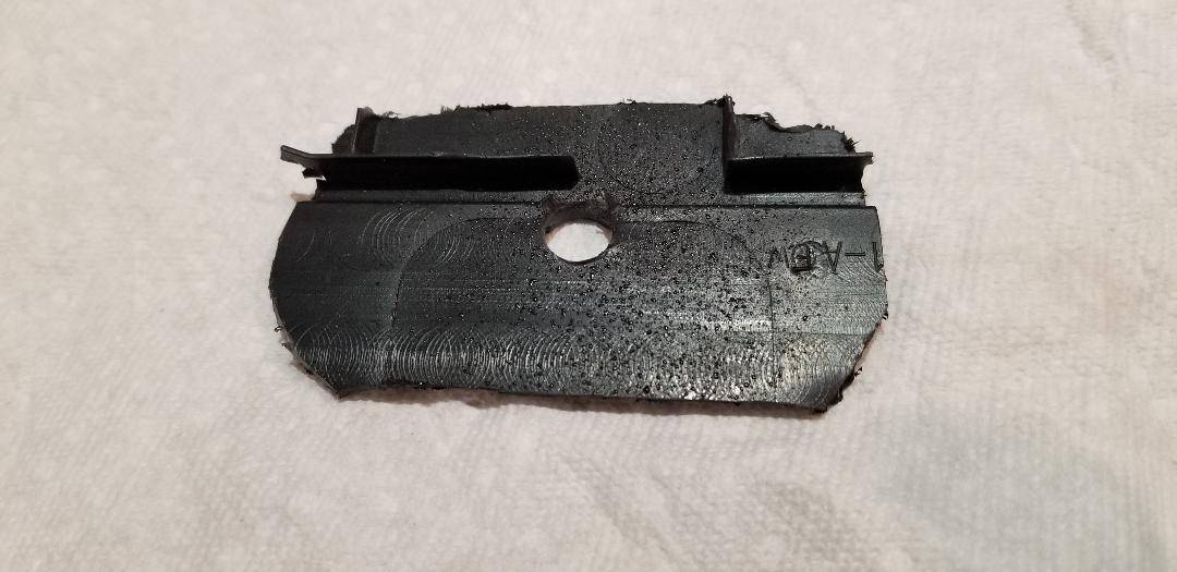

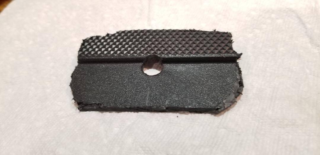

6. Shot of the removed front stake pocket trim... the centered hole aids in removal.
7. Shot of the underside of this removed front stake pocket cover. Note the thin vertical stiffening ribs... these need the most care with a knife to cut through as their edges rest on metal.
