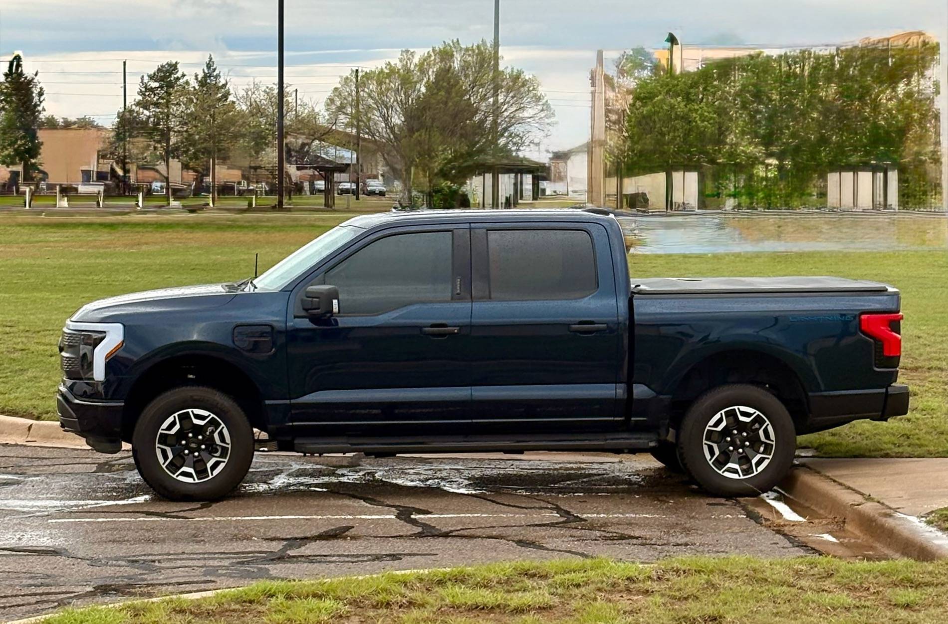

I just did the 2” RC level kit in front, kept stock in back with same 18” rims and tires.
Ford F-150 Lightning Rough Country 3" level on Toyo AT3 EV tires 1745328239839-oh
Rides the same.
Sorry to hear yours is riding rough now, maybe the aggressive tire?

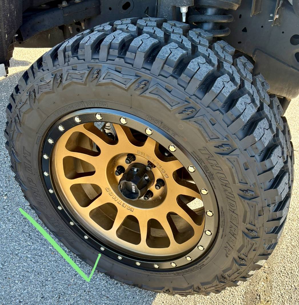

Thought of going with 33’s with new bronze rim but now might think it over.
Ford F-150 Lightning Rough Country 3" level on Toyo AT3 EV tires 1745328364060-cn
Let us know if you figure how to smooth it out.
