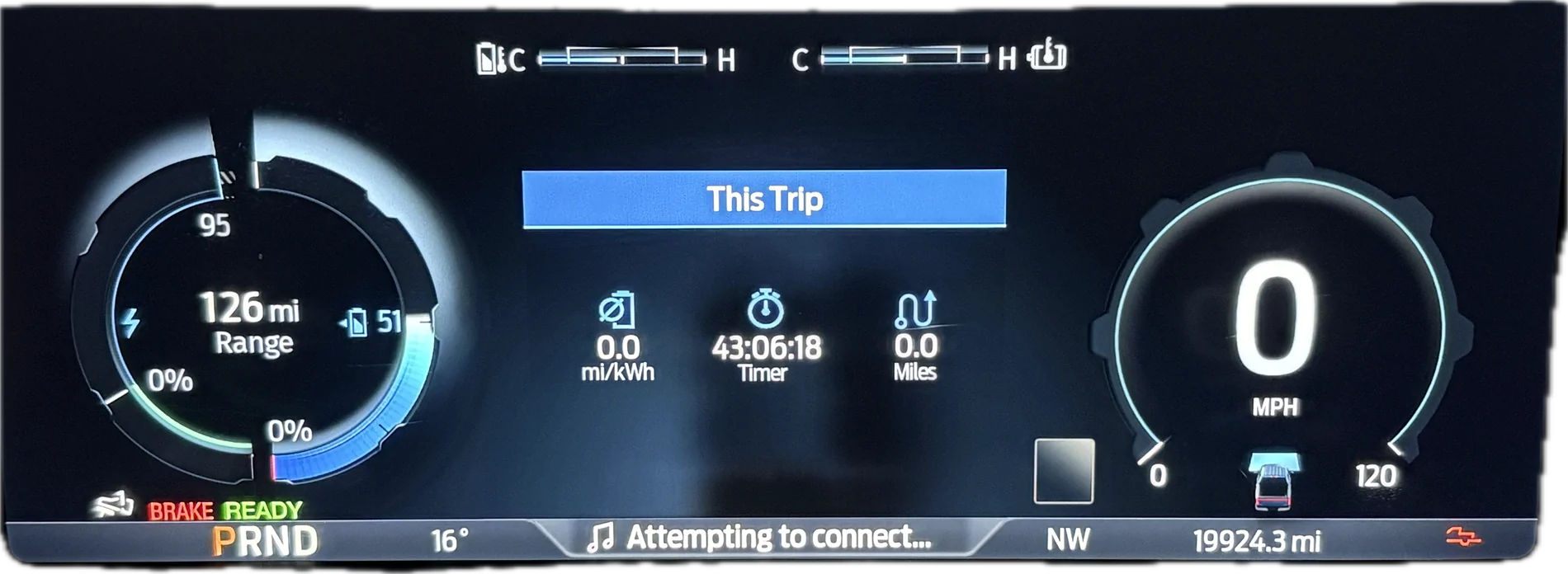

Power just came back on 2:28pm cst.
Ruby had power to spare after 3 1/2 days of running things.
So based on my experience (for our use case) we could easily get 4-4 1/2 days of comfort on the PPOB with enough to left over to get the nearest DCFC if additional days were required.
Bottom line all is good and we are ready for the next big one.
That might sound a little too dramatic, but this is hopefully a once in a lifetime experience.
I am writing from Southern Kentucky on January 28th, 2026. We are currently in our fourth day without power following Winter Storm Fern, one of the worst snow and ice storms in the U.S. in over two decades.
Fortunately, we had ample warning and were well-prepared. I had both my F-150 Lightning and my wife’s Kia EV6 fully charged. I also managed to install an interlock and generator plug on the house just as the snow began to accumulate. When the power failed at 11:45 a.m. on January 25th, I successfully switched the house over to the Lightning.
To conserve energy, we have closed off unused upstairs areas and shut down the electric water heater. Since our furnace and range are gas-powered, they require very little electricity to operate, allowing our other appliances to function normally.
As of this morning, the truck is at a 50% state of charge. This should last until tomorrow or Friday. At that point, I will either drive 20 miles to a DC fast charger or use a borrowed generator to recharge. I am leaning toward the fast charger given how long it would take to recharge using the mobile EVSE.

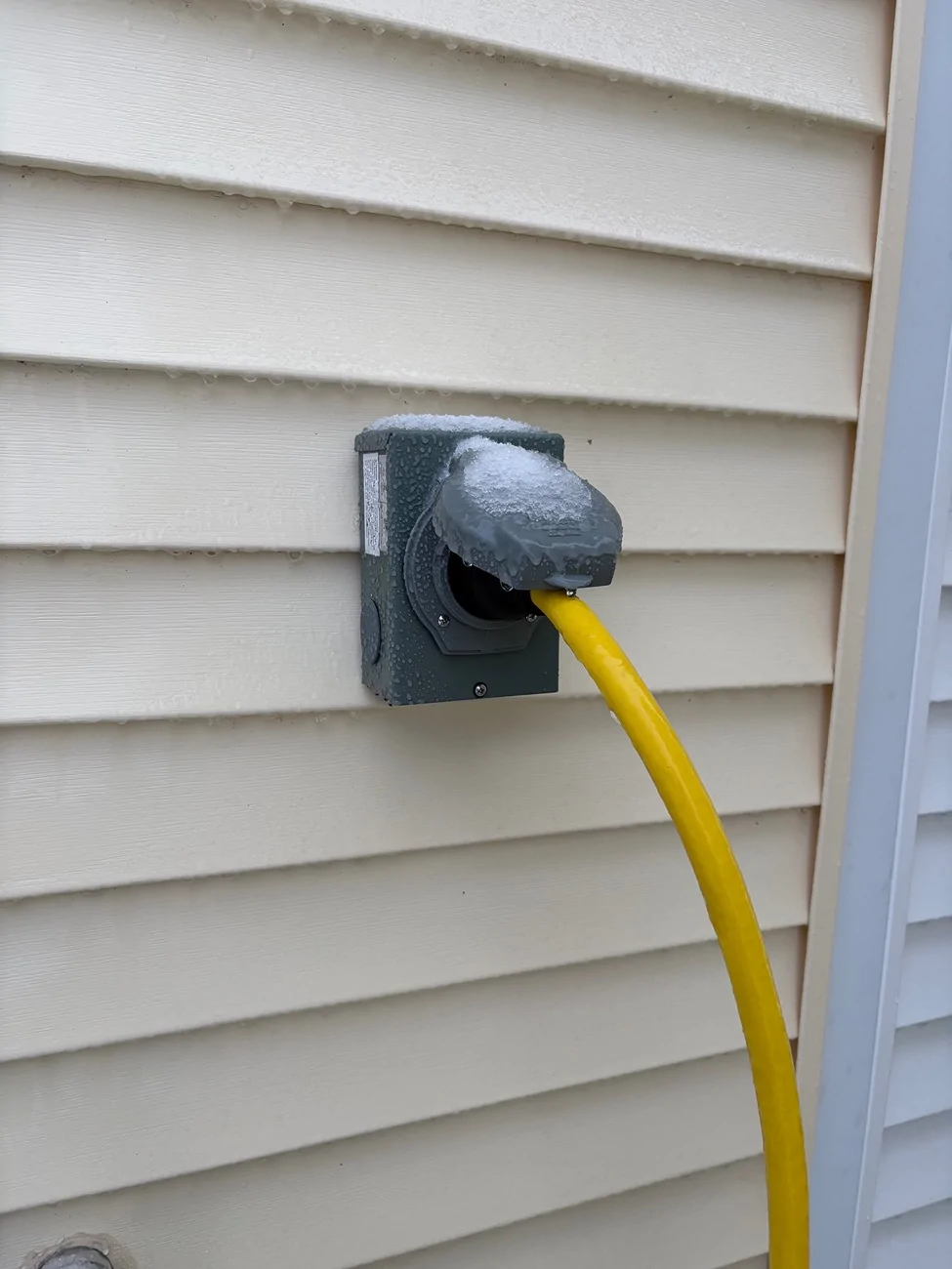

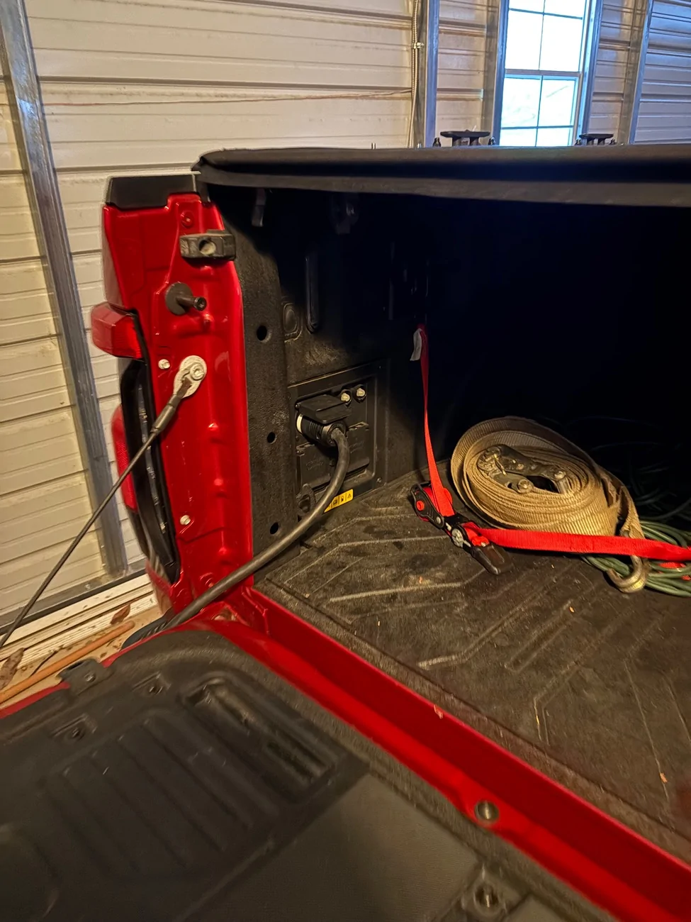

The truck is running everything we need and only drawing between 450-900w. Thank GOD we just replaced our aging package heating system with a new more modern and efficient unit last month.

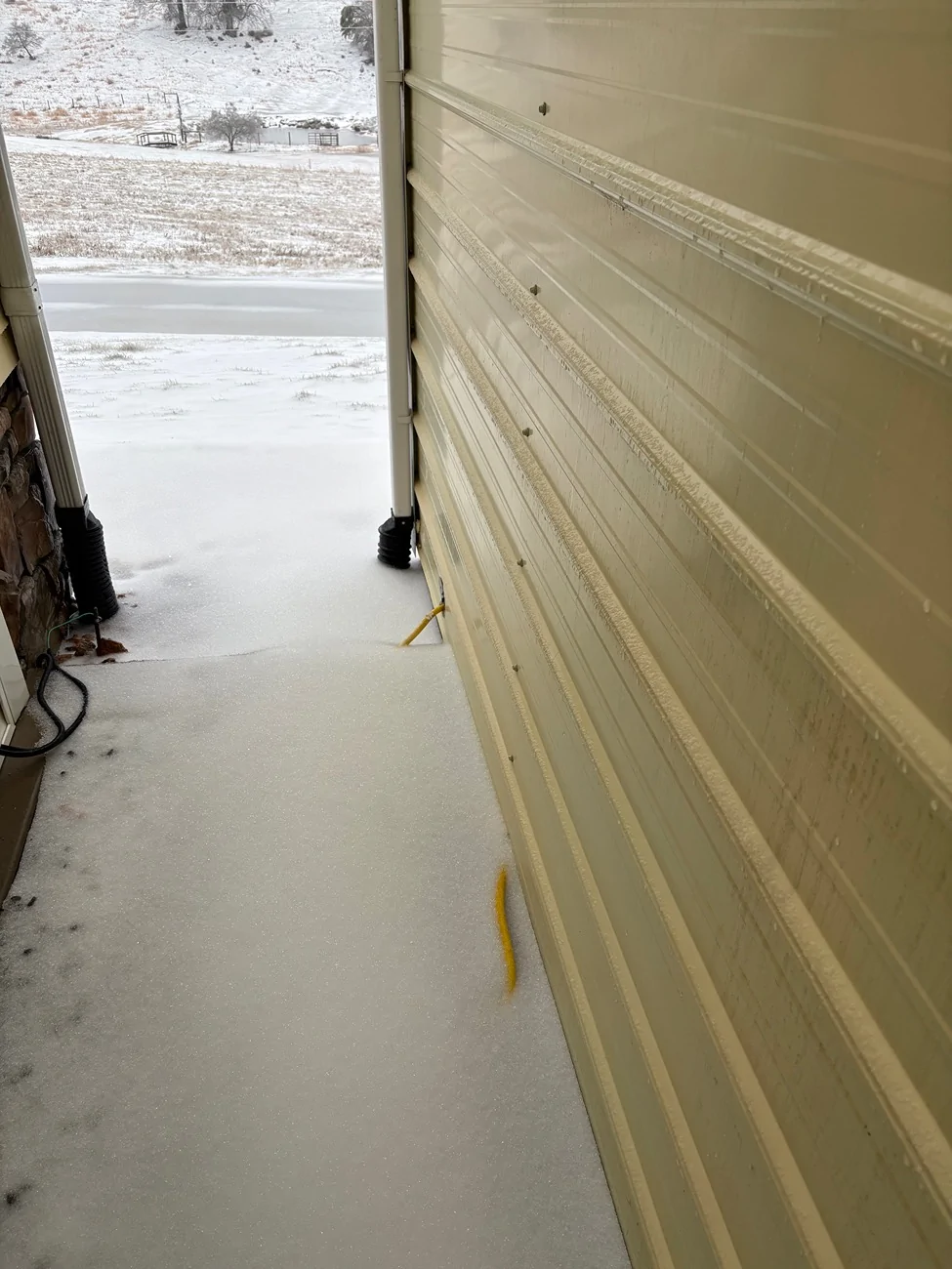

Well here we go. The snow came and went and the sleet and freezing rain has moved in.
power has fluctuated a few times this morning and my go at any time now.
Not to worry the Lightning is wired and ready to stand in. 🤞
