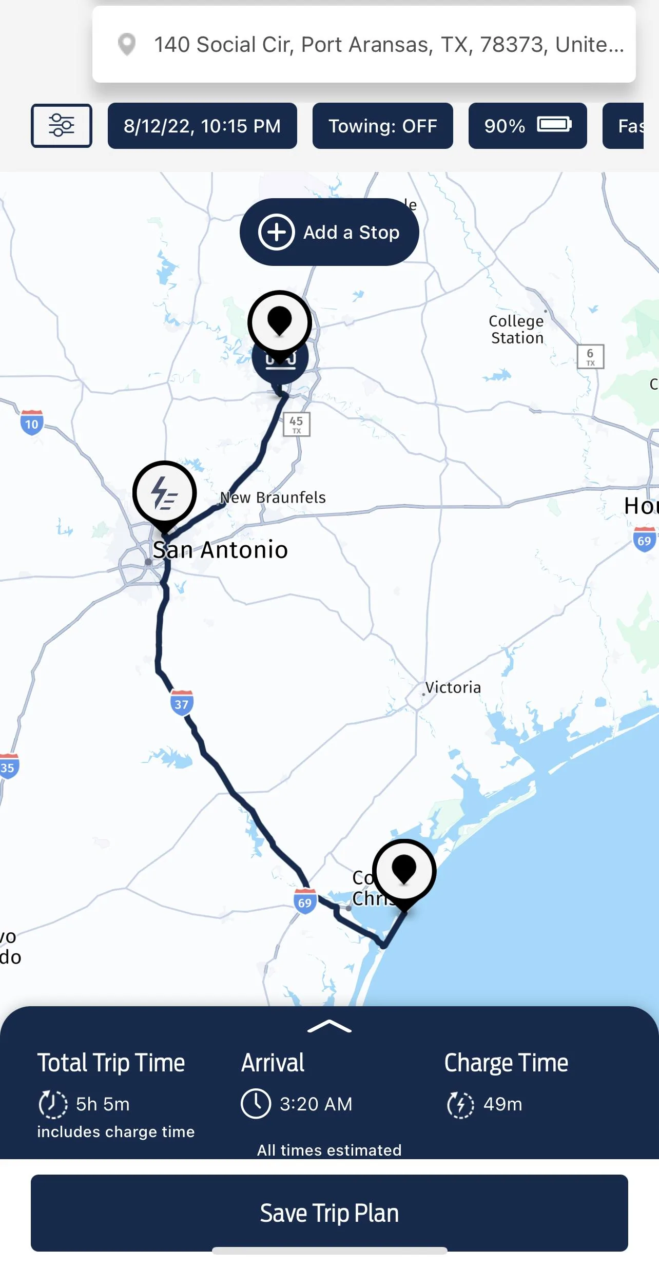

FordPass Planning:
FordPass, regardless of whether I start at 85% SoC or 100% SoC, sends me through San Antonio to an in-network charging station for a pretty substantive charge:
Presumably, FordPass is presently sandbagging my mileage given my average driving habits to date, which include no highway driving but high climate usage (getting in and out of a 120 degree truck for short burst drives).

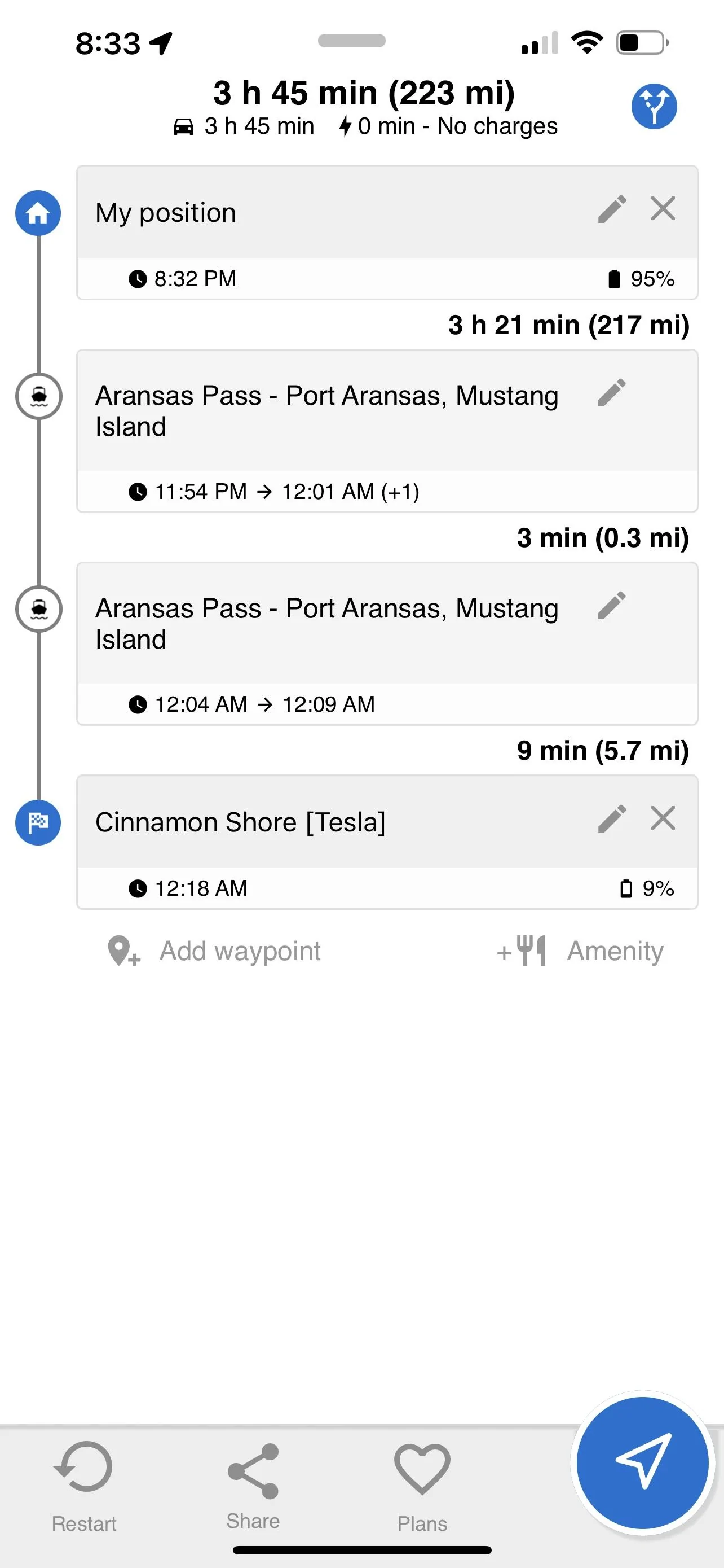

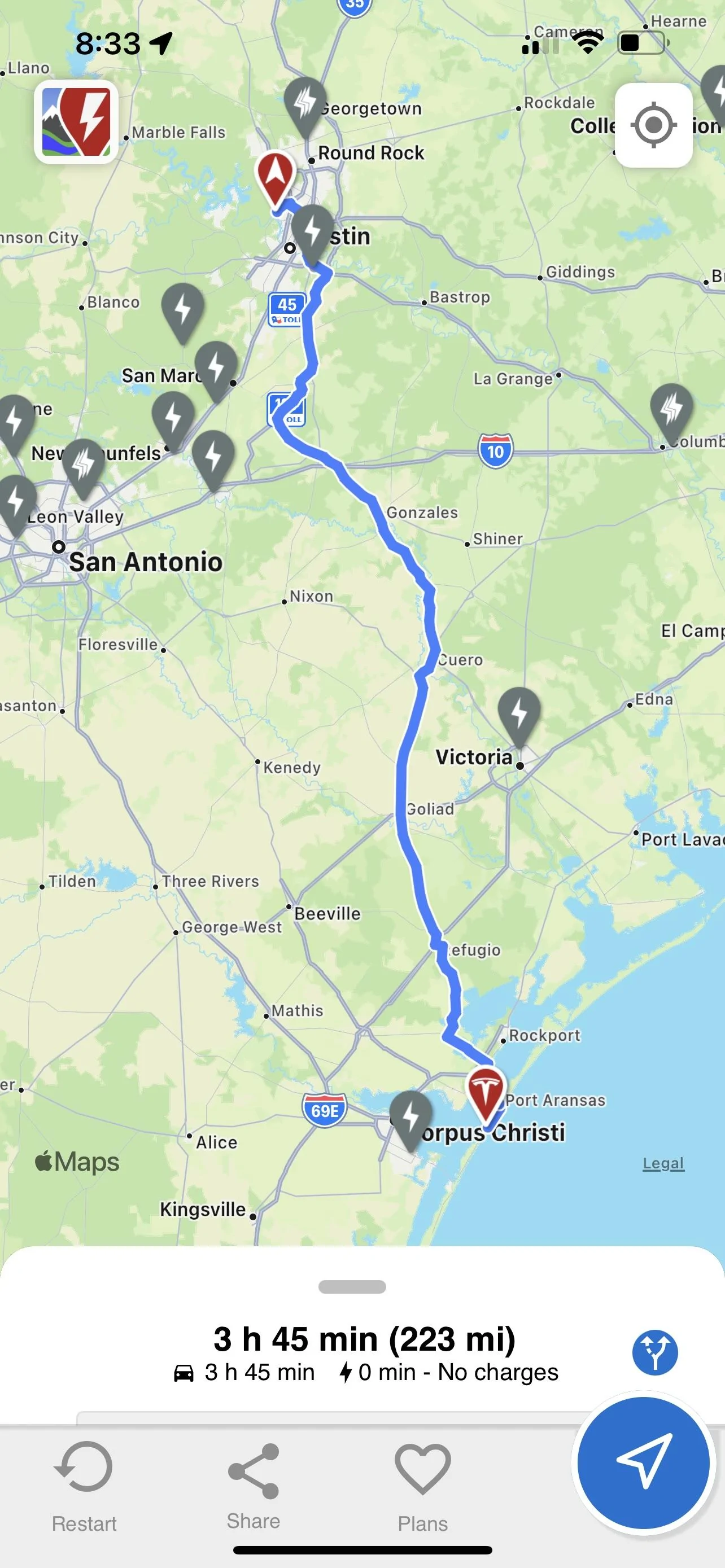

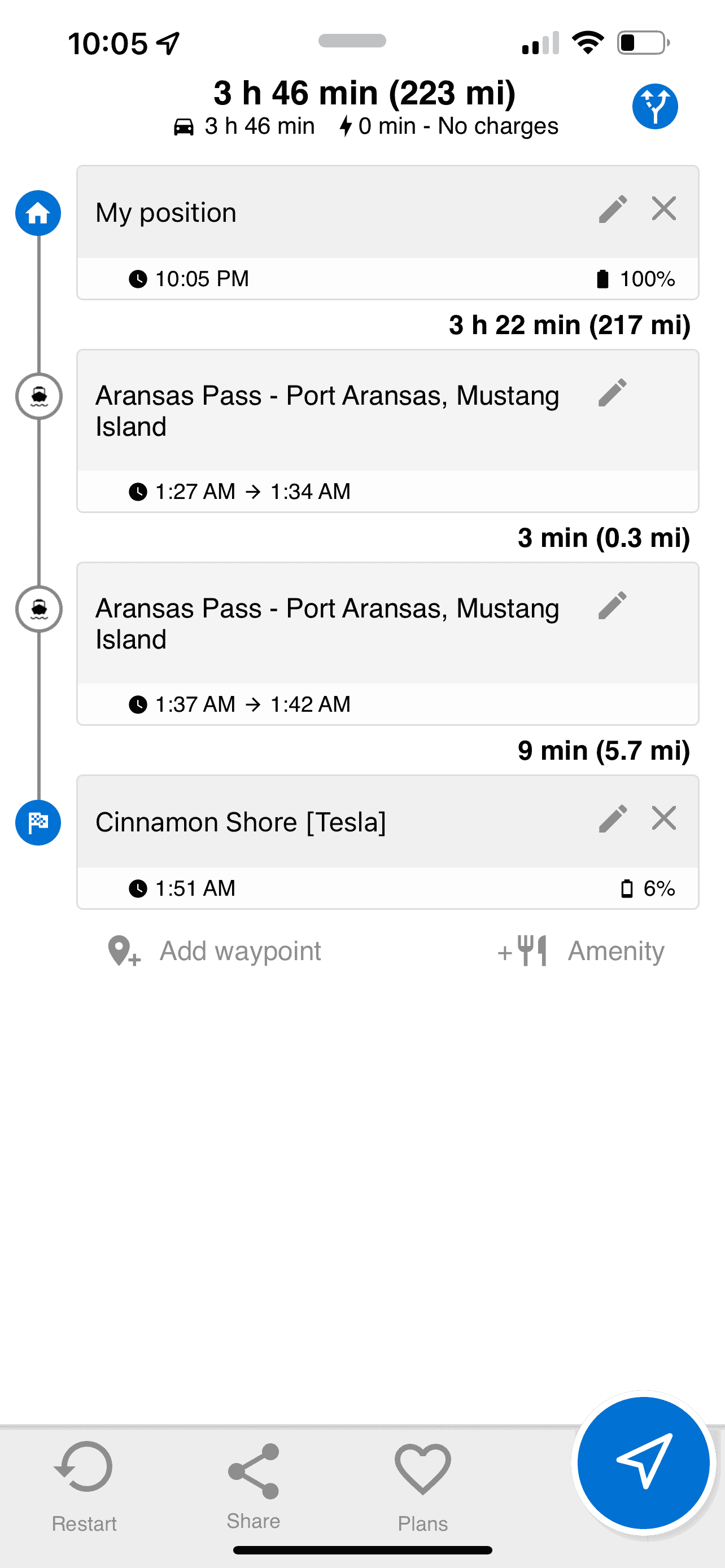

Conversely, ABRP tells me basically to just go for it

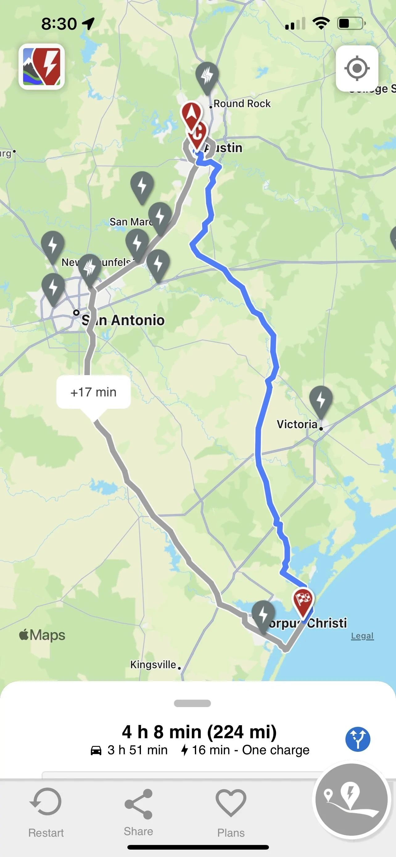

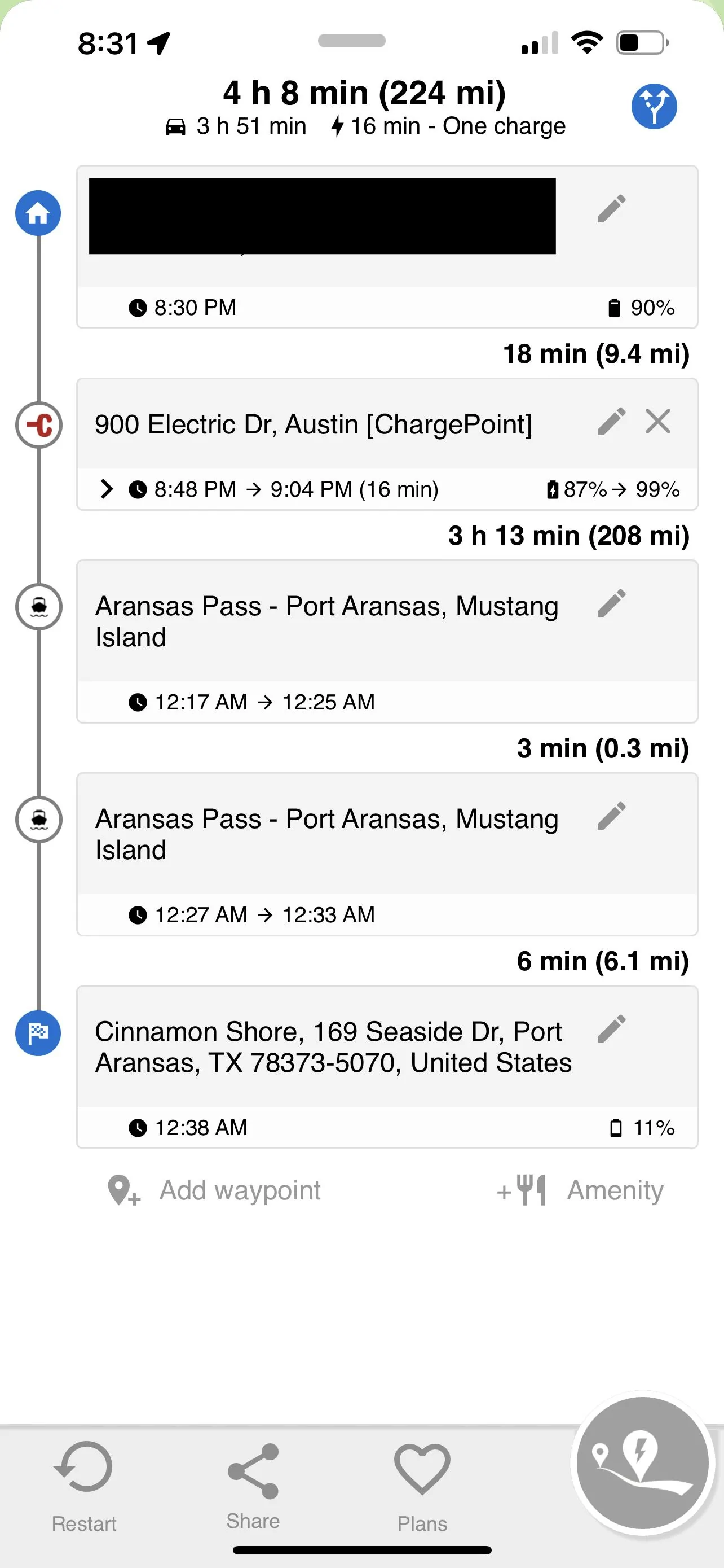

If I instead start with 90% charge, ABRP has me go into just 9 miles to downtown Austin mid-day (not great) for a ~15min top-off
That 15min top-off downtown is a rather annoying addition, and I’d rather just ensure I start at 95-100% and avoid the detour.

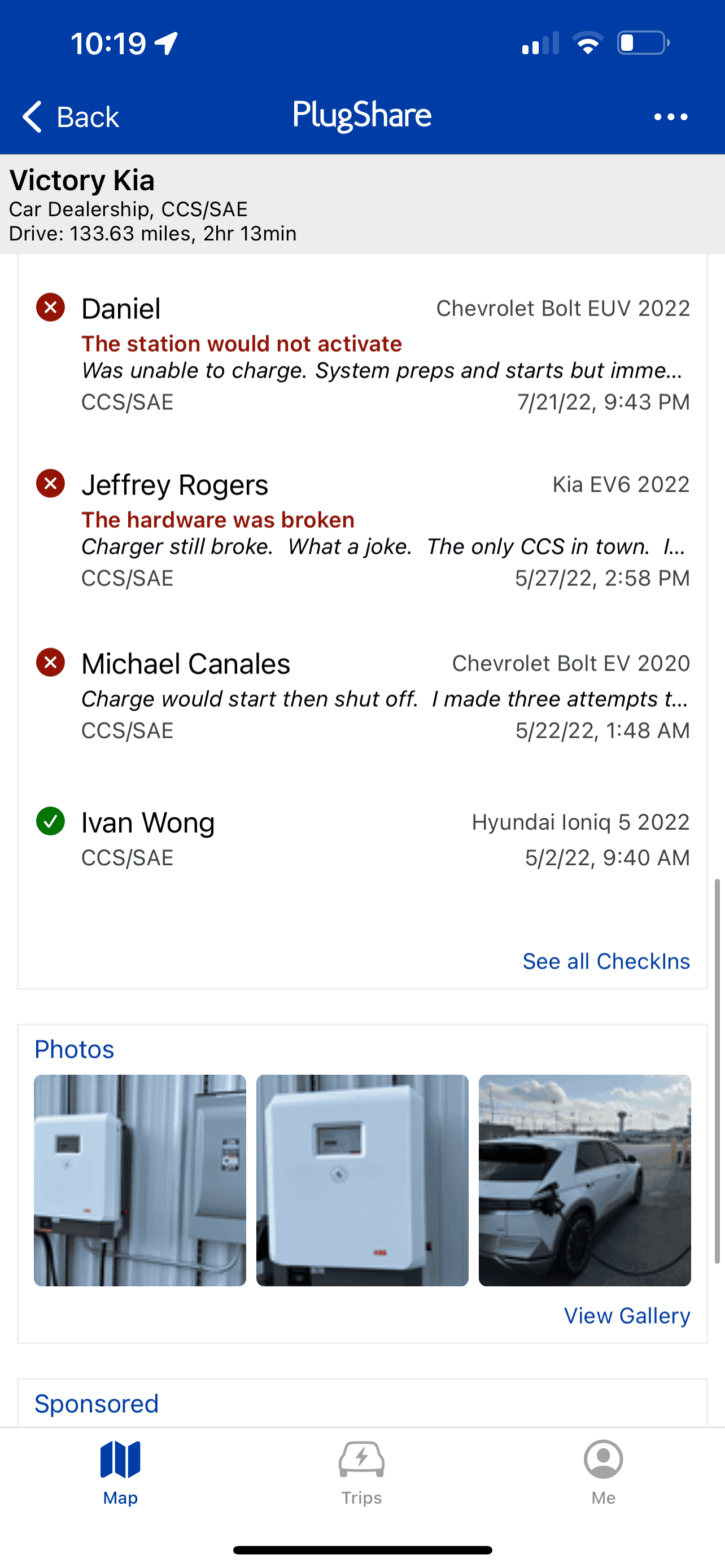

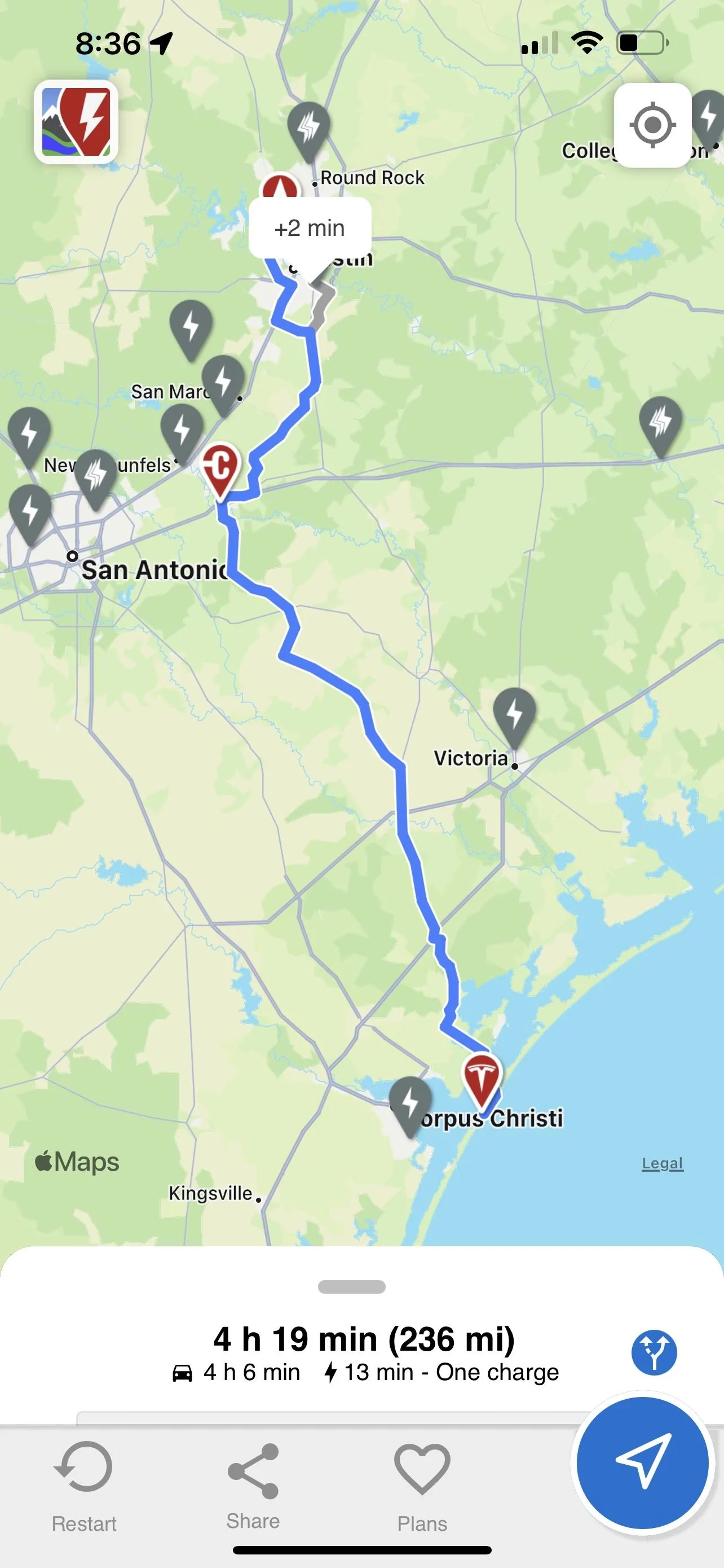

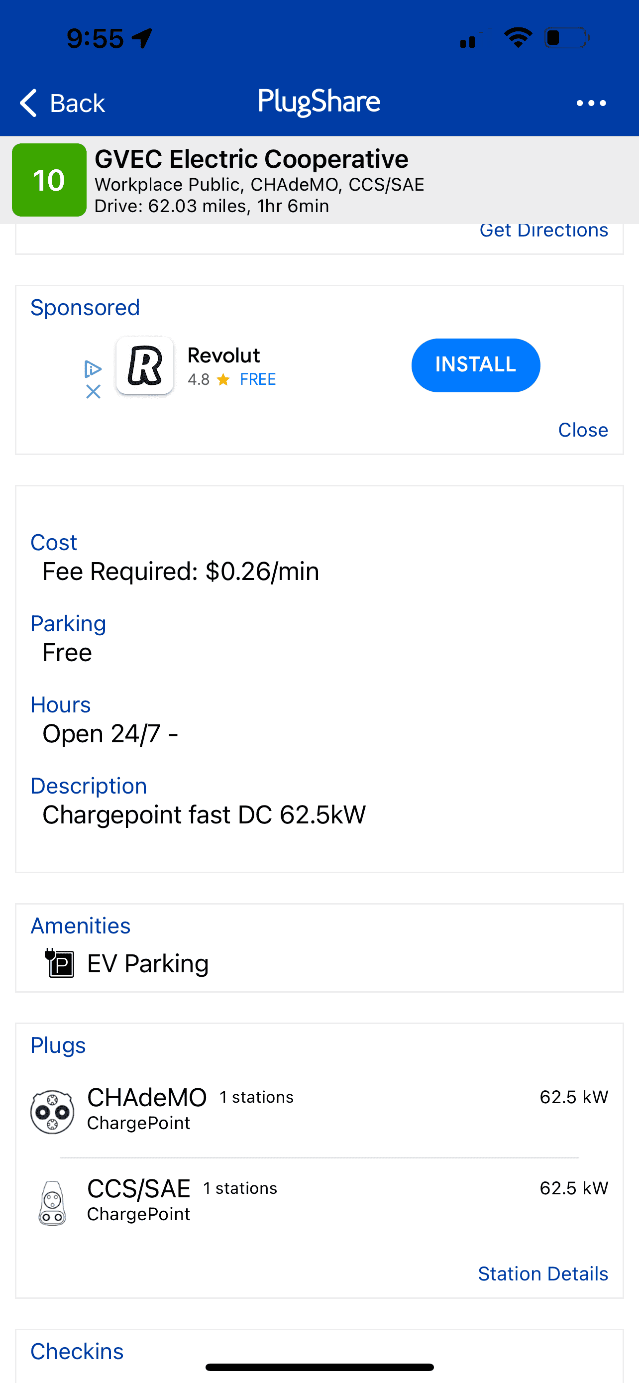

That said, a member here has pointed out a DC charging station further east of San Antonio, which I can force into ABRP as a safety-net version of the trip:
Of the options above, my resulting question is: would prudence suggest that the ABRP “go for it” plan (no charging) is fully sufficient, or instead too aggressive given the context. If too aggressive, then the forced stop east of San Antonio would be the default.
