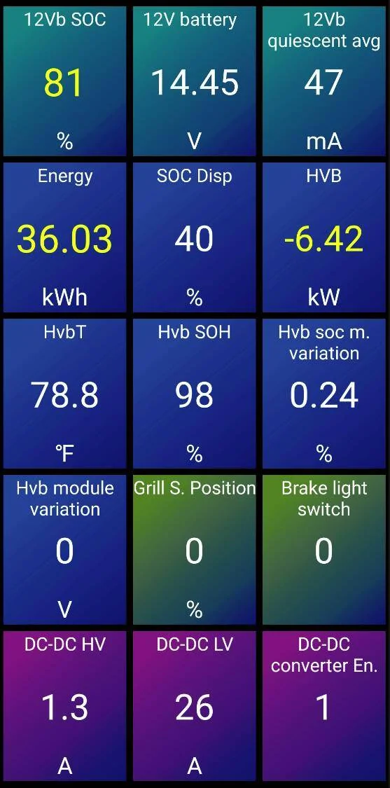

You can see your SOC in FordPass so you can see how much juice you are losing. But if you need more accuracy, you can use an ODBII reader and car scanner APP to see exact draw from your battery and the history of consumption.
Didn’t realize I could access that info via CarScanner. Will try that
You get current, Voltage and power in different locations in the truck. And you can get a graph for any sensor you are looking at over time.
Here are couple of pages I have setup for different purposes but there is a lot more info depending on what you want to monitor.

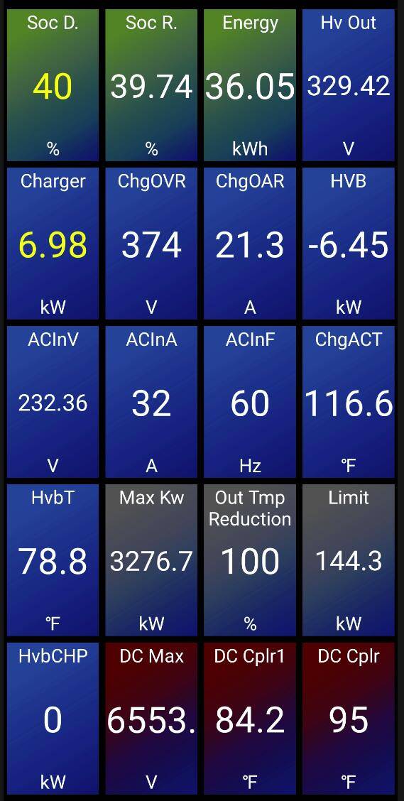

This is my default screen. As you can see, there is two decimal point for juice coming out of the battery live (in this case going in).
Ford F-150 Lightning See Pro Power Usage Outside of Truck? 1737493968352-hg
I look at this when I am charging:
Ford F-150 Lightning See Pro Power Usage Outside of Truck? 1737494092766-iz

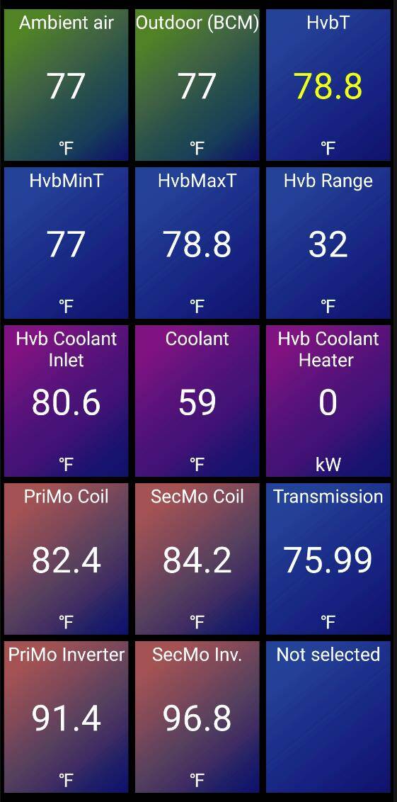

I look at this when I have temp concerns:
Ford F-150 Lightning See Pro Power Usage Outside of Truck? 1737494162505-pt
