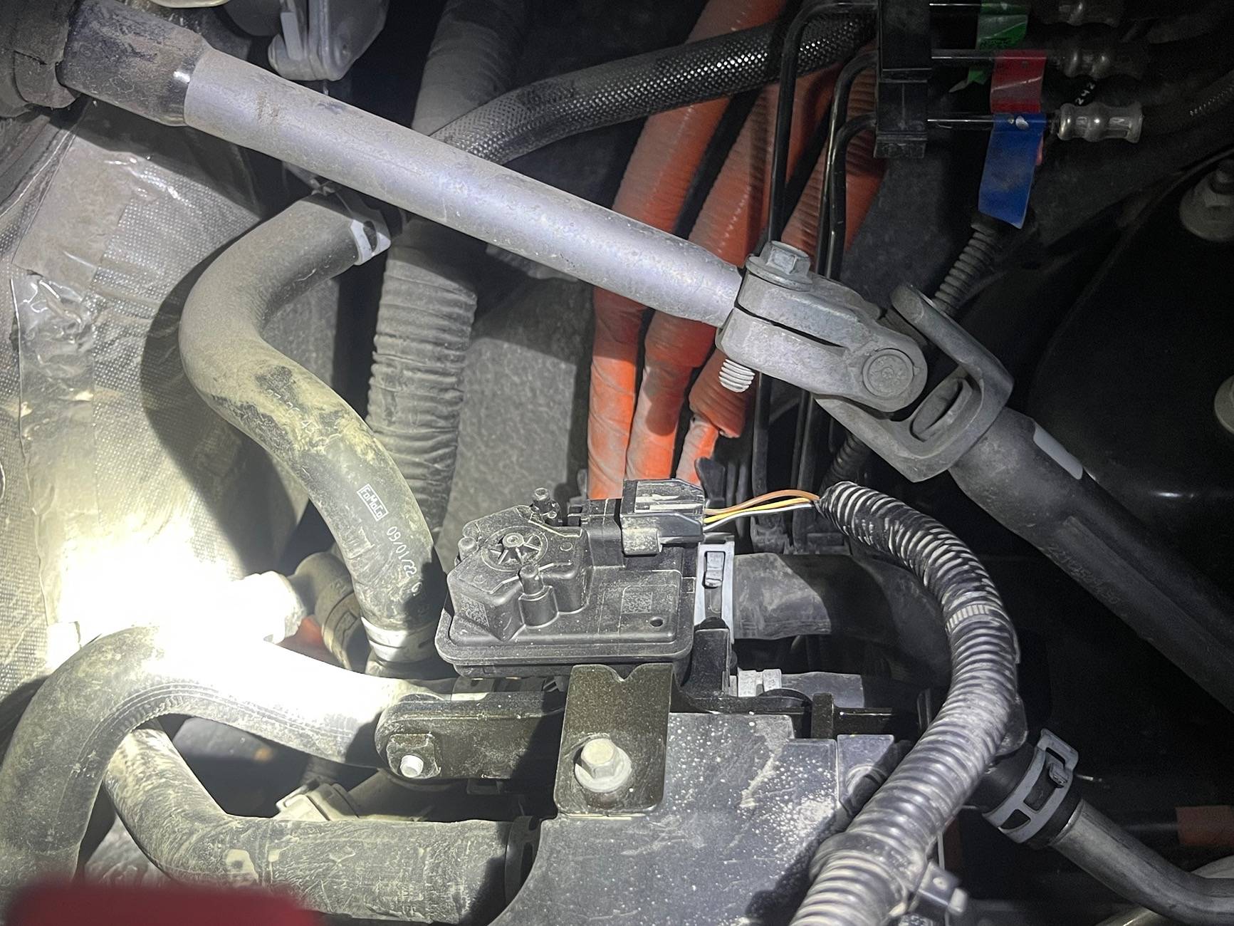

I literally just had a stuck coolant valve replaced this week under warranty. Many are going bad and it’s a known issue. I really don’t think dropping the battery is true!!! They replaced mine in an hour! I dont think they even took the frunk tub out, maybe they did…you can see the part they replaced when you open the 12v battery door!

Take off slide door in Frunk for 12v access. Stick head and flashlight in and look to the right. It will be there.
With battery out of the way you may be able to do job, but removing Frunk tub is obviously the correct way to have the room to work.

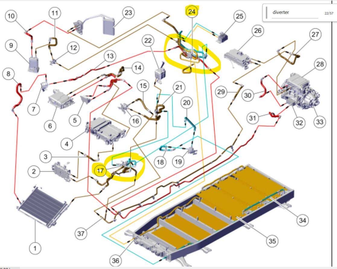

218
15,999
17,954
Base Trailer Tow - With 2.4kW Pro Power Onboard
Ford F-150 Lightning Service vehicle soon - Failure Coolant Valve Not covered by powertrain warranty? 1744894429176-hx
Ford F-150 Lightning Service vehicle soon - Failure Coolant Valve Not covered by powertrain warranty? 1744895530710-0k

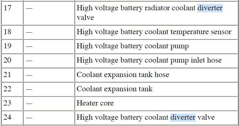

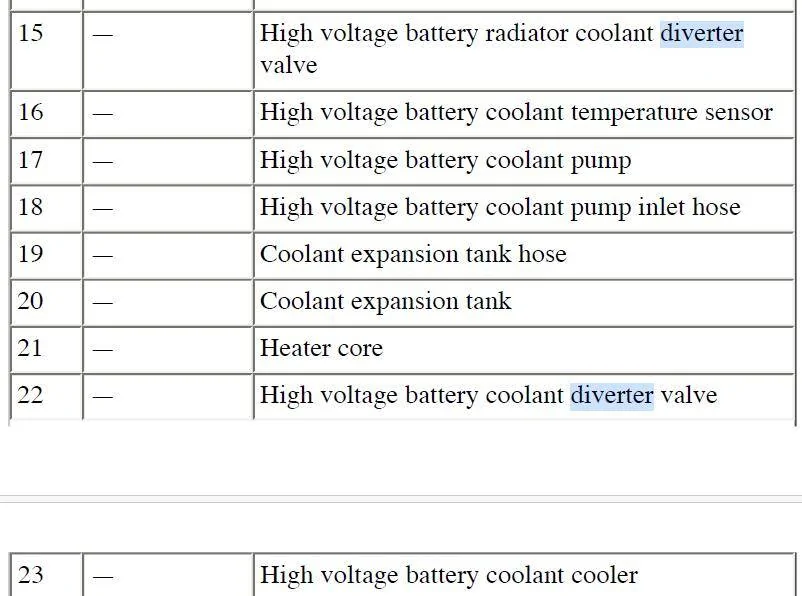

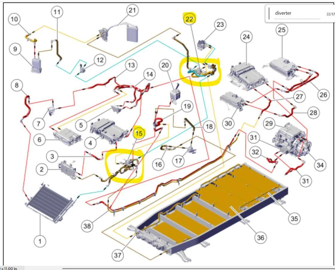

#17 is diverter valve to radiator and #24 is also a diverter valve, this one might be buried under what used to be the transmission hump area.
Ford F-150 Lightning Service vehicle soon - Failure Coolant Valve Not covered by powertrain warranty? 1744894795475-9q
Ford F-150 Lightning Service vehicle soon - Failure Coolant Valve Not covered by powertrain warranty? 1744894715131-y
Max Trailer Tow - With 9.6kW Pro Power Onboard #15 & #22
Ford F-150 Lightning Service vehicle soon - Failure Coolant Valve Not covered by powertrain warranty? 1744895032198-va
Ford F-150 Lightning Service vehicle soon - Failure Coolant Valve Not covered by powertrain warranty? 1744895090452-o1
Great information! Thanks. Looks like the one I had replaced was by far the easiest one to access.

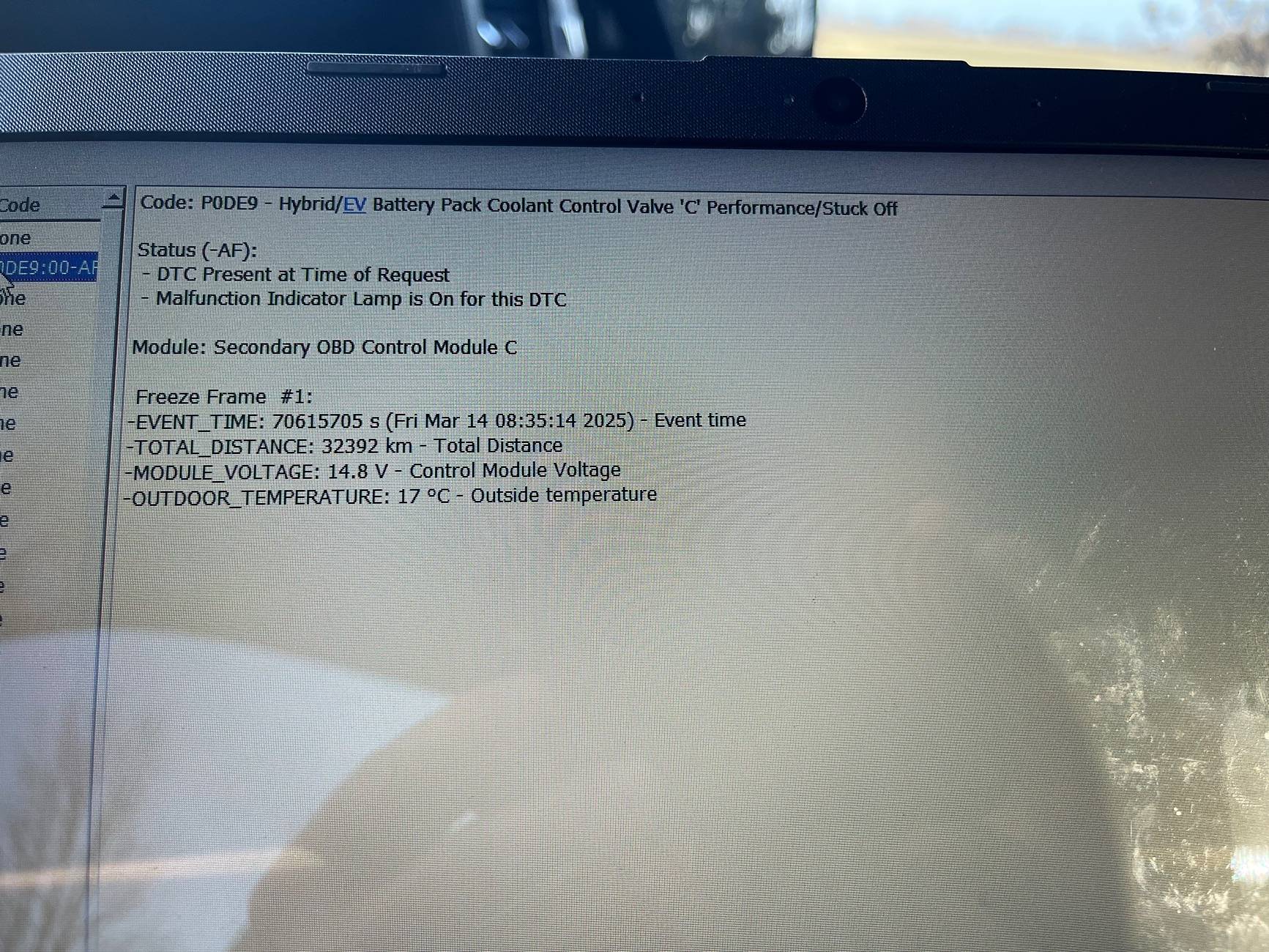

Update:
I asked the dealer to move forward yesterday, and today they dropped the battery and found HV pack has some coolant leak
They will continue the investigation on Monday to see the source of leak, and I will get the forum members updated
I might check with either Mike or ragu(?) to see if they can assist to pull it from Ford Server
Sadly I just lent out my mongoose to fix his Escape and now I don't have cable to do diag myself

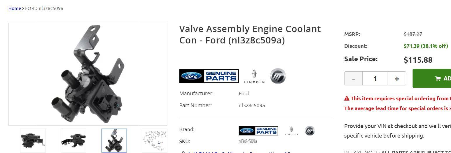

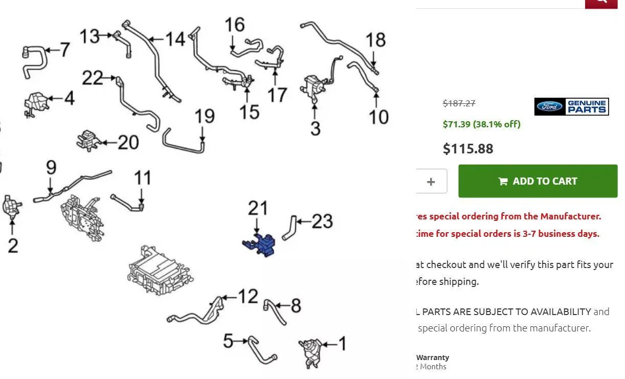

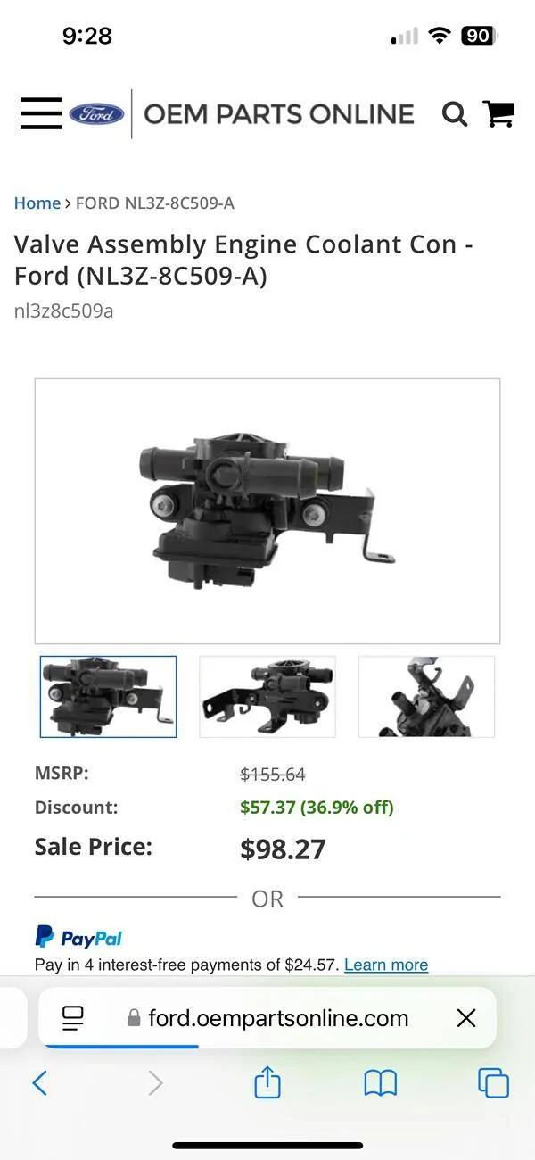

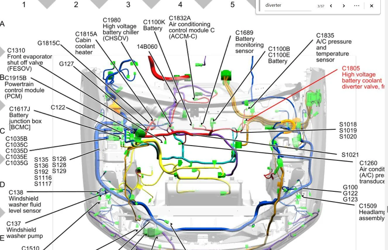

I am happy to report my truck got fixed for a price that is much lower than the original value

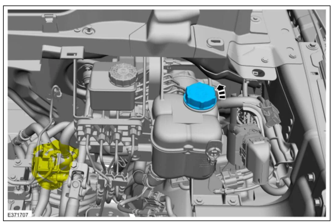

Excellent news, that part is not too expensive, this diagram points out the location, seems like it was the upper unit near the LVB
Ford F-150 Lightning Service vehicle soon - Failure Coolant Valve Not covered by powertrain warranty? 1747054590232-76
Ford F-150 Lightning Service vehicle soon - Failure Coolant Valve Not covered by powertrain warranty? 1747054663120-5s

The 10h labour is a lot of money actually... part price seems reasonable to me
