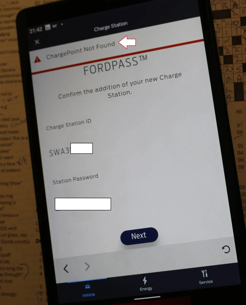

Yes setting up the FCSP is bug-filled.
I had the same problem - get the FCSP on the wifi, FordPass also on wifi, FordPass can see the FCSP id etc, but in the last step to add the FCSP to FordPass, error message "ChargePoint Not Found"
Ford F-150 Lightning Set up new 80 amp Ford charge station and it’s not connecting to app IMG_5643-connect to FordPass 4-error.JPG

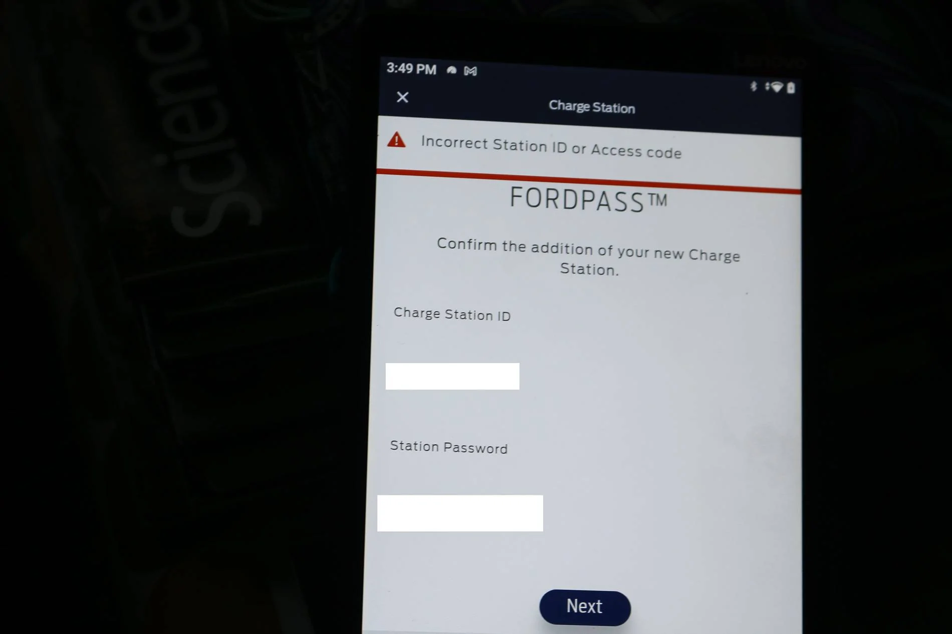

However, the last time I tried adding it to FordPass I got a different error "Incorrect Station ID or Access code" even though the ID and PW are correct...

It charges my 2023 Lightning Pro however so I am not going to waste any more time on trying to get it to integrate with FordPass.
Many people have had issues with the FCSP, btw, so we are not alone.

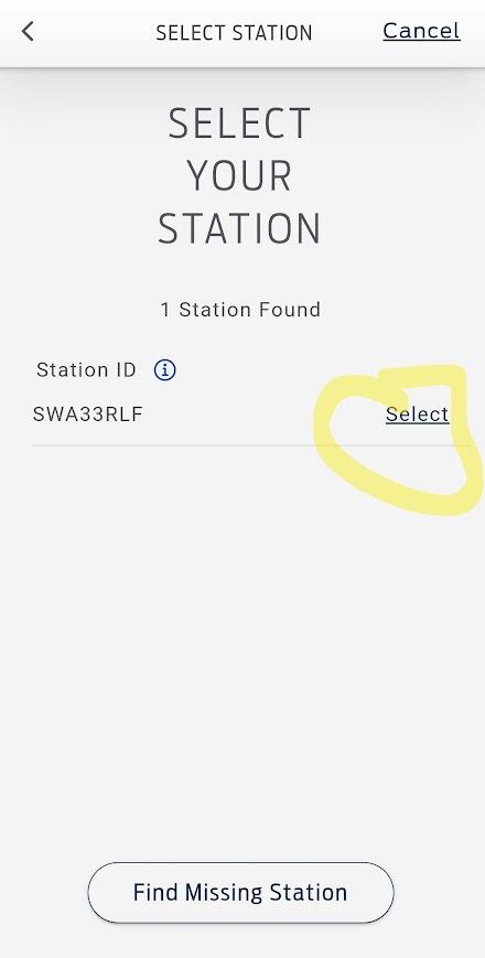

Repeat your configuration of the FCSP to your wifi network.
Once that's done disconnect your phone from from the wifi network, turn bluetooth back on (you should have turned it off during setup).
Wait a few hours for the FCSP to connect to the Ford data center.
Start your regular Fordpass app, go to Energy, scroll to the bottom, select charge station, add charge station, follow prompts.

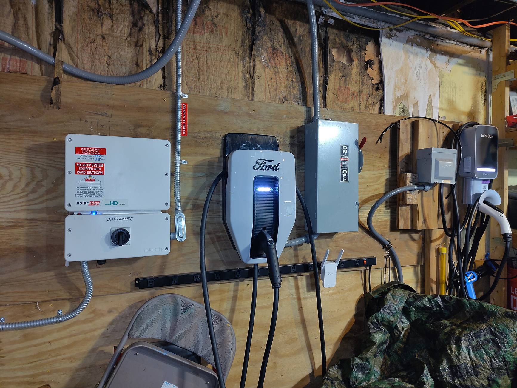

I had to install a wifi range extender, next to the charger, just it has enough signal to connect. It is a TPLink AC1200. It's on the black power strip in the picture. The FCSP is maybe 12 feet from my garage AP, but still the signal wasn't strong enough. Also, I connected my garage AP to a 900Mhz point-to-point wireless bridge from Loocam back to my house, to help make the garage wireless stronger, and have less drop outs. I think I had to reset the FCSP a dozen times until I had everything initialize and connect correctly.

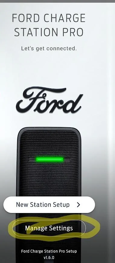

And they don’t say that once it actually FINDS your network that the FCSP network stops broadcasting so it seems like now it’s not working.
At that point you can only see the FCSP using the setup app, but don't go through setup again, just use the "Manage Settings" button to locate it and then connect to it. (your phone does need to be actively connected to the same network to see it though).

Yes, I think that something like that is the possible problem.
I had some long telephone calls with the help people when I first tried to do the set up, but it only got me this far. I tried calling the helper back - left some messages but never heard back from her.
I bought it from the original owner, he transferred the warranty to me when I bought it.
Now I wonder if the Ford server thinks it still belongs to this other guy and won't let me add it for that reason, hence the new error message "Incorrect Station ID or Access code."
