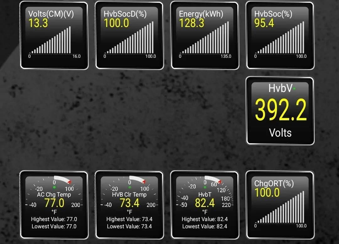

If I had to guess, the SOH is taking into account the battery temps that it is exposed to. I haven't been paying super close attention to where people are located when they share their SOH, I'll try to note that going forward. MickeyAO noted before he left that temps over 114F (I think) where one of the top 3 factors in cell degradation when they tested. I can guarantee my truck see's that every summer baking in a parking lot with full sun. I suspect that is contributing to my SOH being a bit lower than folk who live up north.
The thread I referenced that has a 100% display SOC was closer to ideal temps:
Ford F-150 Lightning SOH is not battery capacity 1785517035001-yy
Voltage and actual SOC pretty much spot on, but 3 kWh less useable energy and I had a higher SOH reported. I won't be able to test in that temp range again until Oct or Nov.

Here's a couple different 100% charges I captured at different temperatures. All end up at the same voltage. We see the usual lower useable energy at the lower temps, but even when I was near ideal in the 70s I didn't get all the way to 131 kWh. That's why I was surprised when it got there this most recent time. As far as I know, temps above 70s are not supposed to increase capacity.
The fact that my SOH has not gone up means that it is not solely tied to useable capacity.
