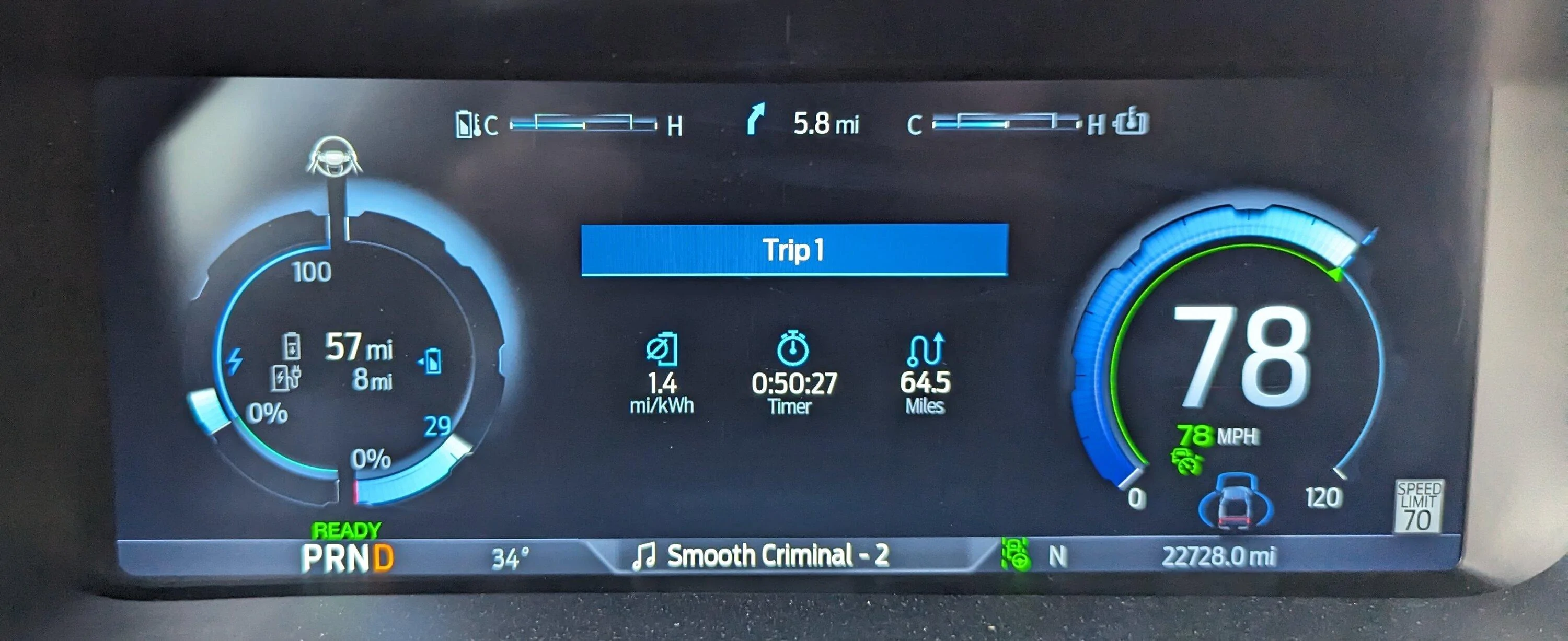

Give me more information. Just look at the instrument cluster. It's gorgeous...and that's great. But looking pretty does absolutely nothing towards its intended purpose, and it’s sorely lacking in the amount of information it provides. They could have displayed all kinds of useful data like real temperatures, live efficiency numbers, or even the charge rate. It’s the first EV I’ve ever seen that won’t tell you the rate of charging, and it's cumbersome to dig into the app for this. Absolutely mind-blowing that they haven’t fixed this with an OTA update of some sort. We know they can do it because they recently added the ability to see the battery percentage, so why not give us more? Likewise, the dummy gauges up top are meaningless. They’re glorified idiot lights that always seem to read at the middle of their range. The gas trucks can see real boost numbers, and they used to show actual transmission temps. They also have a handy efficiency screen that shows live MPG that’s resettable independent of the trip odometers. Why show us nothing?

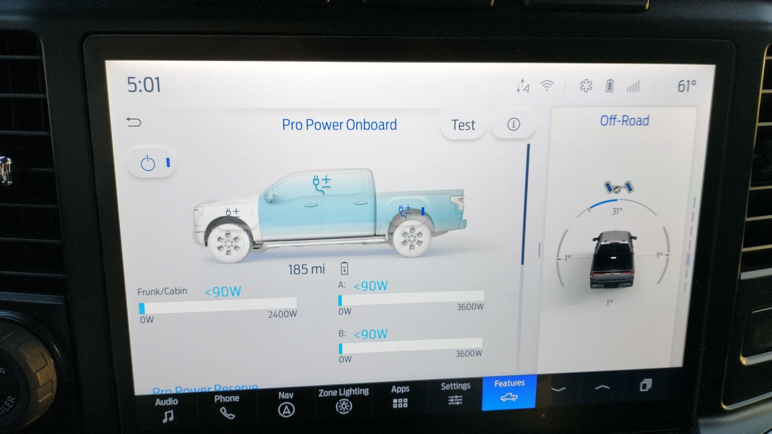

ProPower Onboard shouldn’t require the truck to be running. I understand that most of the truck is identical to the ICE model, but why do we have to leave the truck running to use the outlets? From what I gather, it only costs about 400w to run the truck’s systems, but that’s still almost 5 kWh wasted when parked overnight. I plan on using my bed outlets to power my camper when dry camping, and it seems dumb to leave the truck running the whole night.

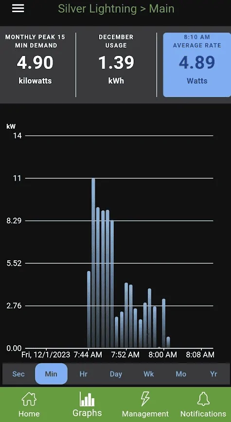

The cabin heating is grossly inefficient. The top-center gauge in the below image is the coolant immersion heater. The Lightning uses this heater to warm coolant, which is piped through a conventional heater core in the dashboard. I’ve seen it pull as much as 12 kW when first activated, and it settles between 3-5 kW to keep me warm at 74º when exterior temperatures are in the 20’s. That’s a lot of power; my EV6 and Model Y would consume less than half as much with their heat pumps. This much consumption really adds up. 5 kW over a three-hour drive burns 15 kWh, which is over 10% of my battery capacity. This isn’t as much of a concern for my southern friends, but it’s a meaningful number in a Minnesota winter. The 2024 models will get a heat pump, and I look forward to seeing how much more efficient they are.

The Standard Range is probably inadequate for cold weather trips. I averaged about 1.7 mi/kWh during my trip to New Hampshire. That was with average temperatures between 25-35º, at speeds between 65-72 MPH. The truck’s EPA rating is approximately 2.5 mi/kWh, which probably isn’t possible at those speeds unless conditions are optimal. Cut that in half and you only have 160 miles of range for the ER pack, or just 115 for the SR. It takes a lot longer to charge from 80-100% than it does from 20-80%, so road trips will be painful if you need that final 20% to get to your next charging stop. I think Ford did a commendable job with the aerodynamics to get range estimates as high as they did, but there’s no getting around the physics of moving such a large vehicle through the wind. Speed seems to have a much higher penalty in my Lightning than my previous EVs. If you want to burn down the highway at 80 MPH, you’re going to pay for it at the charging stations.
This is the first EV that I’ve had that was more expensive to travel with than its ICE counterpart at $3/gal. I expect this to be significantly better in warmer weather, and the 2024 trucks should do better with their more efficient heating system.

PPOB, needs to have the HVB contactors to be active, they are presently designed to come on when charging, driving, or parked but running/idling for heat.
For a camp or work site scenario, set the parking brake, start the Lightning, shut off the HVAC system, lights, set the Sync screen to calm mode and drape a towel over the instrument cluster, to minimize unnecessary loads, but allow PPOB to be available and periodic LVB maintenance with the cycling of the DC/DC converter, the LVB is anemic.
Ford has mentioned recently that an update is coming to streamline this setup to what feels like a no run condition and PPOB being available.
The PTC module has run as much as 18KW in my testing, but I've only observed it in 15 to 30 minute stretches while plugged into my EVSE and monitoring current flow with my Emporia Vue2 energy monitor, this recent snap shot showed a peak of 11KW, the cumulative energy over 15 minutes was 1.39 KWH, obviously the system would continue to cycle high & low current draw while on a longer drive.
I think Ford used the PTC as a quick solution with OTC parts supplies and cabin HVAC design rather than a full on redesign with a heat pump since that would have extended the time frame of development to market. I'm glad they are testing it in the MY24 Lightning, they should work out any issues on that platform before rolling out T3 which would likely inherit the same setup.
That's my read of things as well. I'm no engineer, but a big immersion heater piped into the existing hardware seems like a simpler way to tackle the problem on a first-gen vehicle being rushed to market. All things considered, I think they did an excellent job.
Agreed, Ford is working on getting it setup for earlier models.

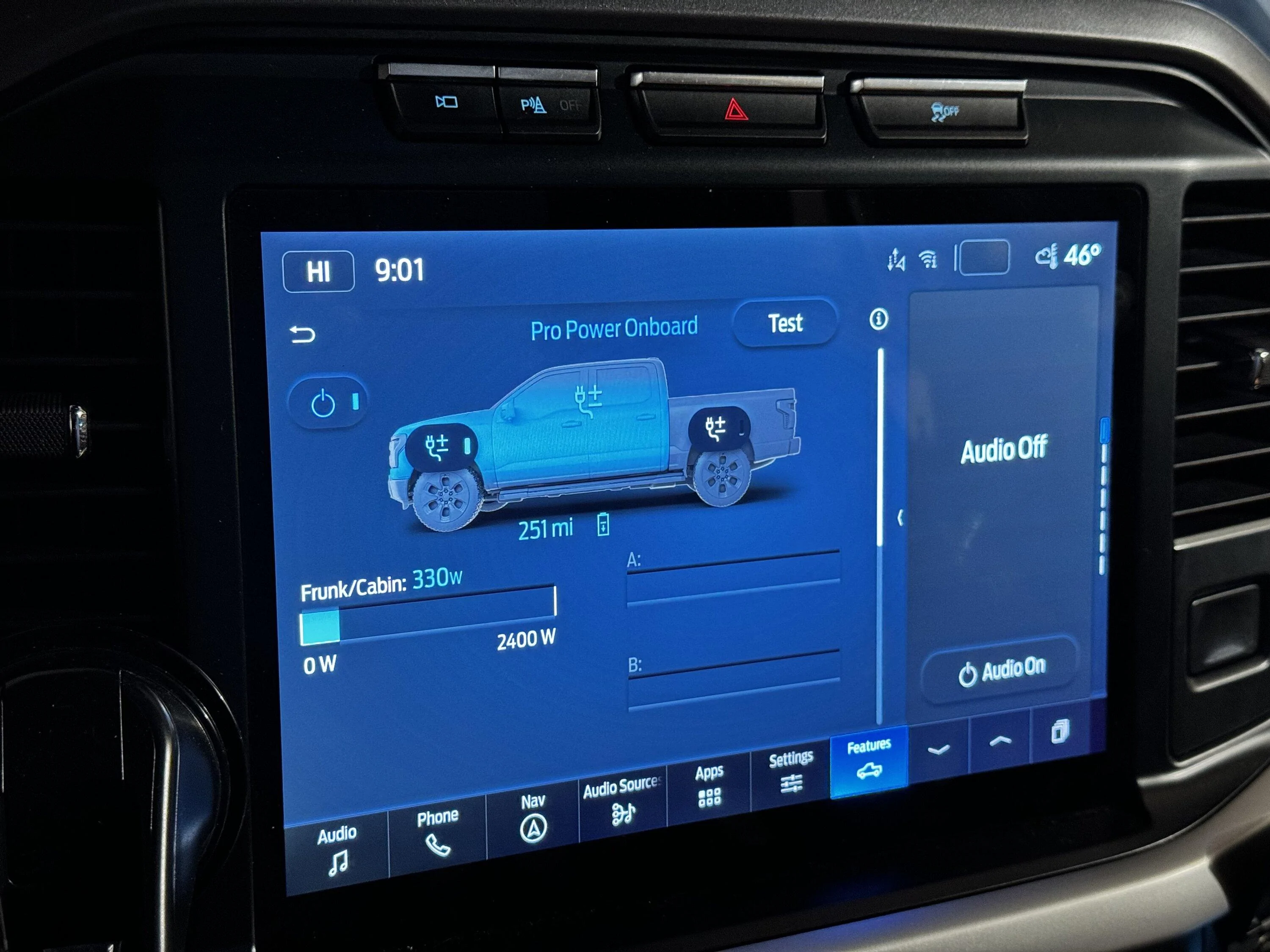

I have not seen over the minimum display of 90W being used when ProPower is on without any loads plugged in. What does your OBD scanner show for power usage without anything plugged in?

Uh, what ? There are 10 pages of info to customize, including 3 trip meters and the gauges do work, I can see battery and motor temp move when I leave cold. They are supposed to be in the middle and stay there. Opening the app to see the charge rate isn't hard, especially when you're sitting there doing nothing. I don't usually sit in the truck while charging anyways so the app is the best method for me.
It’s not whether it’s hard…why do I even need to? This is my fourth EV, and the first that won’t tell me how fast it’s charging without using my phone. That’s ridiculous in my view.
The ICE F150 with the mid-level cluster has an efficiency screen for cryin’ out loud. It shows instant and average efficiency that can be reset independently of the two trips. Why does a gas truck costing $20K less have a feature we don’t with a higher-end cluster?

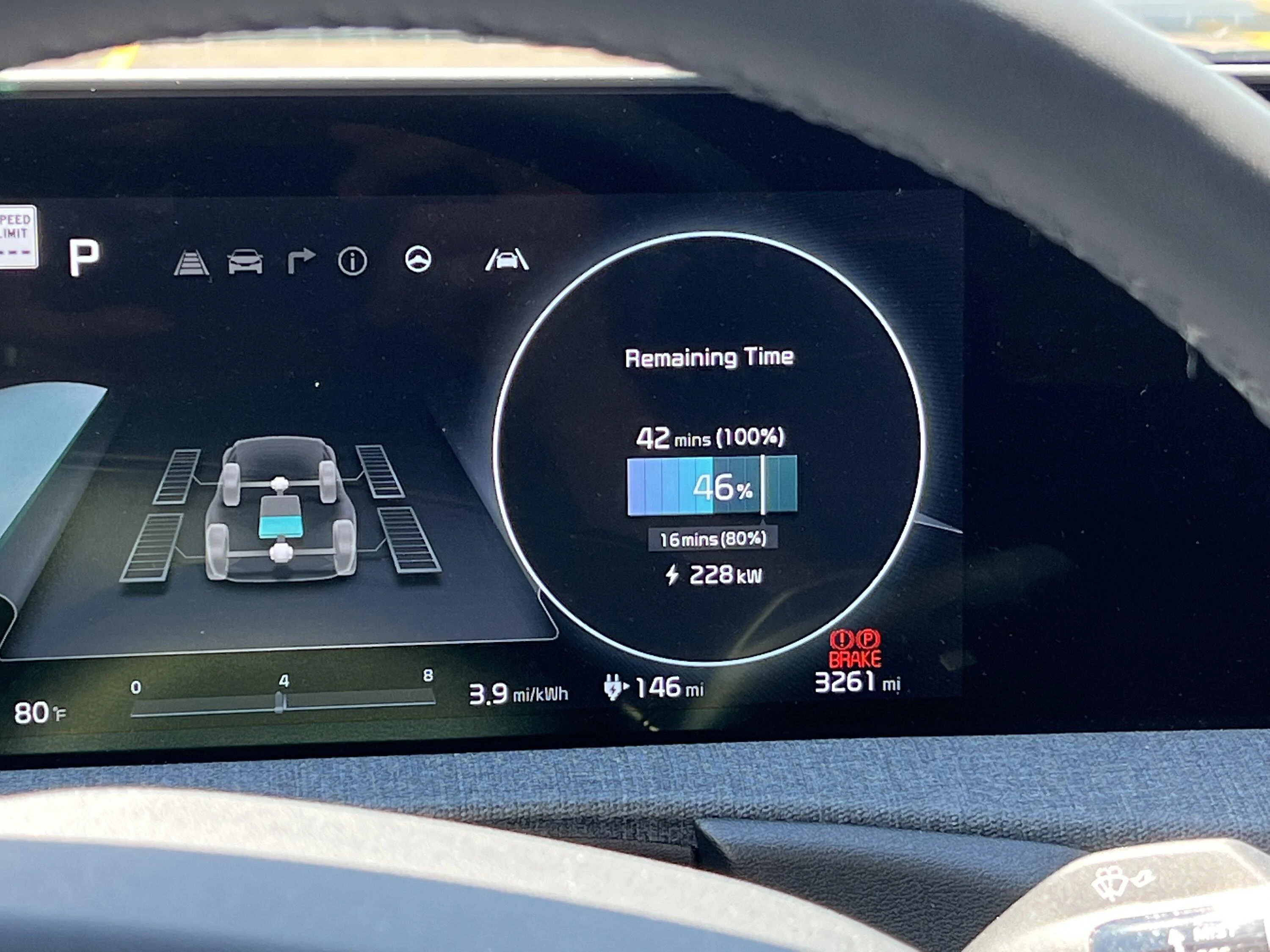

Other EV makers do it better. Tesla is probably the gold standard.
Ford F-150 Lightning Some Nitpicks after Five Weeks 1702430992723
Kia shows instantaneous and average efficiency below the cluster. They, along with Tesla, prominently display charge rate. And yes, they will both let you see it in the app, but that’s silly unless you’re out of the car.
Ford F-150 Lightning Some Nitpicks after Five Weeks 1702431117908
That screen only shows power output through the outlets, which should be zero unless something is plugged in. I’m talking about energy drawn from the HV battery to drive the truck’s systems. Think coolant pump, computers, screens, lights, etc. If I manually shut the lights off, it seems to pull about 0.4-0.5 kW from the HV battery with nothing plugged into the outlets. Plug something in and the HV battery draw rises with that load.
