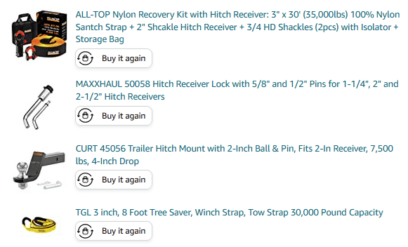

I just order the same exact one before reading your note from Amazon. The only reason I was trying to order from Ford was using my points otherwise everything is overpriced there.
Buy a receiver and ball when you have a trailer to pull. Then buy a receiver with the drop that keeps your trailer level and a ball that is the proper size for the trailer.
I may have to use U-Haul trailer to move my bike soon and it seems like what I bought with 4" drop should be good for that for now. After that, I may take your advice and/or Rick's buy either something flexible or strong enough for the use later.

Ford deadline got me on shopping mode but since I learned I can't use my points, I ordered the following from Amazon for now and I got it out of my system so I can wait to figure out if I have something permanent to tow.

4" drop/2" ball will cover 90% of handy homeowner/recreational boater situations. Just make sure you check that the trailer you are using actually uses a 2" ball and not something bigger.
