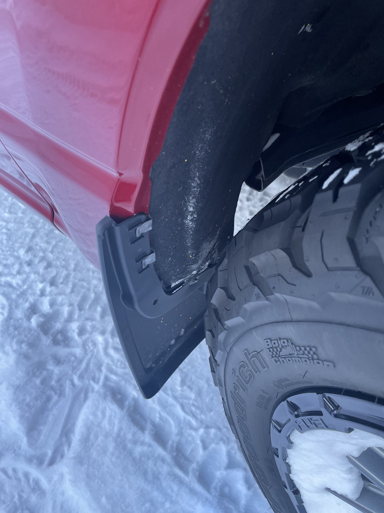

Possibly, you have to remove the black plastic trim piece on the lower front side of the rear wheel well. On the rear part of the wheel well I used the lower inner most hole, removed the push tab, pushed the flare in and up and pushed the tab back in. You don't remove the plastic trim piece in the rear. Can you post a picture of the mud flap from the inside of the wheel well?
This is the front.

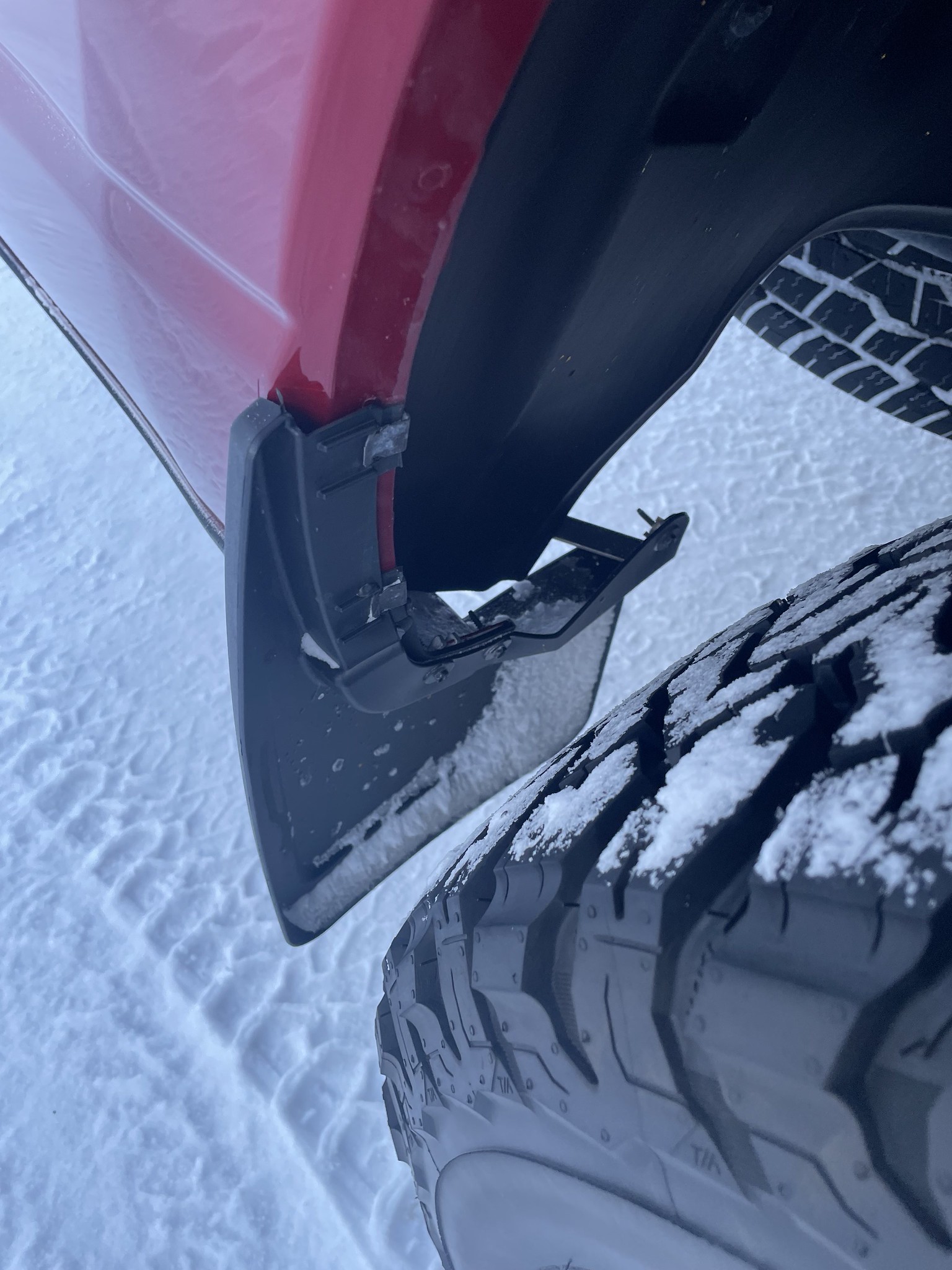

This is the back.

This is the front.
This is the back.
Unfortunately I don't think these flares will fit with the mud flaps. They curve under the bed where the mad flaps are. I think you would have to do some heavy trimming on the flares to make it work.

Anything can work if you’re determined enough 😁

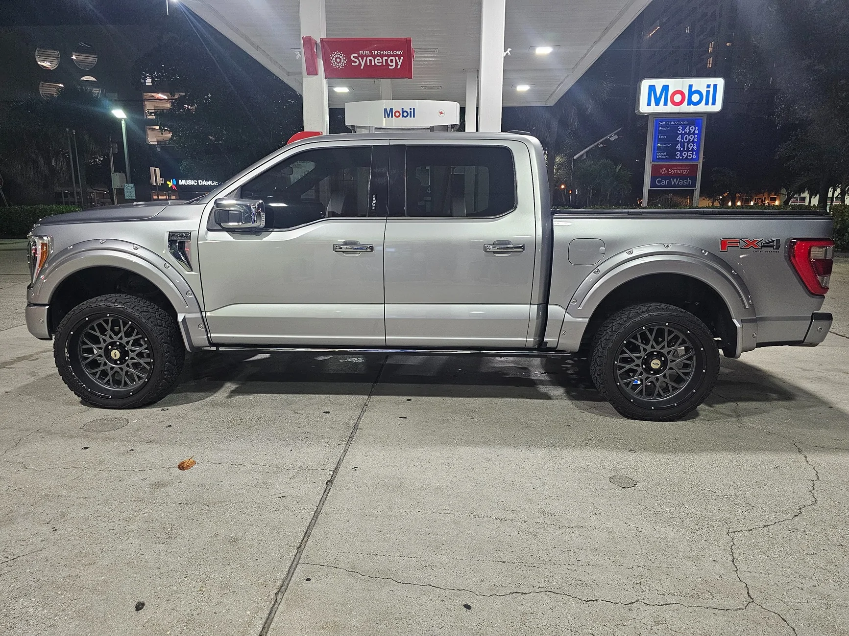

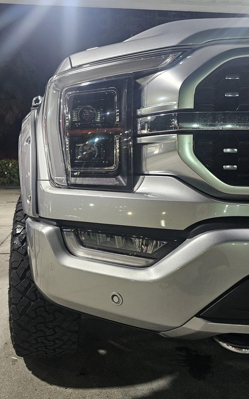

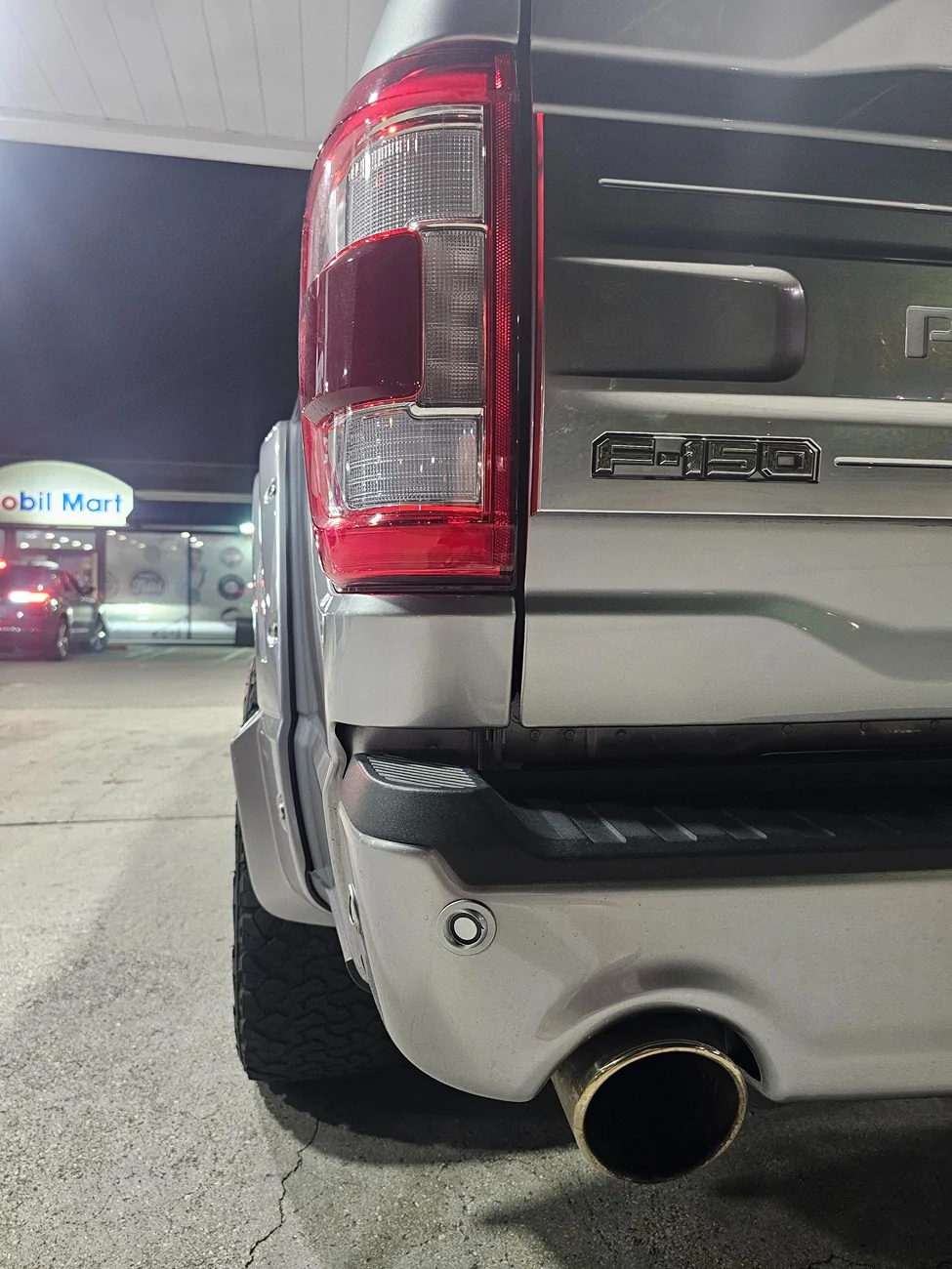

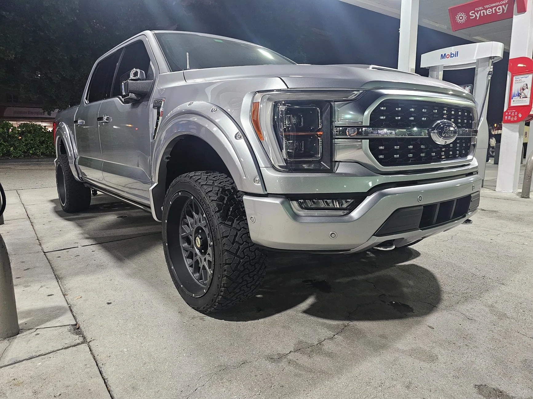

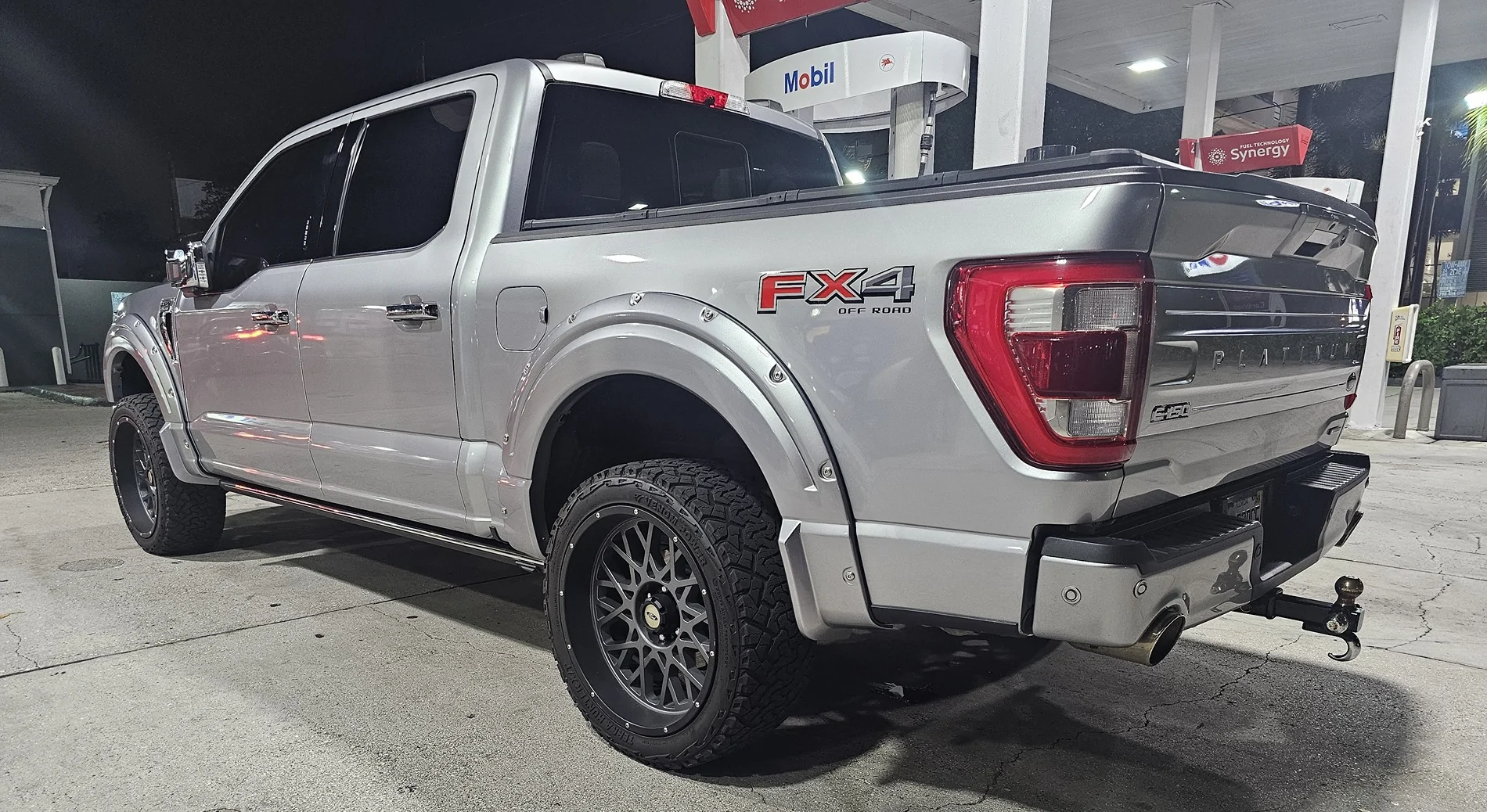

I don't have a Lightning, but these should fit on these trucks, too. The fit on these were PERFECT. Air Design is officially licensed by Ford and can be purchased directly from the Ford Accessories catalog. Like the OP, my wheel/combo tire poked out, so I kinda needed flares. I still like the overall look of the Rough Country ones more, but after having them on my truck for some time now, they have grown on me and I like them a lot.
Ford F-150 Lightning Sport Fender Flares by Rough Country installed 20240118_204038
Ford F-150 Lightning Sport Fender Flares by Rough Country installed 20240118_204014
Ford F-150 Lightning Sport Fender Flares by Rough Country installed 20240118_204029
Ford F-150 Lightning Sport Fender Flares by Rough Country installed 20240118_204001
Ford F-150 Lightning Sport Fender Flares by Rough Country installed 20240118_203953

Finally someone shared photos showing the actual compatibility issues between the ICE F150 and Lightning. In my opinion they are minor.
Huge thanks @Mcfly !!! Now I feel more confident to try installing fender flares from ICE model.

Good stuff, thank you sir!

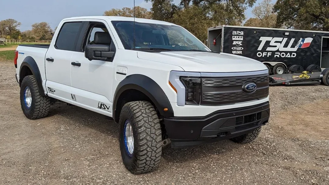

I went with these: (Not my Truck) these are from a GEN2 Raptor (2015-2020) "modified and shaped"

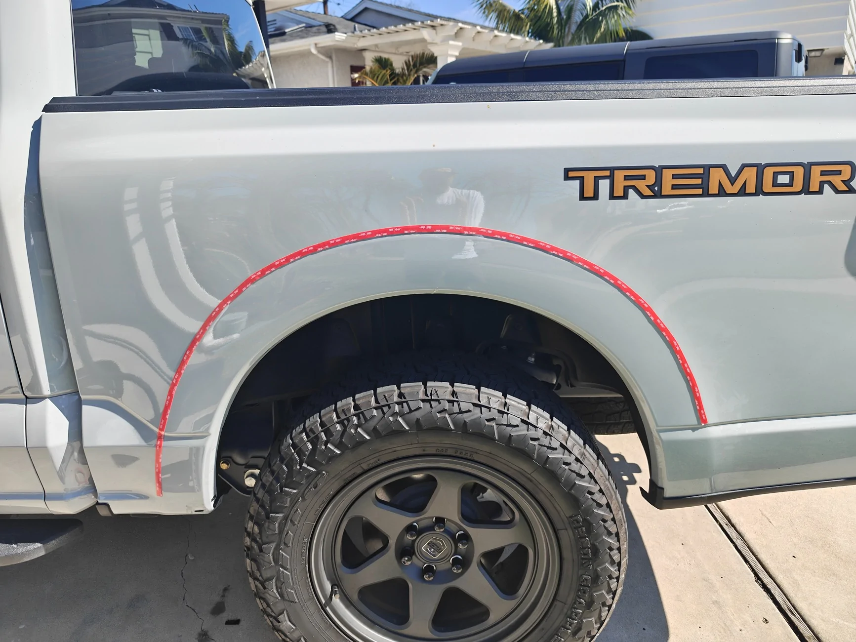

I removed the flares and added a strip of .5 inch double sided clear automotive 3m tape where they touch the fenders. Re installed. Did a line of paint tape before removal so I knew where to lay the 3m tape. Hopefully this keeps damage at bay.
Ford F-150 Lightning Sport Fender Flares by Rough Country installed IMG_20260228_104754359
