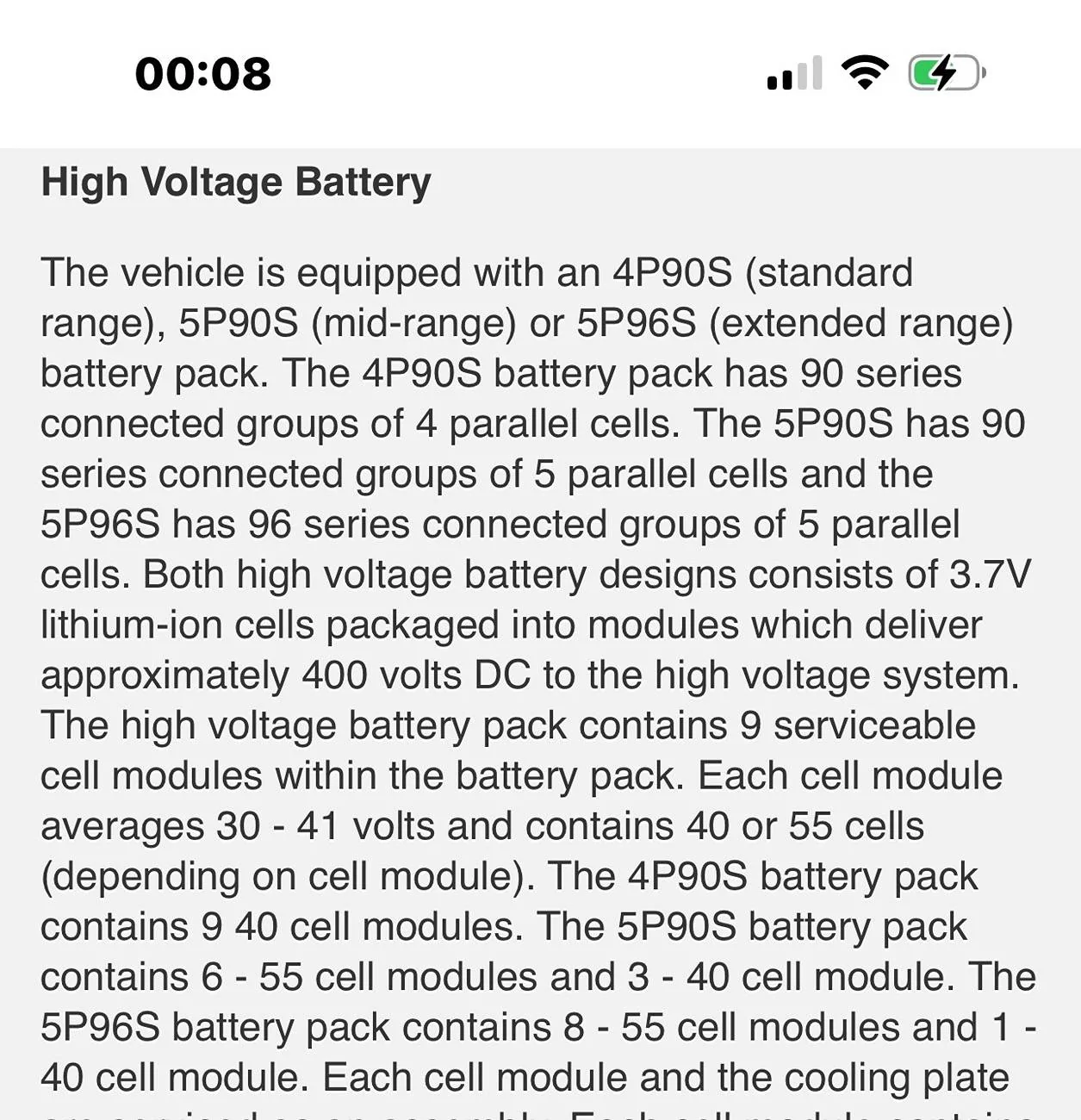

***UPDATE: see #30 below for the real answer from Ford Senior Master, 90 groups in series of 4 parallel cells for the SR; 96 groups in series of 5 parallel cells for the ER. Then there is the 2025 Flash 5p90s variation!

And now we have the new Flash with a different capacity
Like the old ER, but dropping the small module? ER 131kWh, new Flash 122kWh usable?
When will Lithium Iron (Ferro) Phosphate [sic?] LFP batteries be introduced for the Lightnings?
Ford Senior Master
Sep 19, 2021
693
624
Pell City, Alabama
Service Manager
New configuration battery for the mid-range. Each cell is still 3.7 volts. I was expecting LFP for 2025. Maybe we will get it mid year.
Ford F-150 Lightning SR/ER number of pouches, cells, battery modules, starting with ChatGPT IMG_6304
