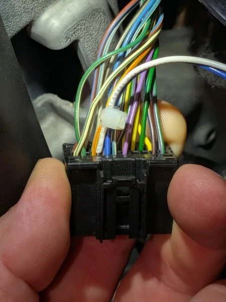

Where are the installation instructions? Do you have to cut a harness on you vehicle. Does this only operate when you are in the specific mode.

In this exact moment, I hesitate to say how easy it is to install because I already have 10+ people asking me to test it, but, I have a VERY simple method of stabbing two probes/wires into the CAN-FD bus wires on the connector that Comma uses to middle man the same bus. This solution is very passive, it only injects button presses at microsecond accurate/coordinated times. Here is a picture of the installation, it can be installed in just a few minutes.
Ford F-150 Lightning Steering Wheel Torque Driver Monitoring Defeat Device - Testers Full 1787249993236-mt
Yes, it also monitors the ADAS system status and only injects button presses when the system IMPA is in active land centering mode and happy.
