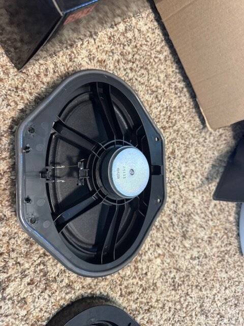

I'm upgrading the stock low quality 8 speaker B&O auto system. I'm actually suprized at the low quality of the speakers. Thought not my photo but this is what I am replacing:

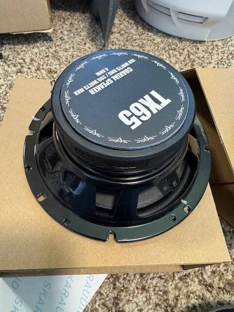

Skar Audio TX65 6.5 $61 (another 2 way speaker for the rear with 89 db sensitivity and a fiberglass cone)

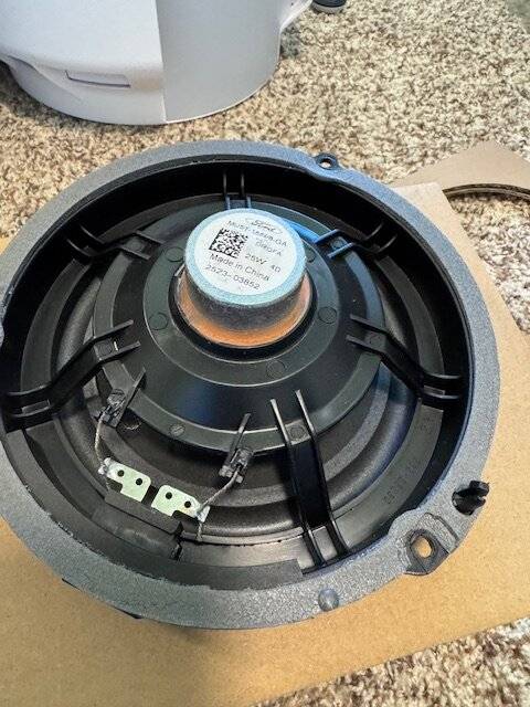

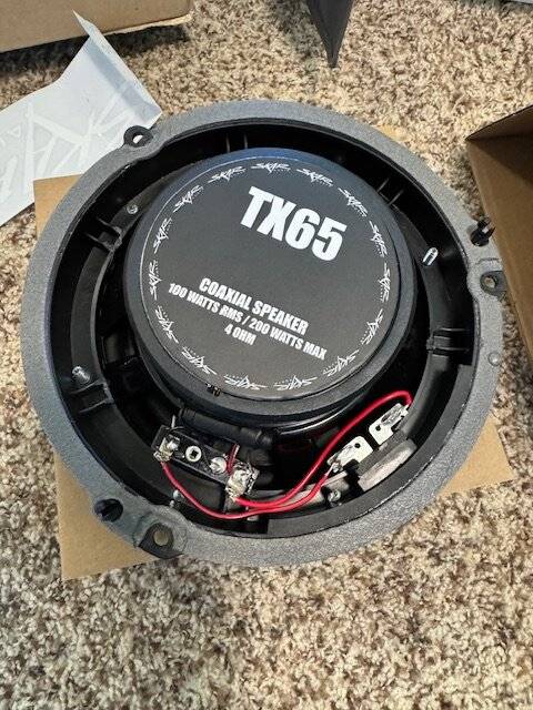

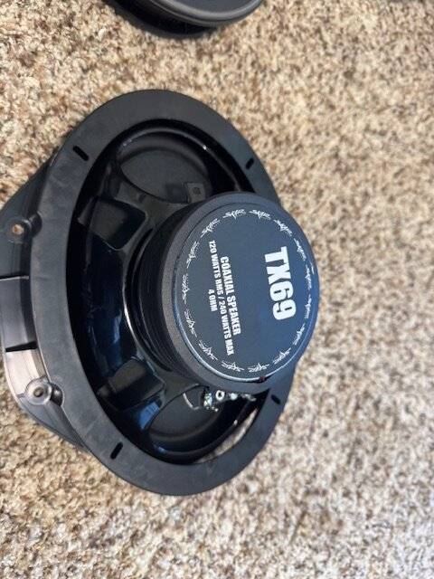

Done... Everything except the tweeters. It's a 10 minuite job per door. Pretty quick. The stock speakers are less then 1 pound and have tiny magnets on them. I'm surprised Ford isn't replacing a whole lot of them under Warranty.
Ford F-150 Lightning Stereo Upgrade - On a brand new truck... who does that? IMG_9076
Stock
Ford F-150 Lightning Stereo Upgrade - On a brand new truck... who does that? IMG_9077
Replacement (This speaker is backwards (upside down) in this mount).
I realized that when I got to the truck. These are $10 mounts from Amazon.
Ford F-150 Lightning Stereo Upgrade - On a brand new truck... who does that? IMG_9080
Rears
Ford F-150 Lightning Stereo Upgrade - On a brand new truck... who does that? IMG_9079
I reused the rear baskets.... Simply note the Polarity of the terminals, Cut the speaker out of the frame, solder in new wires and reuse.
Ford F-150 Lightning Stereo Upgrade - On a brand new truck... who does that? IMG_9086
Positive is always on the right when looking at it from the backside (terminal on the bottom).
And everythings bolts back together.
