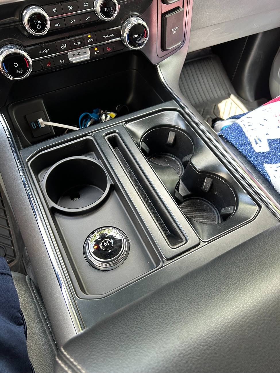

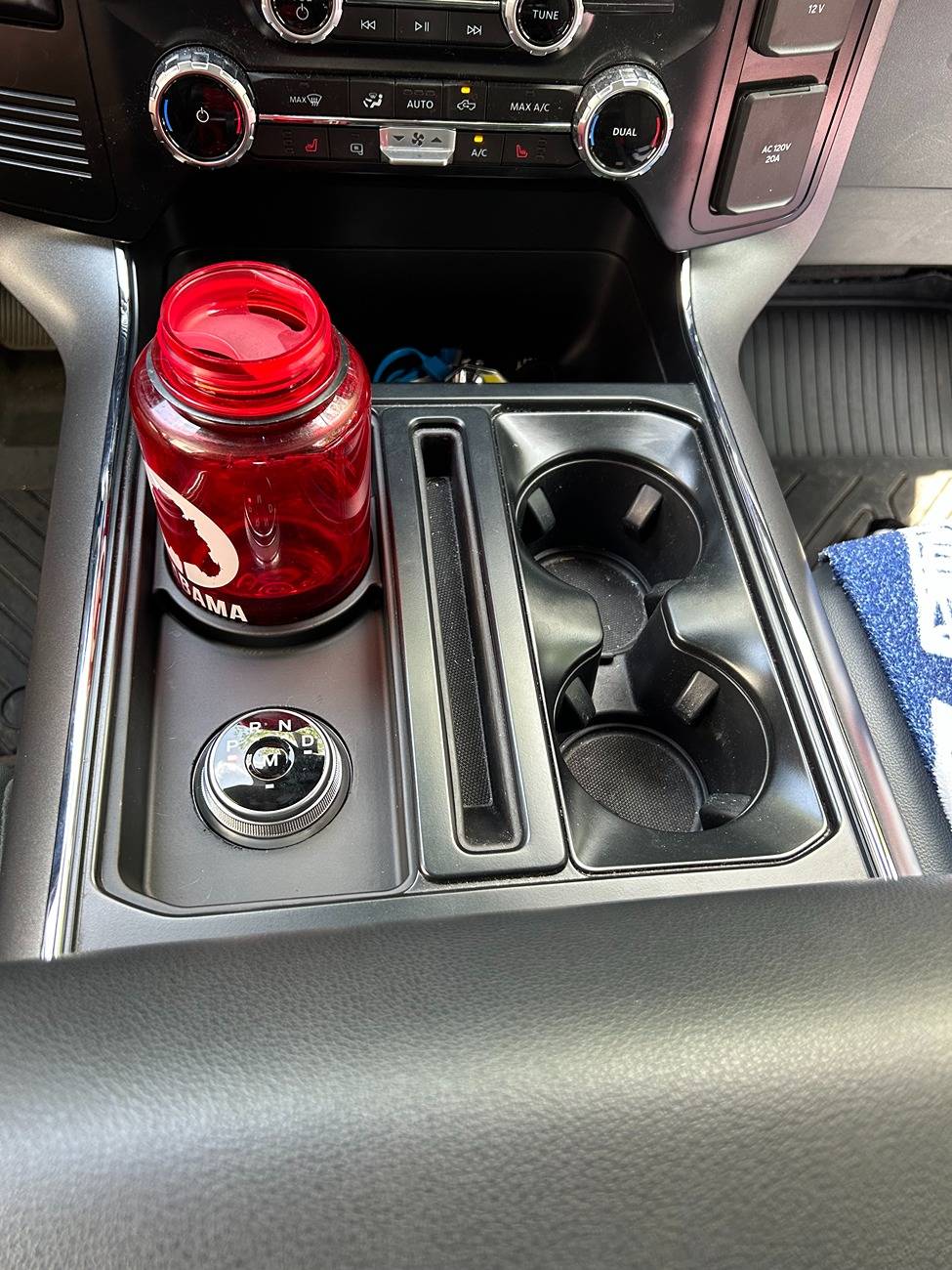

Just installed my version today and it worked great. I've got a handful of people to thank that made this possible.
@jmyer72 thanks for the initial idea and the link to the shifter on ebay.
@asianman35 huge thanks for printing this out for me after I was unable to print this on my own printer. He printed and shipped this thing in no time.
@ENDianDigital thanks for posting the original file on Thingiverse. I modified it to fit my Nalgene and it worked out perfectly.
I'm happy to share my version if anyone wants it.
Very happy with how it turned out!
That is slick. I printed the first one (crudely) but I also wanted one where I didn't have to cut the tabs off, so I haven't really done anything with the first one I printed. Your version looks SO much better than what my machine printed. Did you post your build on Thingiverse?

Yep! See post #288 on this thread.
The one I received from @asianman35 had a pretty good finish as-is, but I sanded it and put several coats of primer and paint on it. That hid the remaining layer lines.
I should have said in my original post that I did have to cut the tip of the tab off on the “front” of the rotary knob.

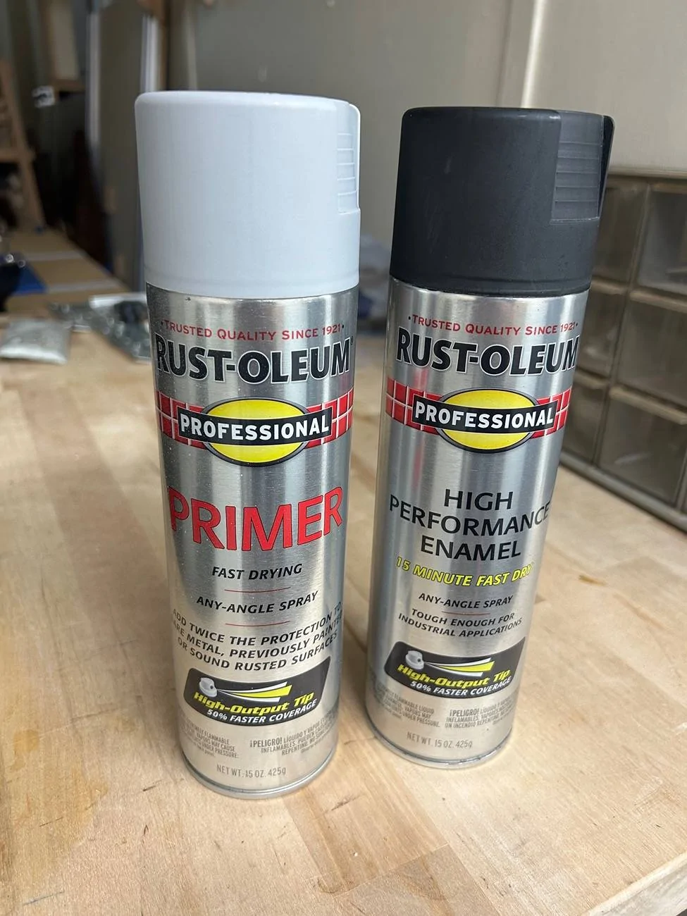

What paint did you use? I'm debating what to use for mine. TIA!

This is what I had on hand and it turned out great. I didn’t use any clear coat because I was afraid it would be too shiny compared to the OEM plastic but in hindsight a layer of clear coat would have probably matched a bit closer.
