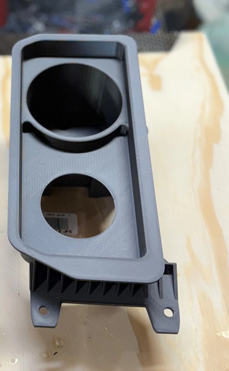

Awesome! Thanks for the tips. I 3D printed my console yesterday and now waiting for the new shifter to arrive!

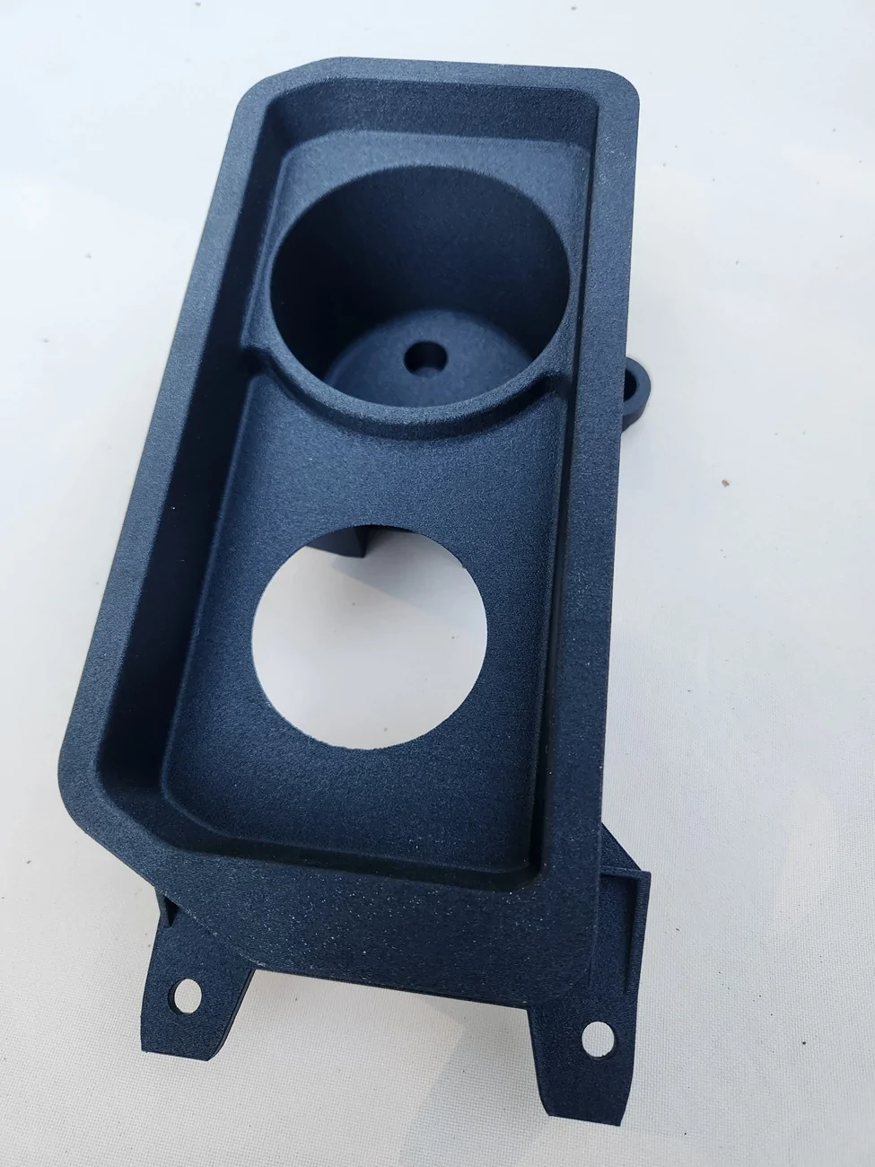

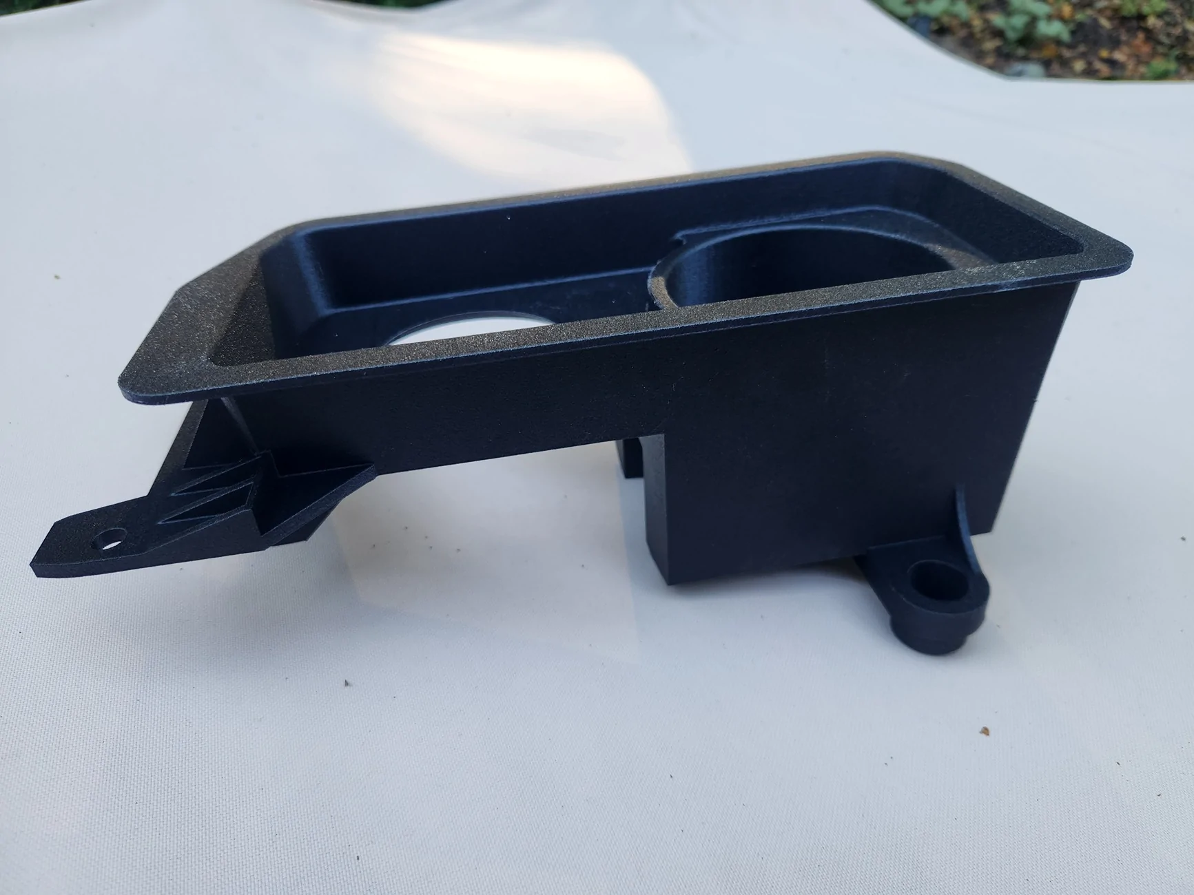

Got mine printed yesterday. Used @masonta 's model (thanks!) with the Nalgene holder. I have an Elegoo Centauri Carbon and used PETG-GF (glass fiber) filament. I am blown away at the print quality! I love the finish just the way it came out.

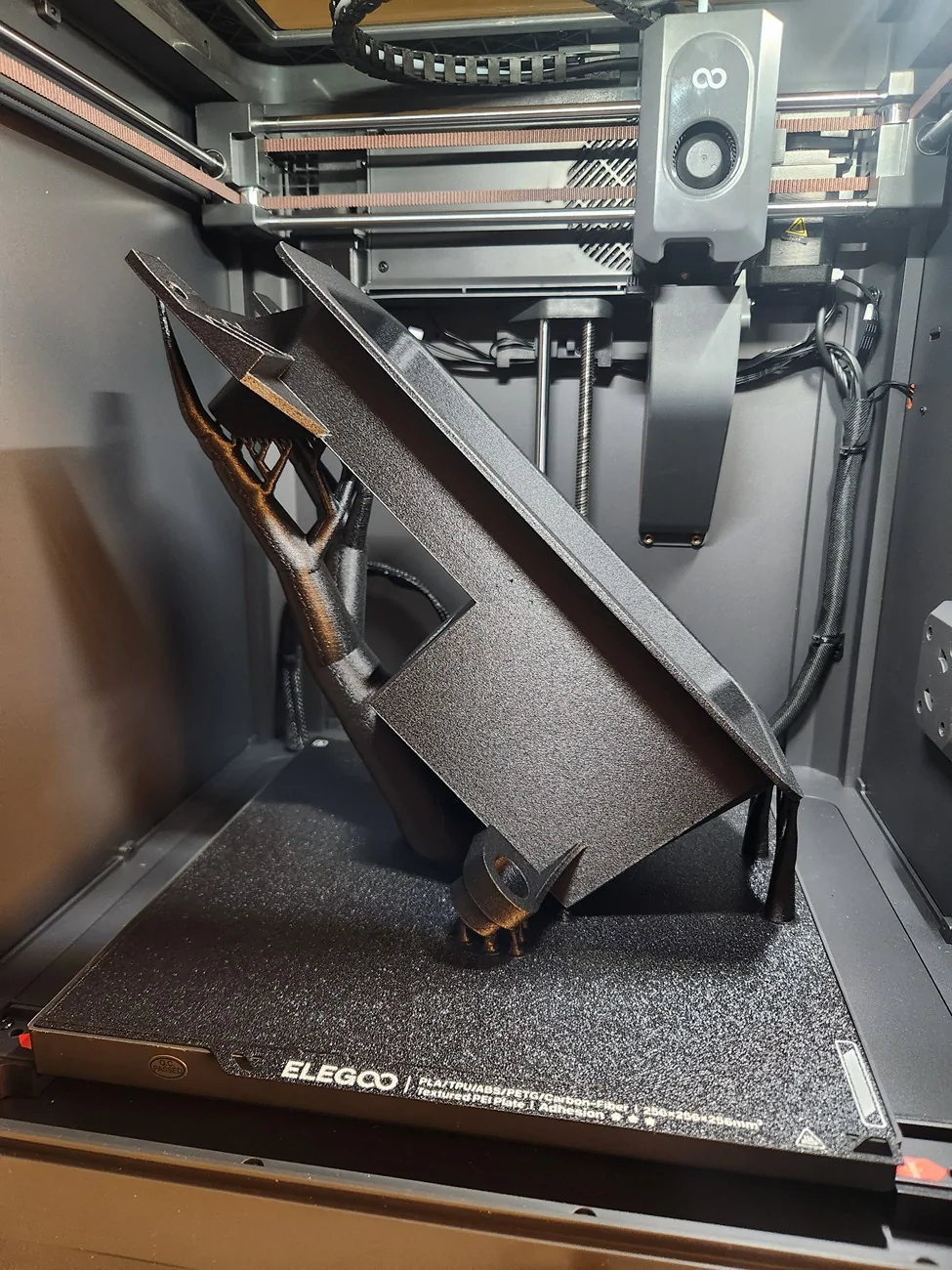

Nice. I'm trying that next.
Here's my PLA-CF
That looks so good! Did you print that an an angle?

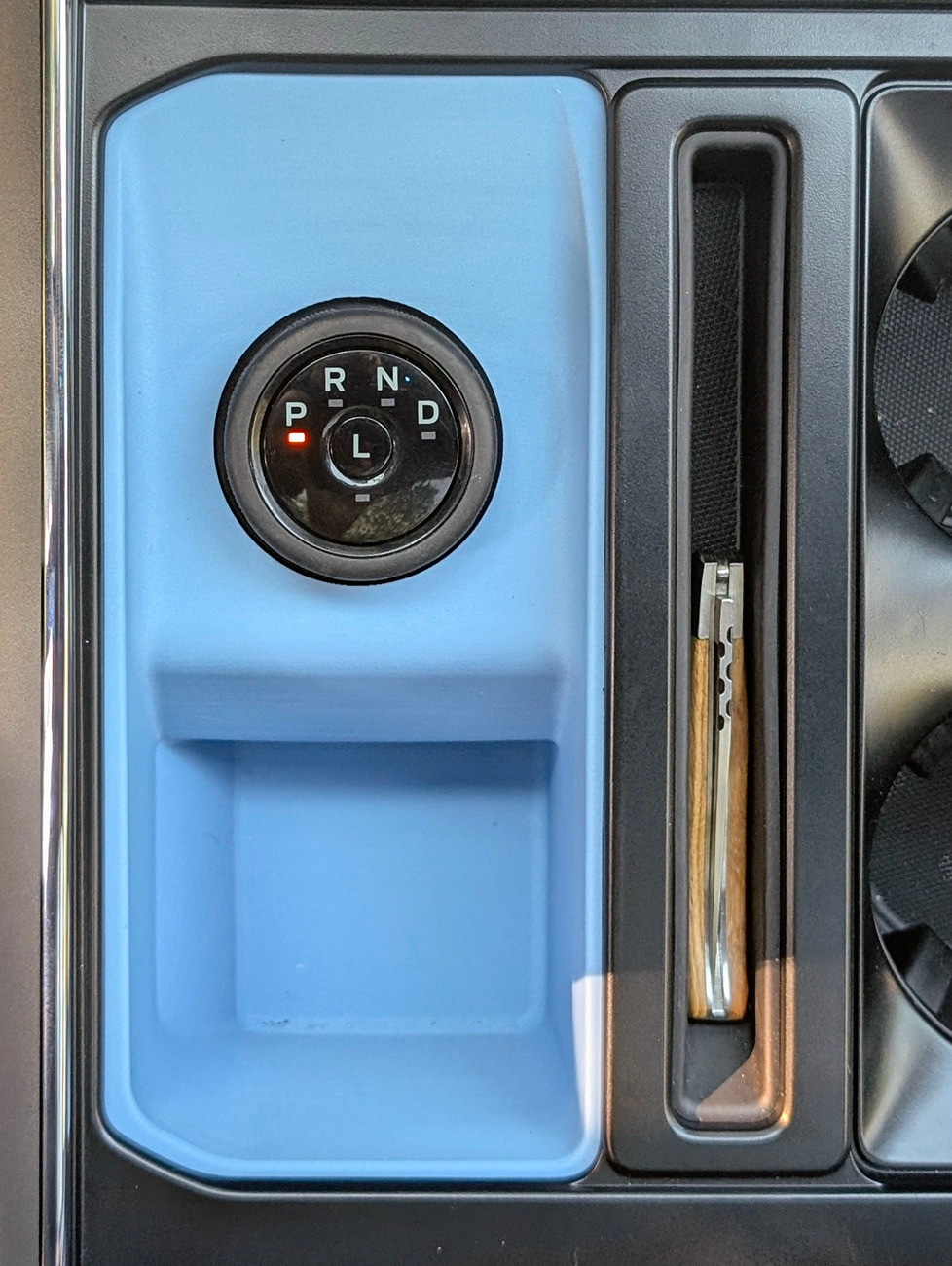

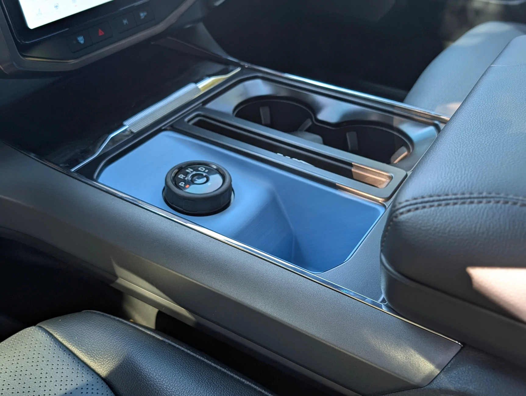

I decided to give @mr.Magoo 's design a try and absolutely loving it! I think the dial is much more comfortable/convenient in the forward position and I have no need for a third cup holder from some of the other designs.
The install was a bit harder (compounded by my lack of skill because I can't install heat set inserts straight), but nothing some patience didn't fix.
I printed it myself using Bambu Lab PA6-GF in Blue, on my Bambu Lab X1C. I love the color and as a 3D printing enthusiast, I wanted it to pop instead of trying to make it look OEM.
Shifter is from a 2022 Ford Maverick
Part # NZ6P7P155AD
