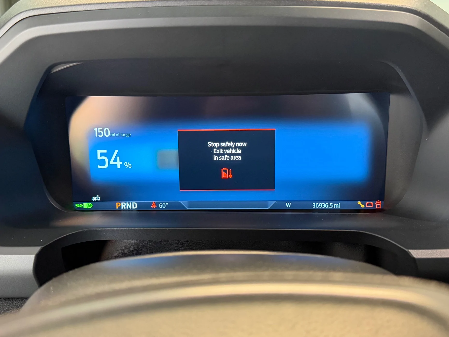

My truck would not start this morning and had this error message. I plugged it in to charge last night but didn’t charge and won’t charge now. I disconnected the 12V to see if it would recover and it would not.
I see a lot of posts with just the “Stop safety now” message but not any with the “Exit vehicle in safe area” part.
I had it towed to the dealership and waiting for diagnosis. Has anybody else had this issue?

I mean it shows a temperature icon and a battery icon, so you at least have an idea what it is. Your profile doesn't list the year but did you get the battery torque? recall, just a pure guess at the problem.

Sorry, it’s a 23 extended range lariat with 37k miles. What do you mean by “get the battery torque”?

It didn't apply to me so I didn't pay attention lol. Let me look...
Maybe this one?
The other one had a recall of 3 units so likely not applicable.

Your HVB might have a cell voltage deviation that's determined the extra caution message.
I wonder if the dealer had the tow service drop your truck in a isolated section of the holding lot until they can evaluate the battery condition?

they did not. I was with the tow truck driver when we arrived to the dealer and he told us to just drop it somewhere in the lot in the back.

There were no open recalls for my VIN

The truck detected a high battery temperature. Could be a sensor malfunction or an overheated component.

Did you get that message before or after you disconnected your 12v?

That happened to me in my 2023 F150 Lightning Lariat SR while driving it. I stopped in a safe place as directed, shut it off and it was bricked. According to the Ford dealership that it got towed to, the error code indicated a cooling system leak in the battery pack causing a ground fault. It was a very extensive and expensive repair. Warrantee covered everything.
