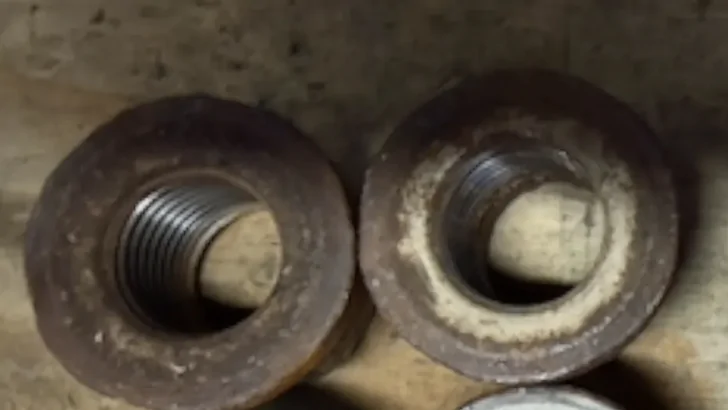

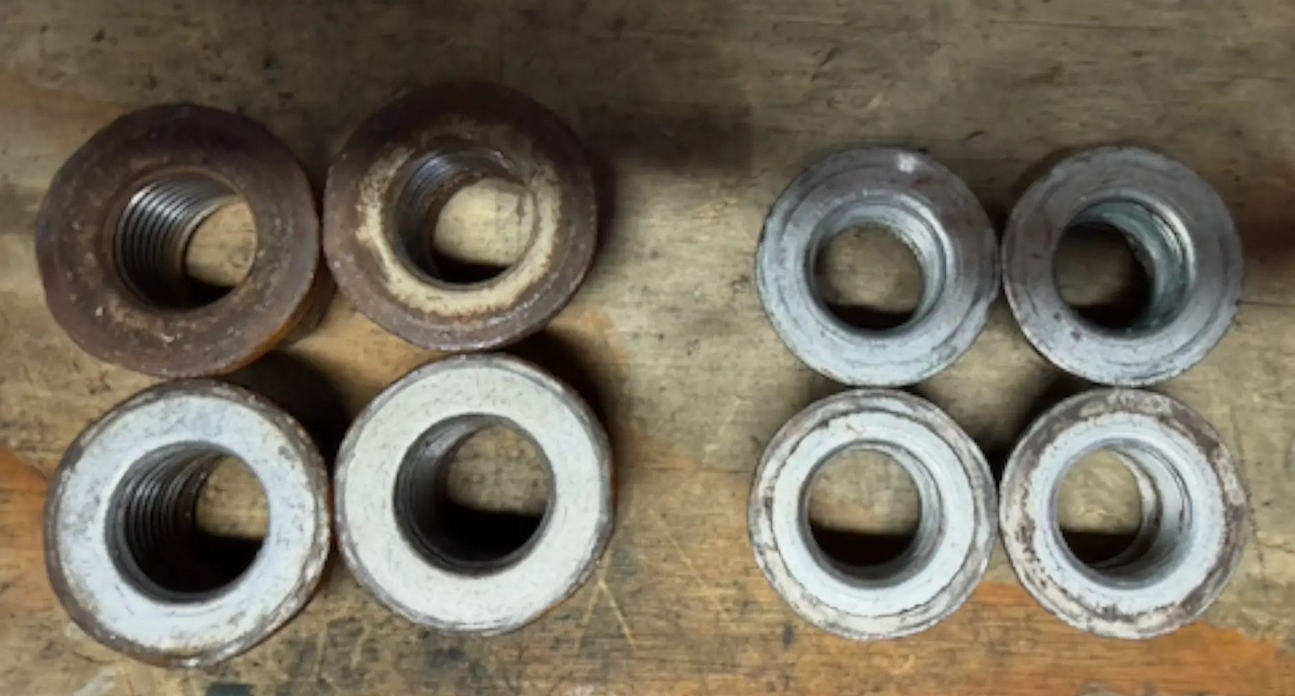

The source of the noise on both vehicles was loose and corroded axle nuts (also known as spline, spindle, or half-shaft nuts). The larger motors in these vehicles—front for the Lightning, rear for the Mach-E—put significant stress on these components.
Reference the attached file Axel nuts.png for a visual comparison:
Ford F-150 Lightning Stop/start/change direction clicks and tings - FIXED Axel nuts
  • Left side: Lightning nuts (heavy corrosion is visible on the top two).
  • Right side: Mach-E nuts (the bottom right pair are from the rear axle, which houses the more powerful motor).

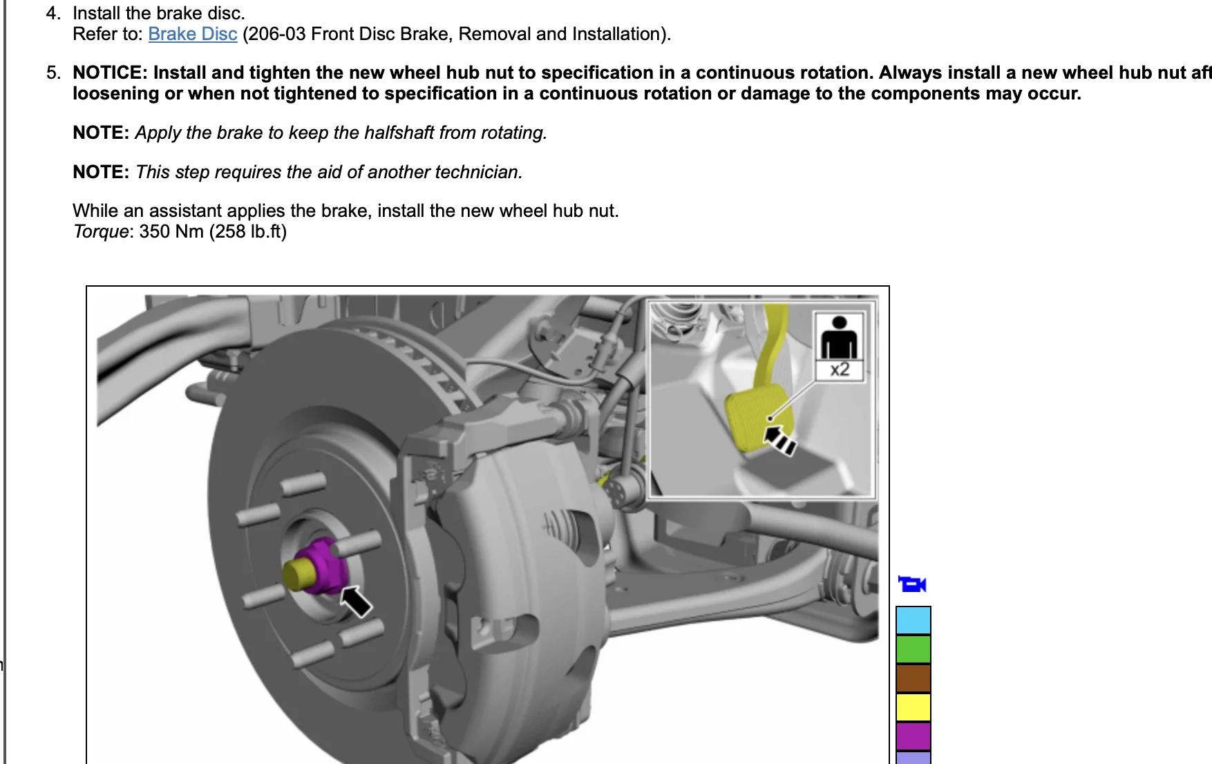

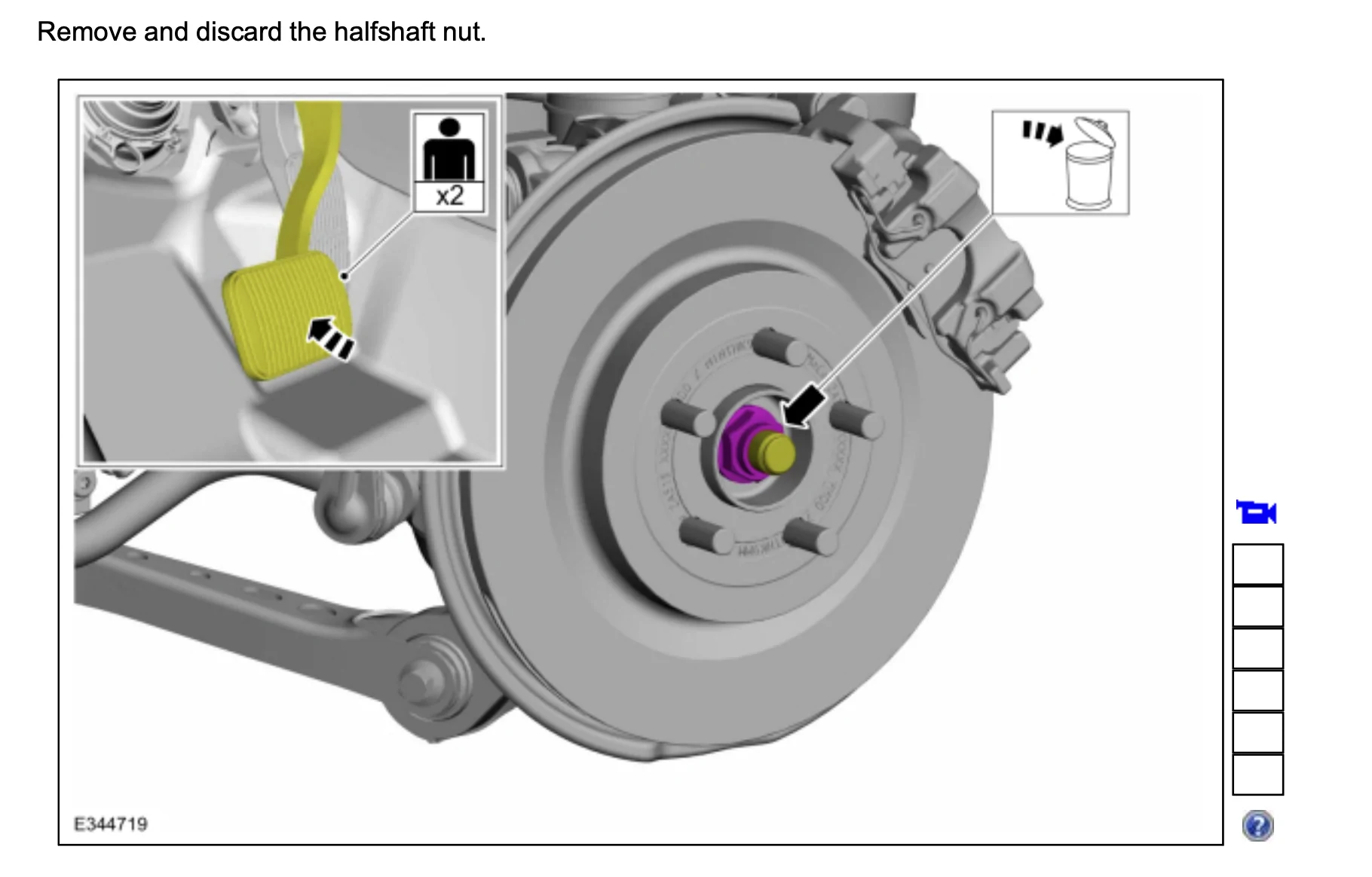

Following Ford's official service procedures (some details in the attached file Lightning Axel.png), the fix requires replacing the hardware.
  • Remove the old nuts and discard them.
  • Apply Loctite to the threads and install the new wheel hub nuts.
  • Critical step: Tighten the nuts using a torque wrench in one continuous rotation. Always install a new wheel hub nut after loosening or if not tightened to specification in a continuous rotation, otherwise damage to the components may occur. Do not use an impact gun; continuous rotation is required to generate the necessary friction. Applying the brake (for the front) and parking break for the rear will keep the halfshaft from rotating during this process.

  • 2023 Mustang Mach-E: 150 ft-lbs.
  • 2024 F-150 Lightning: 258 ft-lbs.
Ford F-150 Lightning Stop/start/change direction clicks and tings - FIXED Lightning Axel
(above is for the F-150 Lightning)

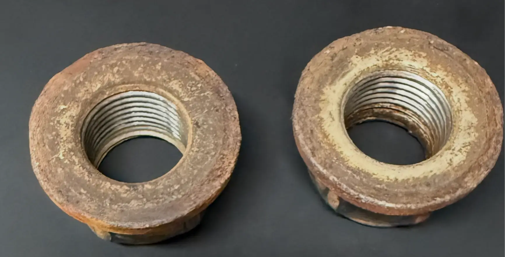

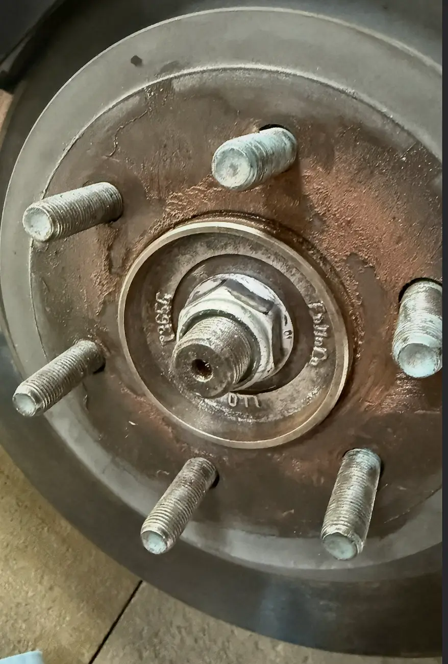

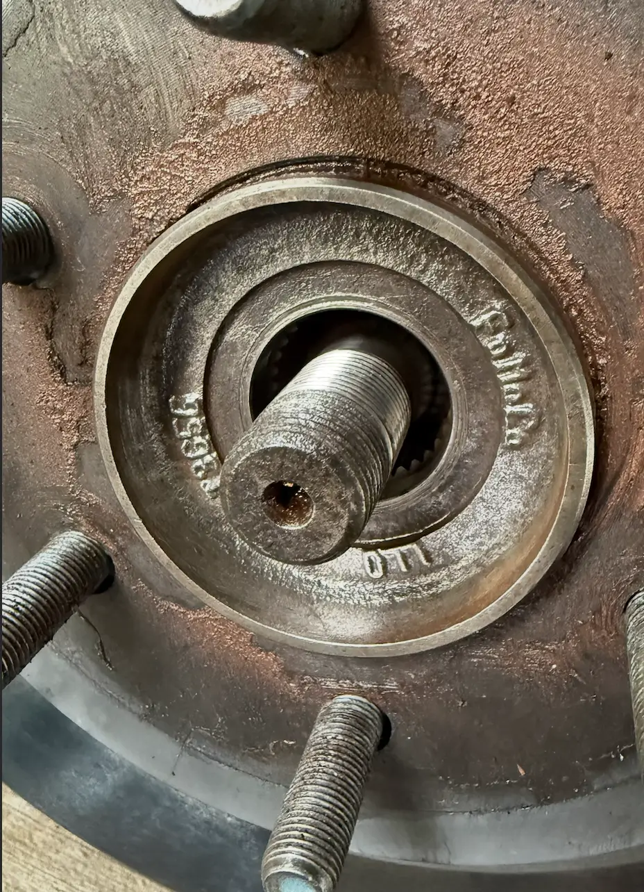

Here's a few more photos.
Ford F-150 Lightning Stop/start/change direction clicks and tings - FIXED Befor
These were the front axel nuts that I removed.

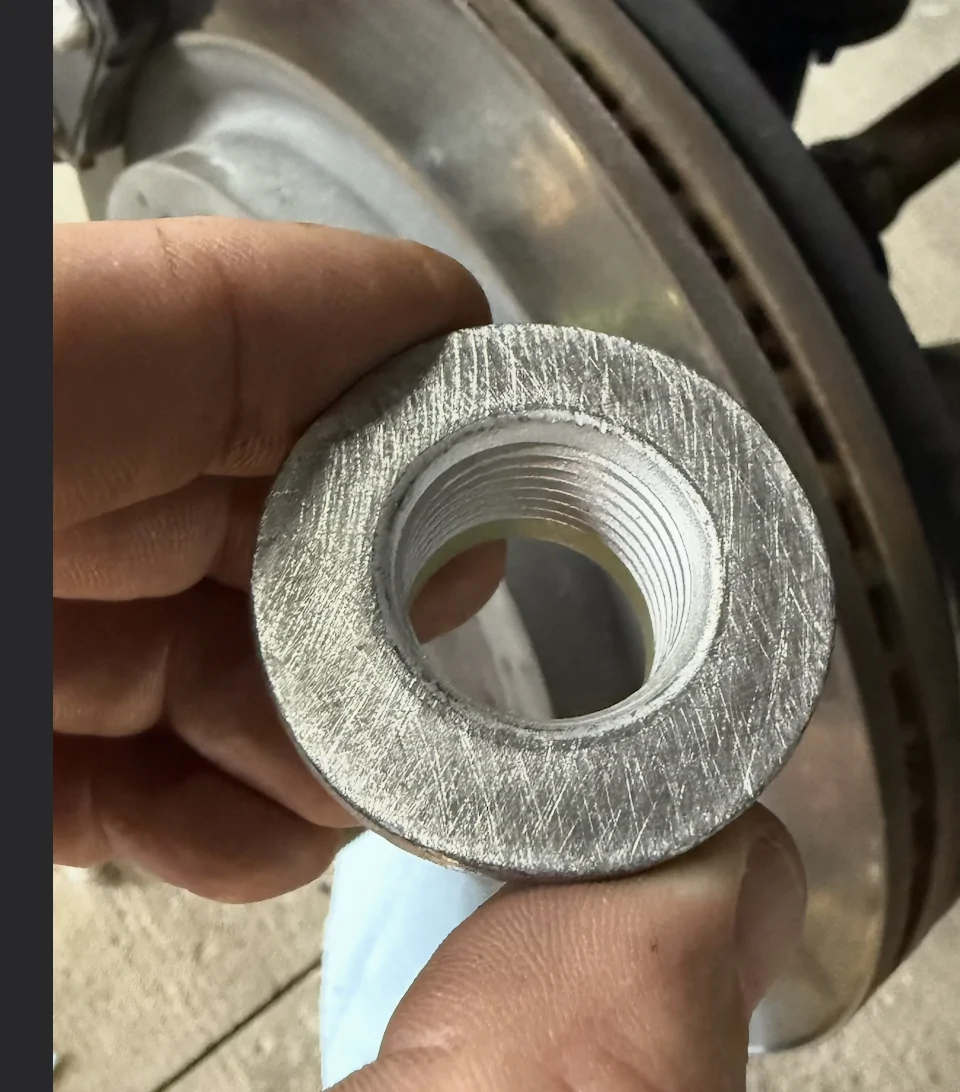

This was one that I replaced the old ones with. I sanded a cross hatch pattern into them for grip.
Ford F-150 Lightning Stop/start/change direction clicks and tings - FIXED After
Wheel hub cleaned up with a wire brush on a drill before axel nut install.
Ford F-150 Lightning Stop/start/change direction clicks and tings - FIXED Screenshot 2026-09-04 at 20.18.15
Here's an installed photo, I cleaned up the contact surface on the wheel hub too:
Ford F-150 Lightning Stop/start/change direction clicks and tings - FIXED Screenshot 2026-09-04 at 20.14.48

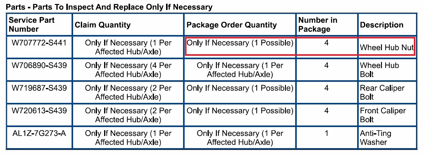

So I found steps 3 and 4 interesting...in Step 3 (1) if there is an 'anti-ting' washer installed already, then proceed to step 4 and reassemble the vehicle...apparently with no remedial action?
Also the table mentions replacing a number of parts including the wheel hub nut 'only if if necessary.'
Ford F-150 Lightning Stop/start/change direction clicks and tings - FIXED anti-ting tabl
So....what constitutes 'necessary' in this situation, and if the sound occurs and there is already an 'anti-ting' washer present, then what? Just reassemble and present the customer with a bill for the labor?
I guess I need to read "The Zen of F-150 Lightning Maintenance" when it is published...
Looking at the photo of mine, if they're corroded, or have any thread damage, I'm guessing?
Yes thread damage = signs of stress.
Some corrosion is inevitable I'd guess, though the top two on the left had a lot more than the others - were they front nuts?
Road salt etc is hard on metal parts.
If I was inspecting something and I saw rust, I'd replace it.
A good rinse now and then probably would help minimize the rust?

yes, the two most corroded ones were the front. I'm more concerned about corrosion on the face that makes contact with the wheel hub....and corrosion on the wheel hub. Cleaning those off should help. The left most is the driver side...it clicked and 'tinged' the most. Totally silent now.

Mach-e instructions are to remove and discard the nut vs. inspect and replace if needed. Same for the Lightning. I've also found various version of documentation about the torque specs for the nut -- Mach-e is always 150lbs - Lightning is 187 to 254lbs ... I went with 250.
