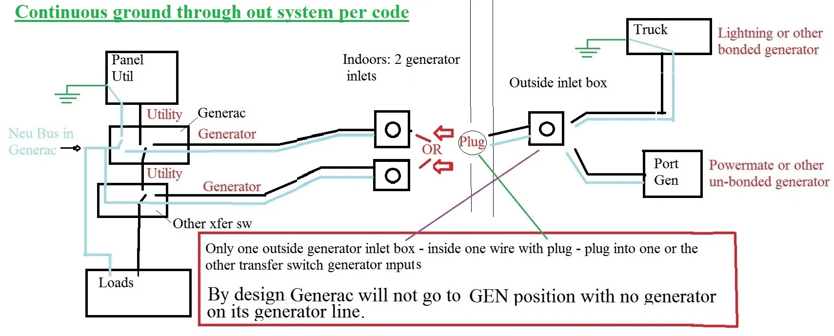

Agree with the comments about using the bed 240V 30A outlet (Pro Power On Board) and a $400 manual transfer switch Like the GENERAC 6853 or equivalent (will switch the neutral and hots).
I think I spent maybe $600 total including a 100ft 30A generator cord and inlet boxes, a bit of wire, and some more breakers for the GENERAC.
I already had a 10 circuit transfer switch (non-neutral switching) set up for my un-bonded generator, so I wired the GENERAC in a series-ish way so I didn't have to unwire/unmount the old transfer switch (simplified block diagram - continuous ground truck to panel per code).
Ford F-150 Lightning Storing Lower-Cost Energy in Your Lightning to Power Your Home and Returning Power Back to the Grid Block diag of 2 xfer sw hook up w inlet boxes
Powers 10 "emergency" circuits, e.g., gas furnace fan, refrigerator, coffee pot, microwave, computer, lights and TV/Internet.
Fully tested, but haven't needed it yet - no power outages of any duration this year here - maybe an ice storm will come this winter?
