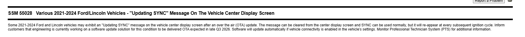

Just FYI: There is a known issue with this Sync update getting hung up and not installed. Ford released an SSM to dealers about it 3 days ago.
Thanks for this. I’m a current “victim”. Sync OTA is working, was told it installed, but this message is there.
Strange, the update installed today and appears to be functional as I have the new phone icon on the top row, but I don't have the symptoms in this SSM. Instead, if I look at the update screen, it says it did not install successfully.
Yea, the issue shows up differently for some people. The good thing is the update installed.

Side note: Software update screen still shows “Not Completed,” but the APIM OTA did install.
