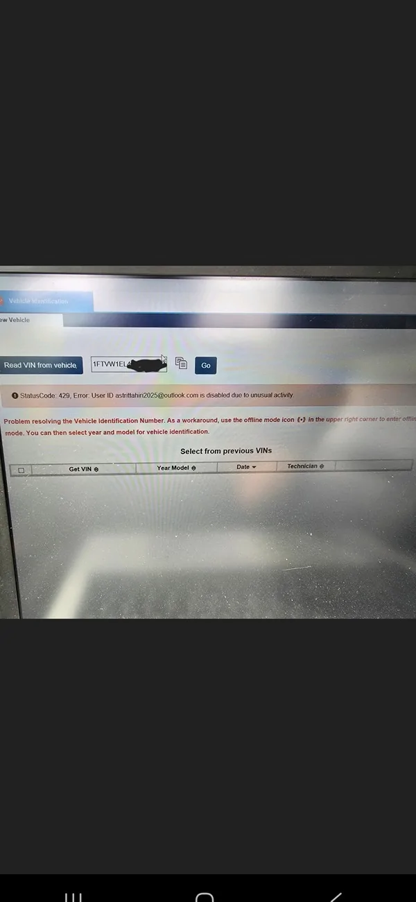

Unfortunately, Ford in Albania does not support the F-150 Lightning at all. I’ve taken the truck there only once, they charged me around $200, and nothing was fixed or resolved.
Regarding FDRS, I’ve tried multiple times. I purchased 1-day subscriptions three separate times, but Ford Europe keeps blocking my account as “suspicious.” They sell the subscriptions, take the payment, and then block access, so it becomes unusable.
This is not just my case — this is a permanent issue across the Western Balkans. Ford does not officially support the Lightning here, and accessing tools or backend services in Europe is extremely difficult or blocked.
Because of this, relying on official Ford support is unfortunately not a realistic option for me.

I'm quite shocked and pleasantly surprised that Ford Europe offered any recommendations to your issue. As far as FDRS, couldn't you just use a VPN to a supported country. It's quite annoying to be blocked, but there are legitimate concerns regarding export controls that they must enforce.
I would like to further clarify the situation based on the official email from IOEUFSI, which I have attached for reference.
In that email, it is clearly stated that the use of a VPN is not permitted. The FDRS system is able to detect VPN usage automatically, and once detected, the account or access is immediately blocked.
However, I would like to emphasize that this issue is not related only to VPN usage.
I have also attempted to access FDRS from other European countries that are officially listed as supported on the FDRS/MotorcraftService website, without using any VPN at all. Despite this, the result is the same — the system still blocks access immediately. This confirms that this is a broader European/regional issue, not a user-side configuration problem.
Additionally, I have experienced cases where I:
- Purchased an official FDRS subscription
- Attempted to use it without any VPN
- Still had the access blocked immediately
In such cases, the company selling the FDRS subscription did issue a refund, acknowledging that the system blocked access even without VPN usage.
However, in cases where a VPN was used, the policy is different:
- The system blocks access automatically
- No refund is provided, regardless of the outcome
This situation leaves users in regions like mine without a viable solution, as Ford Europe does not appear to actively address or resolve this issue, despite FDRS subscriptions being officially sold for Europe.
