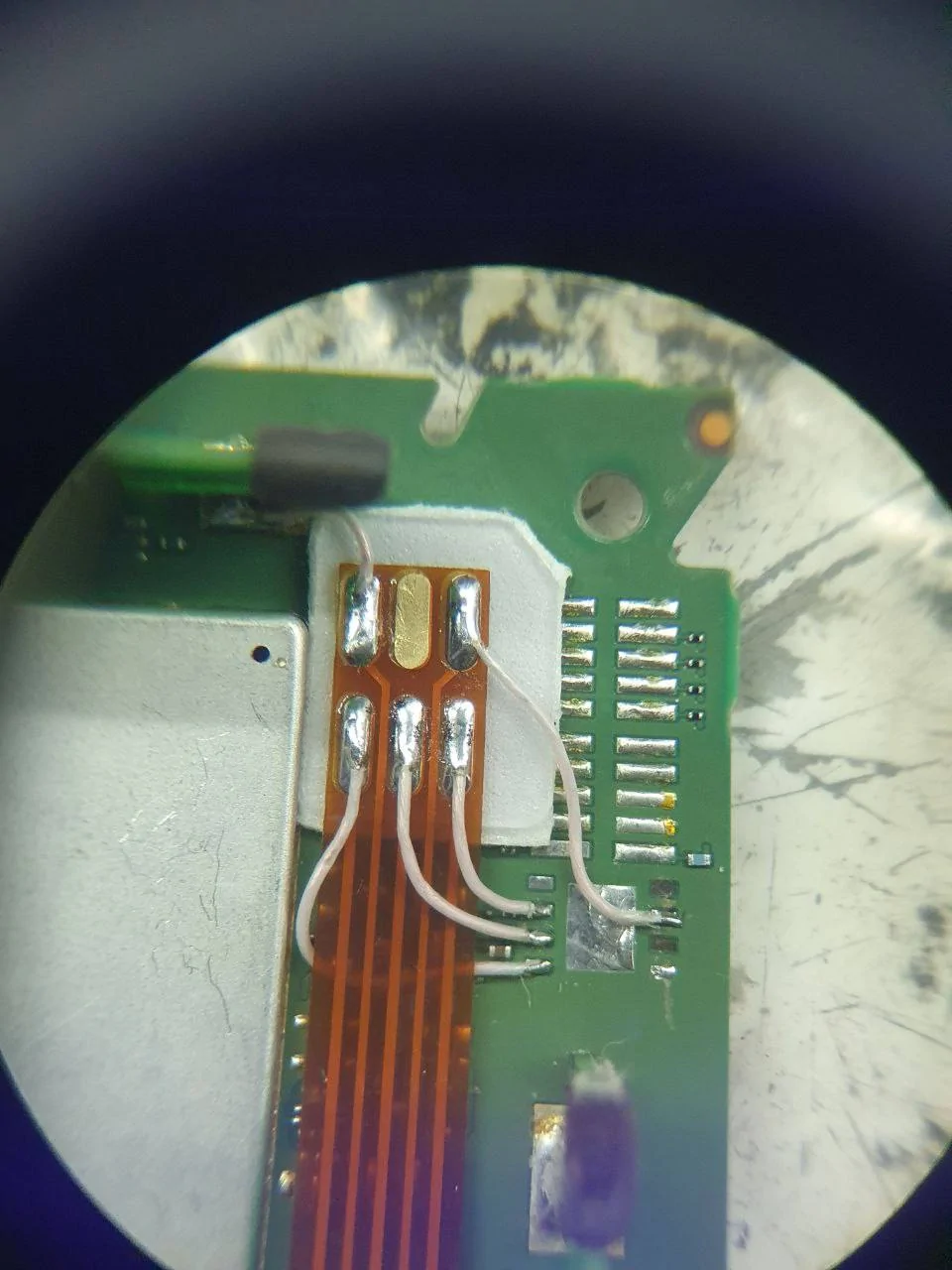

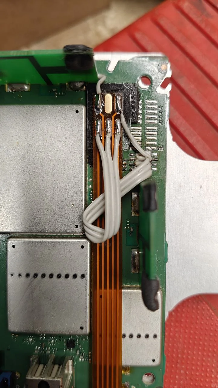

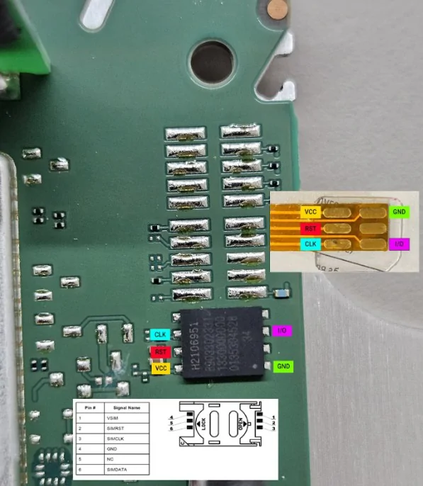

If your EU TCU will not work, you can use method with replacing esim to Sim for your needs with OTA, it's easy, you need sim adapter (1$ on aliexpress), sim card, eject esim (the most hardest part), solder new sim adapter. It's not cost 100+$ which some clowns took for this job, so you can go to the local workers who repairs mobile phones or laptops and asked about this replacement
Esim must be ejected, on photos showed which pins used
Pin should be removed from Sim, and you need have internet package (traffic) on your Sim in tcu

Nope, no any programming or other stuff after sim replacement (if we talking about factory tcu from USA with replaced sim). But I recommend to try replace tcu from EU vehicle, if it doesn't help, then return back your factory TCU and replace Sim.
Adapter https://s.click.aliexpress.com/e/_EQnGne8
And a bit more photos with replaced sim
Not my work)
And some electricans used ground from another place on the board, but it doesn't matter using it from place with my wiring diagram or from those which on photos below
