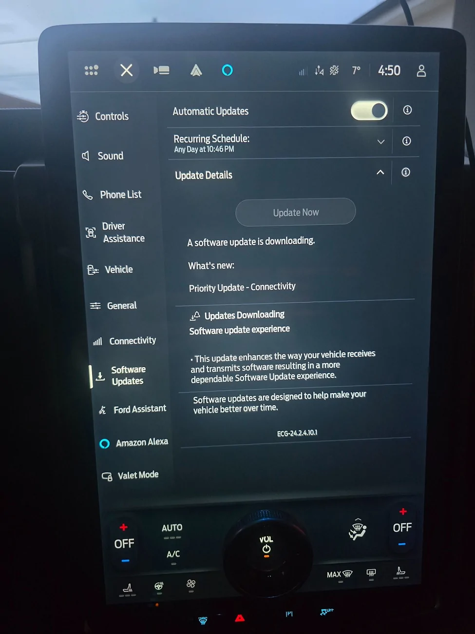

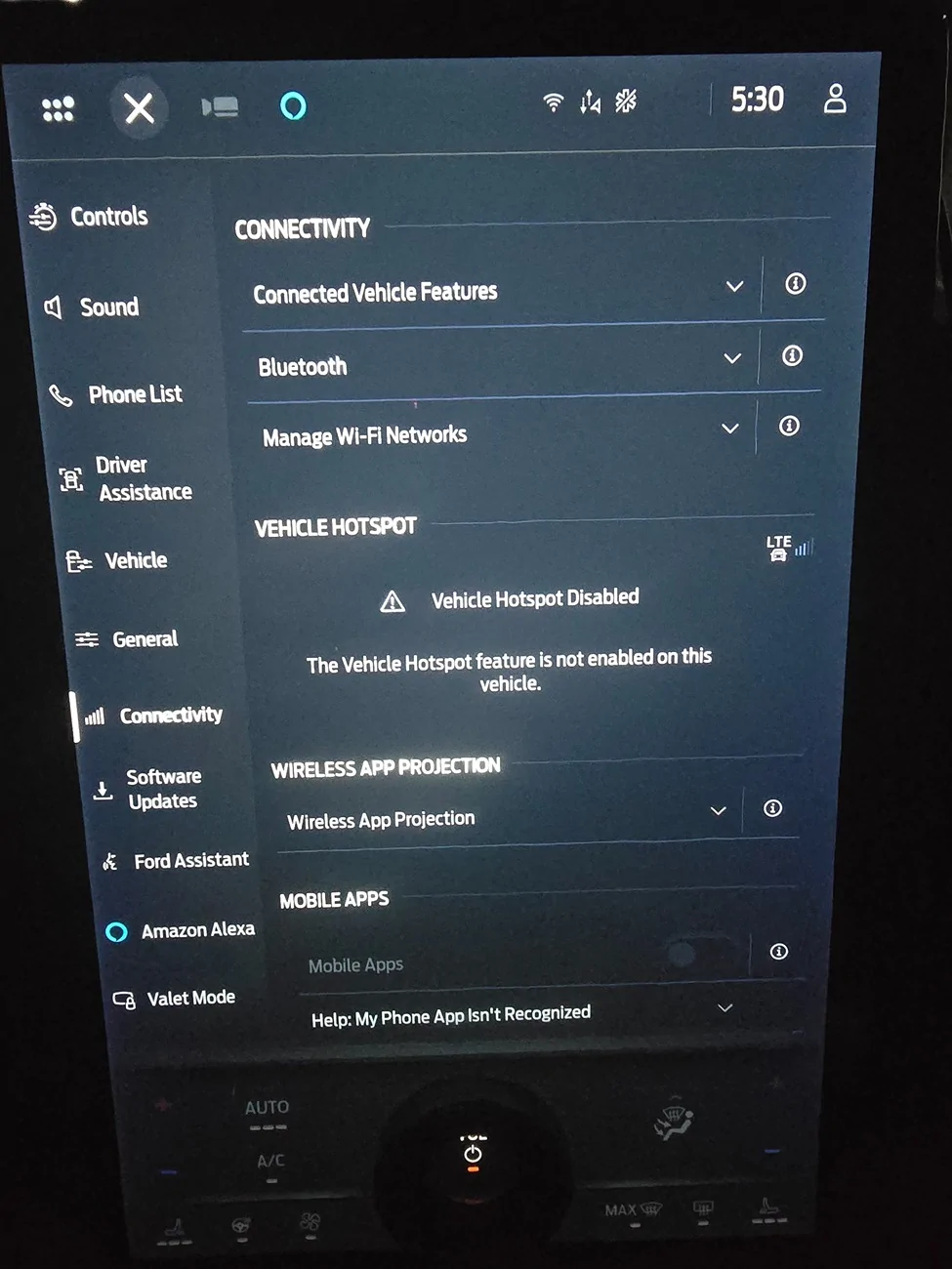

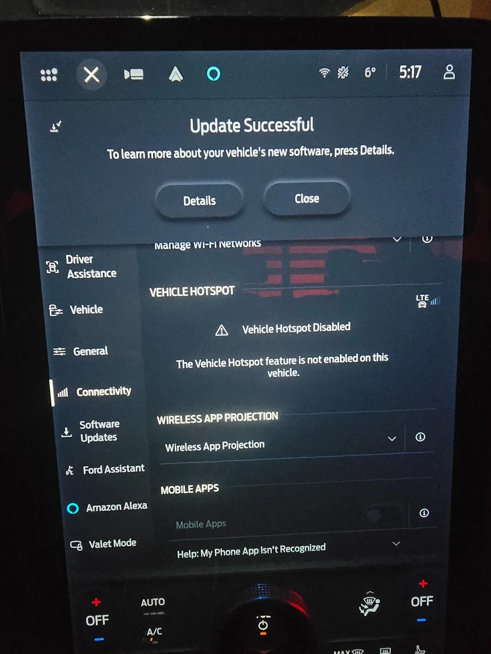

I would like to share the final result and sincerely thank everyone.
I removed the eSIM and installed a physical SIM card in the SIM slot, and without making any system or configuration changes, the vehicle immediately gained full and stable LTE connectivity.
In addition, after about 6 hours with active LTE, the vehicle started receiving software updates, which it had not received since September 2024.
This clearly shows how important connectivity was and how helpful your advice and experience have been.
I want to thank everyone from the bottom of my heart, especially those who spent their time and effort helping me troubleshoot the issue with my vehicle.
Without your support, this would not have been possible.
Thank you all once again
