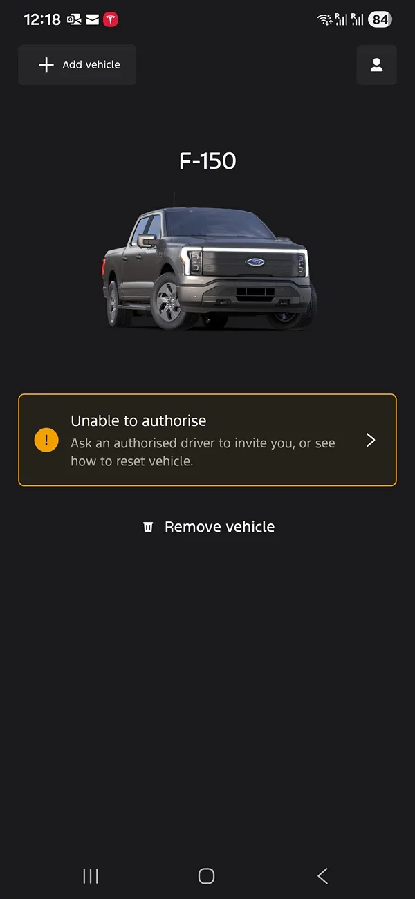

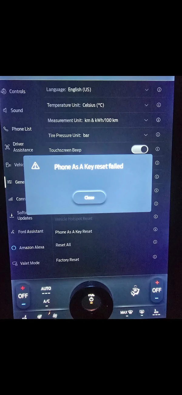

That’s exactly why this situation is confusing.
Normally, a FordPass Connect reset / SYNC master reset should remove all previous users and allow the new owner to add the vehicle to their own FordPass account. In my case, this did not happen.
Even after multiple master resets.
The previous owner is still linked on the backend
I still cannot add the vehicle to my FordPass account
