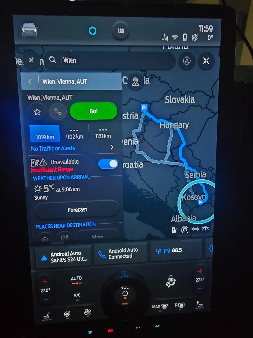

This is a final update regarding the APIM replacement. I installed the European APIM unit that I purchased in the UK from a Ford Ranger.
After installation and turning on the screen, the display appeared distorted because the Ford Ranger uses a smaller screen. The only thing I needed to do was connect with FORScan, go into APIM AsBuilt (Edge), and select Load Factory Settings. After that, the screen returned to normal.
The navigation is now working perfectly and everything is fully completed.
Thank you all for your support
