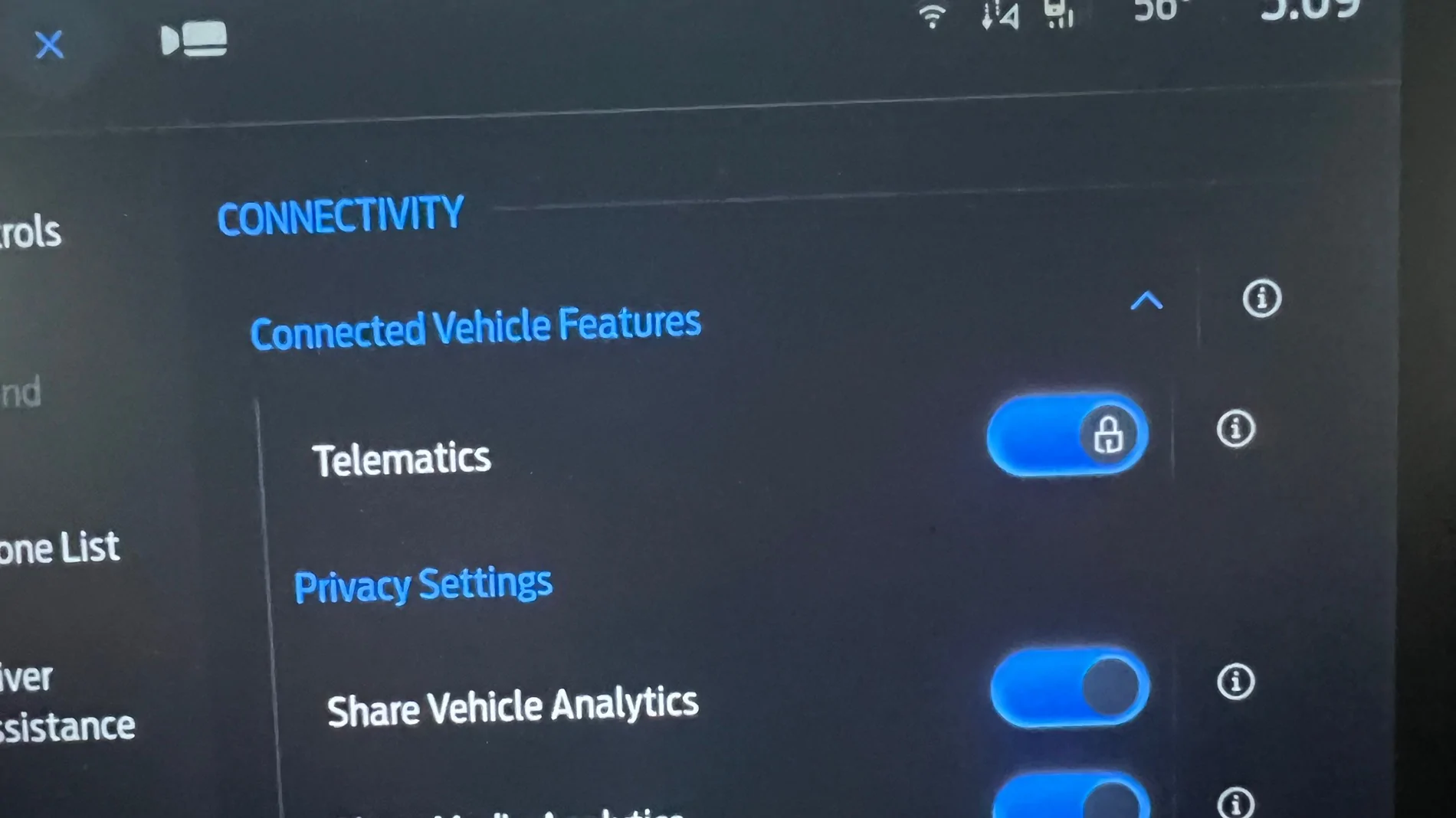

Telematics locked - does this mean my ‘24 Flash is enrolled as a fleet vehicle?

Could explain why its not getting any updates.
Ford F-150 Lightning Telematics locked - does this mean my ‘24 Flash is enrolled as a fleet vehicle? IMG_1286

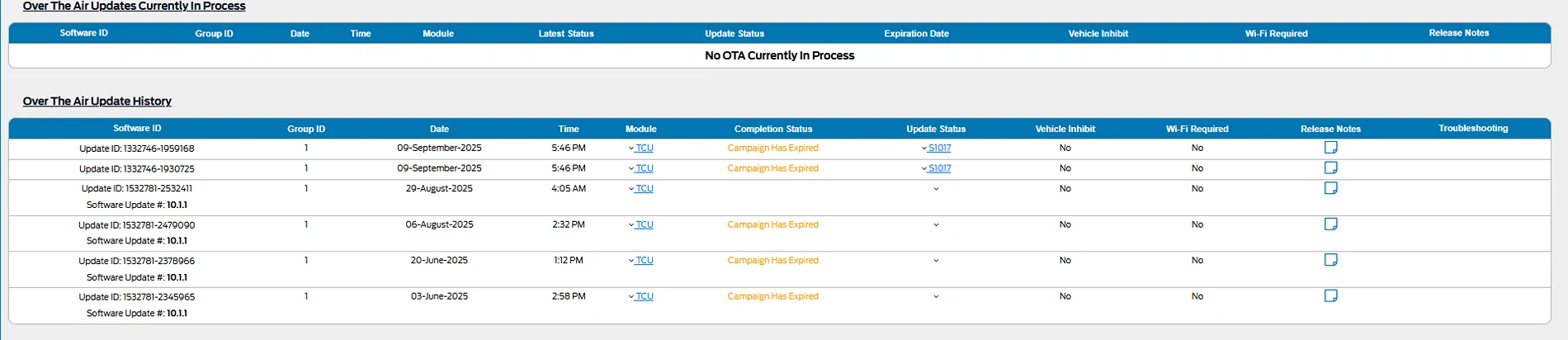

Very possible. You have been sent a TCU update many times and it fails because your truck is not pinging the server back to accept it.
Ford F-150 Lightning Telematics locked - does this mean my ‘24 Flash is enrolled as a fleet vehicle? 1763417942319-yt
In PTS, your modem shows as both retail and fleet authorized which is not normal. This could be preventing OTA's.
Ford F-150 Lightning Telematics locked - does this mean my ‘24 Flash is enrolled as a fleet vehicle? 1763418006535-zl

If the dealer or fordpass cant resolve it we can with Forscan. Fordpass should be able to send the reconfig remotely though.

Will a factory reset unenroll a lightning out of Fleet mode?
If so, what will that break?
No.. Factory reset will deactivate ford pass but it wont release the fleet lock
Its a configuration issue. Fordpass, Dealer or I can help you with forscan.
I will try Forscan on the morrow.

message me your vin and ill send you what to change if you have forscan

This appears to be very specific, detailed info about a vehicle…. is it from my truck? If so, how did you get it? 😮 Color me amazed 😮
It is from your truck. You sent me your VIN some time ago to look at something else.

FORScan extended license installed and Fleet lock removed - now I wait for updates to hopefully come.
Many thanks to Jesse-Infotainment and rugedraw for their help and Lightning fast responses (pun intended)
This forum is a very valuable resource.
