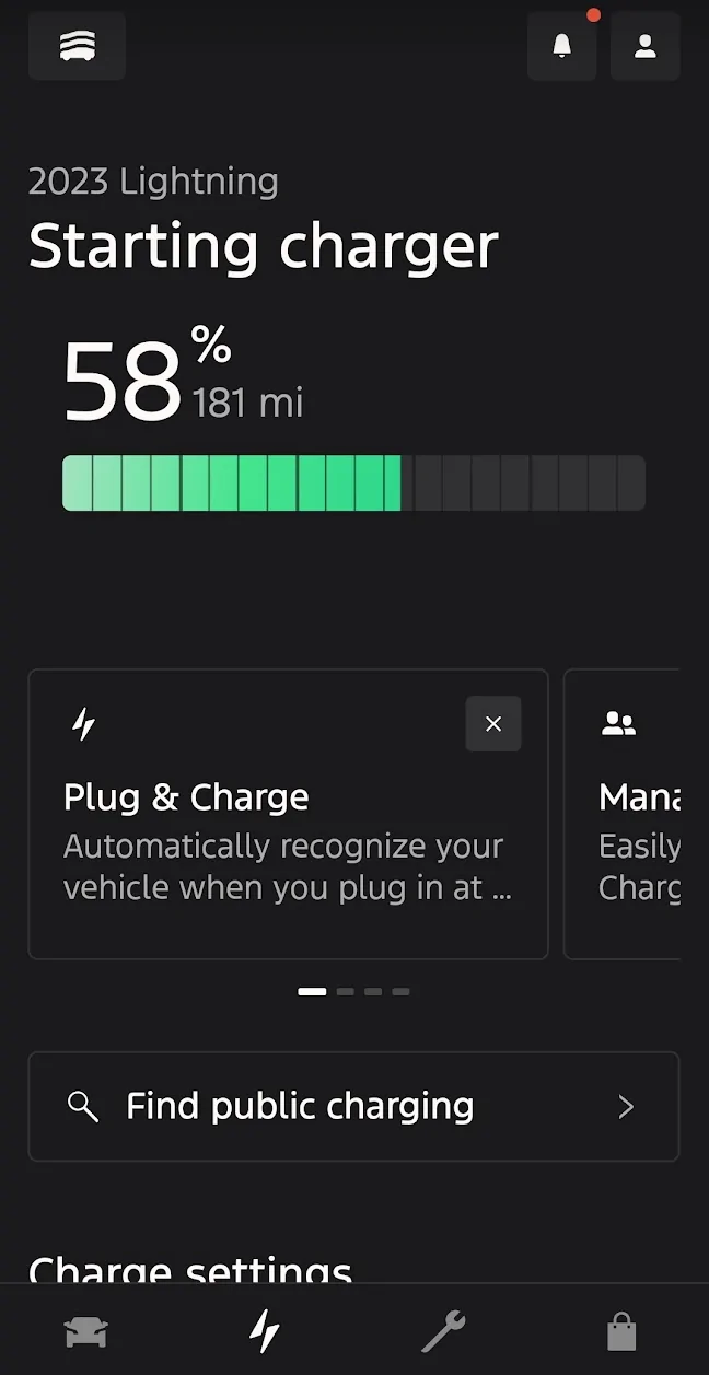

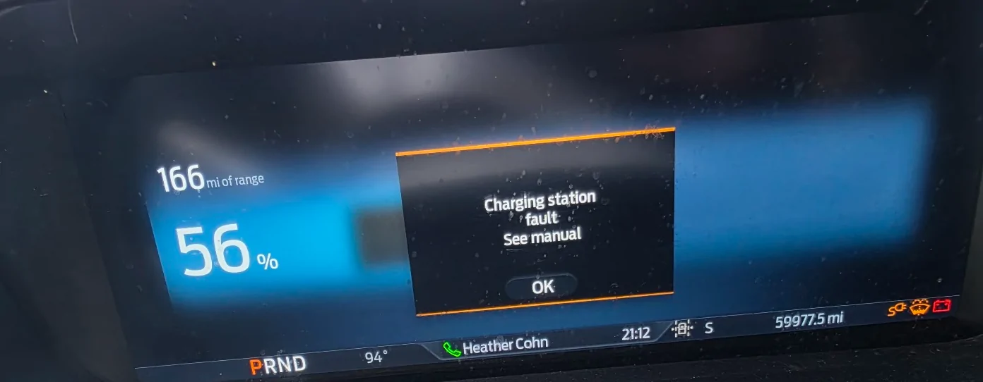

I was unable to use the Gen 3 DC Telsa supercharging at two locations on July 6th at the following locations: Buc-ee's at Roberson, AL and The Wharf at Orange Beach, AL. I was able to charge at both these locations a month earlier. I keep getting the "Starting charger" in the Ford App (see below) and then the "Charging station fault, See manual" (see below)

I got the red blinking ring on the lights next to the Lightning charging port which is an indicator that there is an issue with the charging station. Since I was out of town, home charging was not available. Fortunately, I was able to DC charge at a ChargePoint (which only goes up to 98 Kw) at a Cumberland Farms convenience store in Orange Beach, AL.
