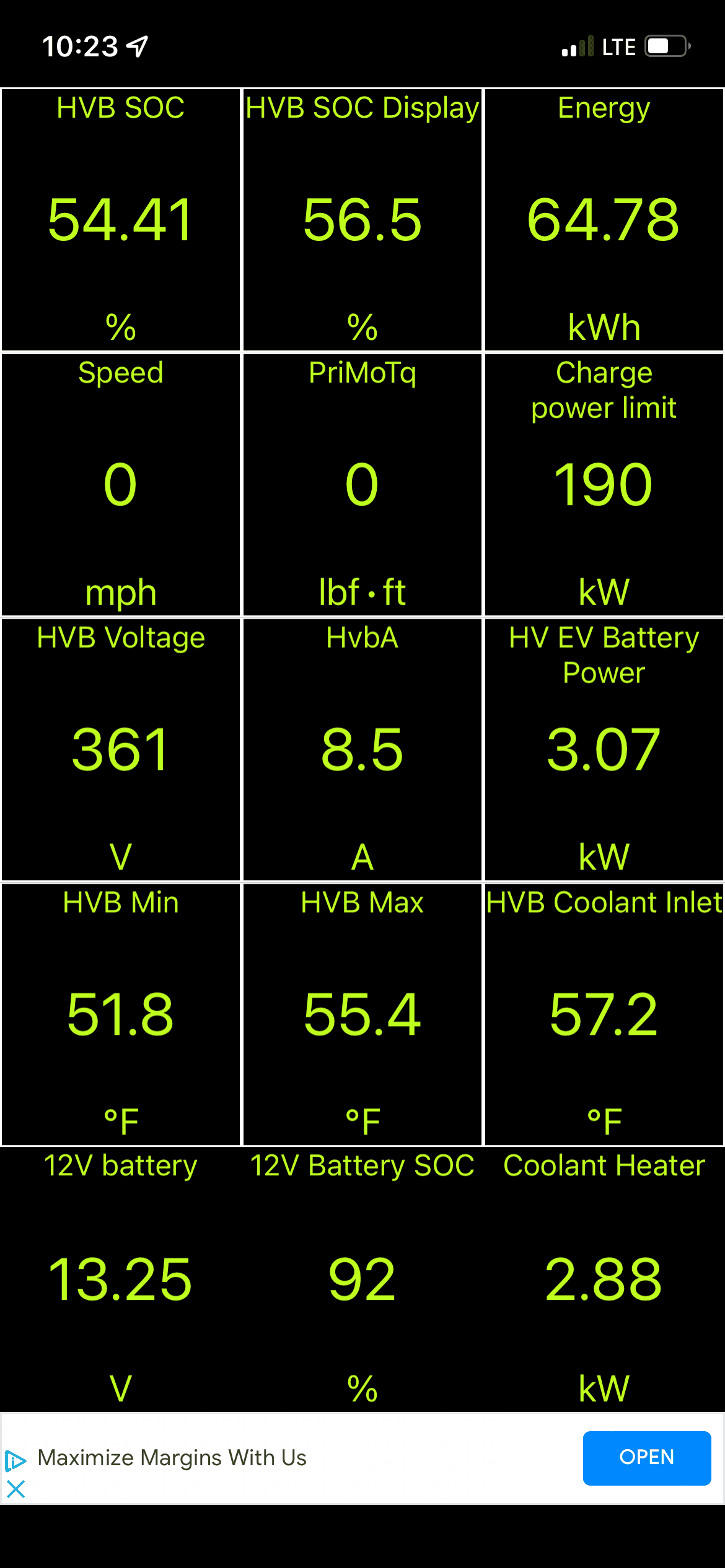

I can get actual values using an OBD II Bluetooth dongle and the Car Scanner app. Right now, my battery temp gauge on the dash says half. These temperature values are quite close to ambient.
Ford F-150 Lightning Temperature gauges dummy or real 11C682C0-23A8-4515-BE0D-7AEA8D574479
