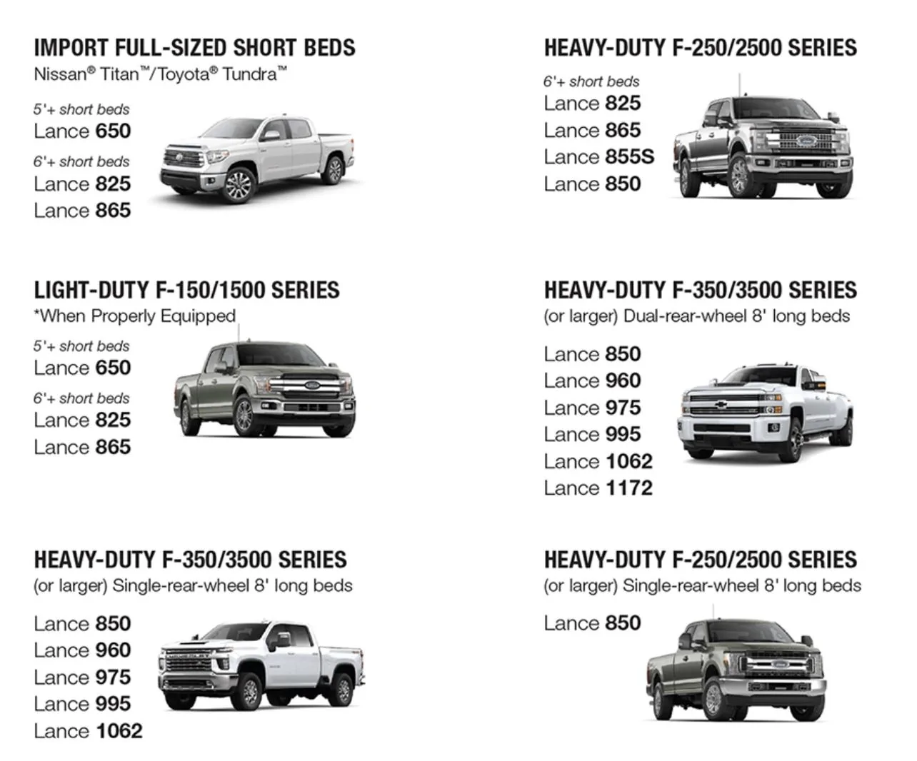

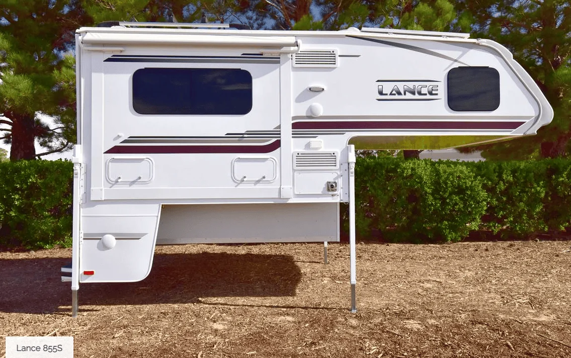

The lightest Lance slide-in has a dry weight of 1700 pounds so the pictured camper likely doesn't work with the lightning's 2000 pound max payload (or less with the ER battery and some options).

The 855s would be too much for the Lightning. Looks like the only camper Lance makes for <6ft beds is the 650.

I read somewhere that ford actually stated that the lightning was not designed to carry the slide-in truck bed campers
