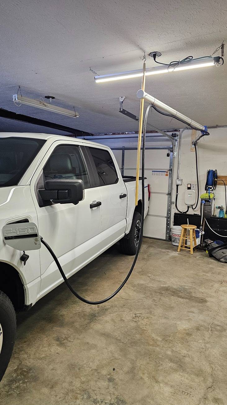

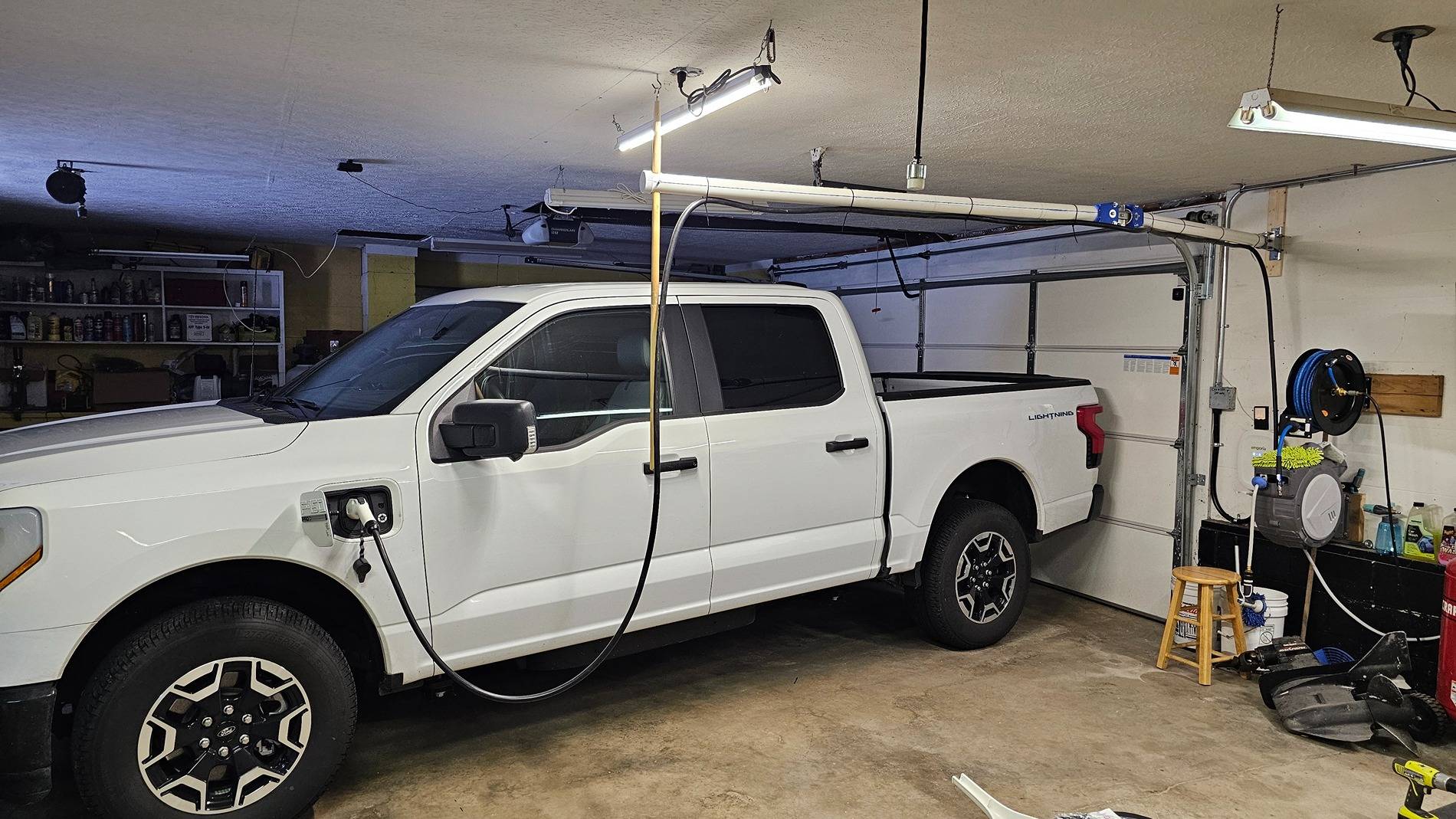

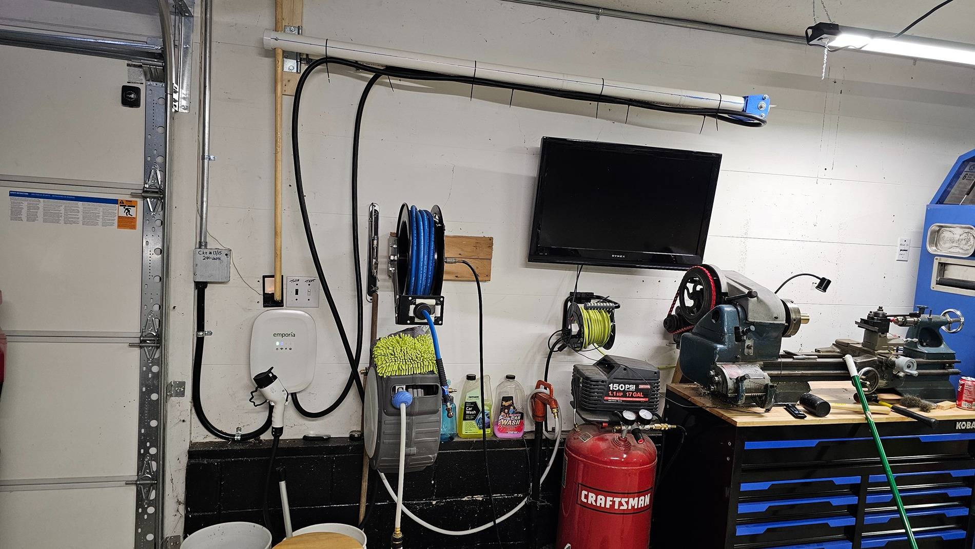

I was tired of rolling the dirty cable up every day so I figured I would fix that. Unfortunately parking does vary in the garage so a simple "curtain rod" style system was less than desired. Instead using Home Depot I hacked together a 14 foot, almost a boom arm, system instead.
It's 80% finished, ugly, dirty, and still in need of paint, but here it is. Sadly the pvc and pivots are not quite strong enough to prevent bowing, so instead of a fully articulated free standing arm you have a handle that you hook to pre-arrainged spots on the ceiling. It will hold it's own weight, it's just not as strong as you want. I still need to add a guide wire to the first segment too, just for some extra support.
I'm probably less than $100 into it, and there is a fair bit of extra bits laying around.

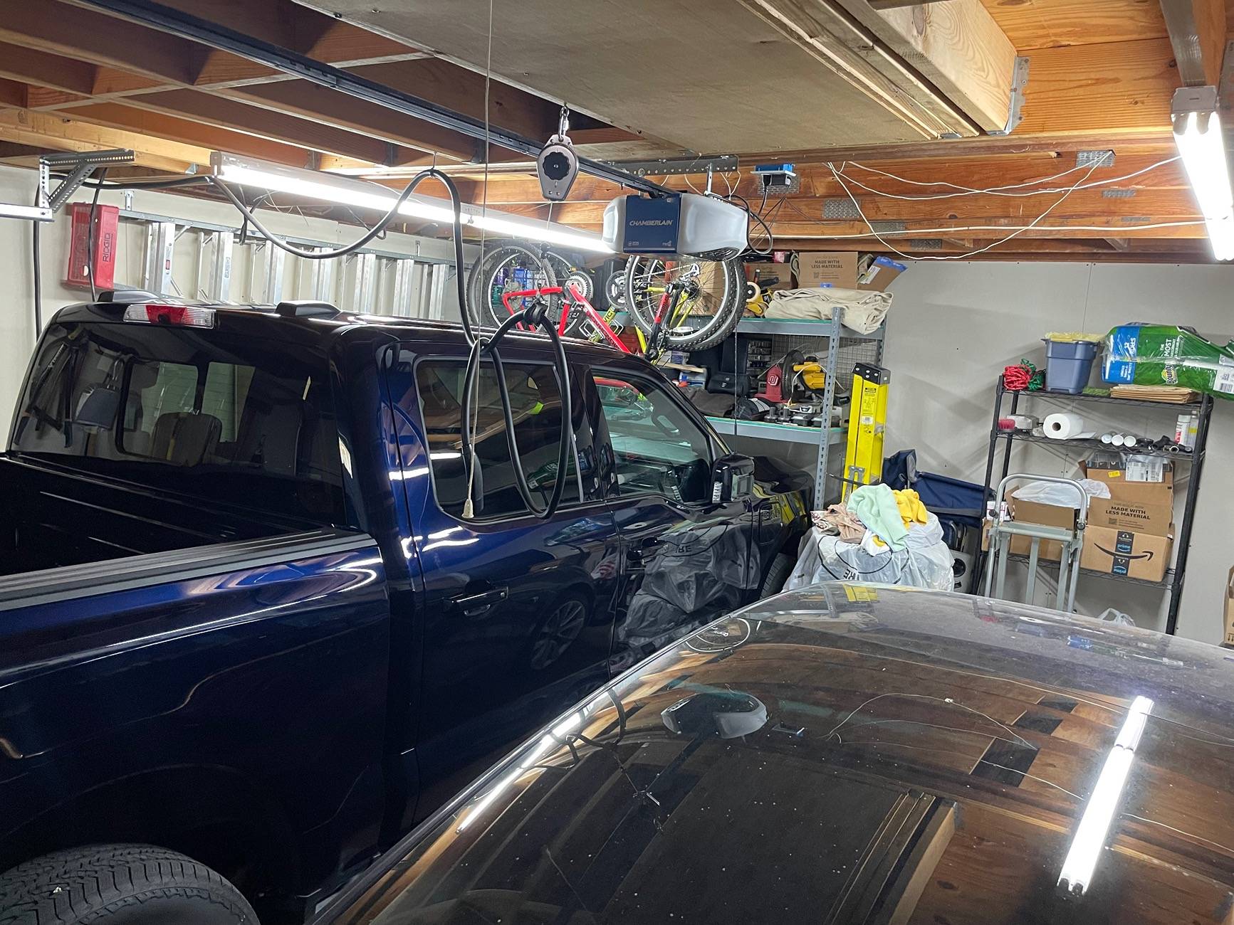

We have 2 EV's and the WC is on the left side of the garage. I used simple screw hooks to hold the cable about 8' across the ceiling. Then I bought a "Tool retractor" to hang the end of the cable from. Reach up and pull it down to plug in, or unplug and let it retract up.
Good Tool retractors are expensive. I went with a cheaper one from Amazon. It works for what it is needed for.
Found a picture - there is a lot going on behind the cable, but you can follow it across from the wall and where it hangs.

I'm intrigued and now thinking up some ideas of my own.
This is 2" pvc with a gate hinge at the base and door hinges in the middle. 2 1/4 exhaust clamps to hold it at the base. There is a 1x3 board trimmed and shoved down the center of the pipe to give it more rigidity.
It is really close to being free floating and 3" pvc might be enough to give it the torsional rigidity needed. Unfortunatly the hinges let in a lot of flex, especially the "heavy duty" gate hinge with the plastic bushings. I was going to try commercial hinges with bearings but instead decided just to put hooks on the ceiling and "hang" the end where I need it. I'll 3d print a hook for the J1772 and put it on the end so you can stow it all with one hand.

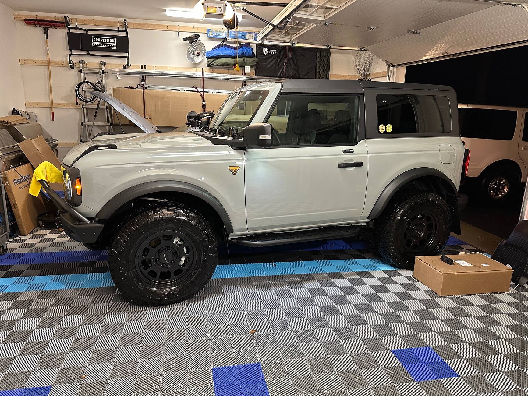

I should do something similar, we are using one Tesla charger for the Y and Lightning. I was thinking about using a pair of weldable hinges and 1x2” square tubing. Right now plugging in the Tesla means the cable goes on the floor behind the car, the Lightning runs on the floor in a similar position to how yours was. I have Racedeck flooring in the garage, so the cable doesn’t get dirty. I snapped this pic Last night after washing the Bronco, the charger is on the wall to the right between the two garage doors.
