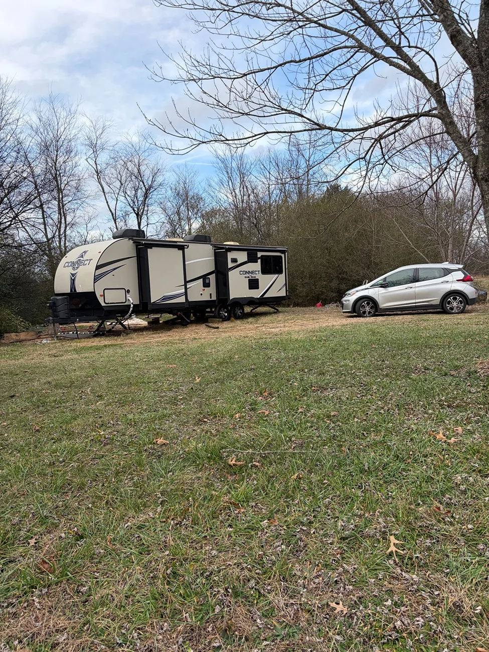

I towed basically this exact trailer length(35') and weight(7,600lbs) with my '22 PRO SR Max Tow 98kwh Battery pack back in late December, towing it 203 miles from the dealer to my Son's property.
While mostly flattish from Buford GA across the state and into Alabama, to north of Huntsville, there ARE a few substantial terrain changes, specifically coming down to the Tennessee River, and/or up from it... I averaged, with a conservative speed, 1.2mi/KWH, during the journey.
More importantly, and without any need for any additional towing hardware, I hardly knew the trailer was behind me. If you use Tow/Haul MODE, you'll have some Regeneration assistance, although you might also use SPORT Mode, for even more, if you wish... either way, it's a dream to tow a trailer or camper.
I then towed, in the REVERSE direction, his 'old' trailer, as a trade-in back to the dealer... although a shorter camper, with slightly less weight. I averaged a similar rate on the return, in good weather, with little wind or other conditions, for 203 miles. The weight and length is not really as much of a towing issue, as the aero(front height and squareness of the trailer type) is for the headwind.
I also recently towed my V-Nose enclosed utility trailer, 12-13', loaded at probably 3,000lbs, over to our new place, 75 miles. I averaged, at speed, 1.7mi/KWH.
I averaged on the return, unloaded, 1.8mi/KWH, at probably 1800lbs.
It's more about the aero versus the weight.
and, YES, to your point, planning a towing trip is important, and you can't just 'assume' to use the full 100% of the battery before you need to charge - God has not yet provided us a DCFastCharger at the last mile of our range... yet. Sometimes your best option might be at 75 miles, leaving you to charge up to 80% for your next leg, which, may also not have an option near your distance, either. It's all about planning, and, mainly, probably stopping more often versus trying to 'stretch it out' to the next one. The pucker effect does not make for pleasurable driving experiences.
I was blessed to have many options along my 203 miles route, but that's after coming from EV charging route planning over many years, and with 75 mile range Nissan LEAFS for several years in the early times. We are blessed now to have so many options, closer, and faster.
